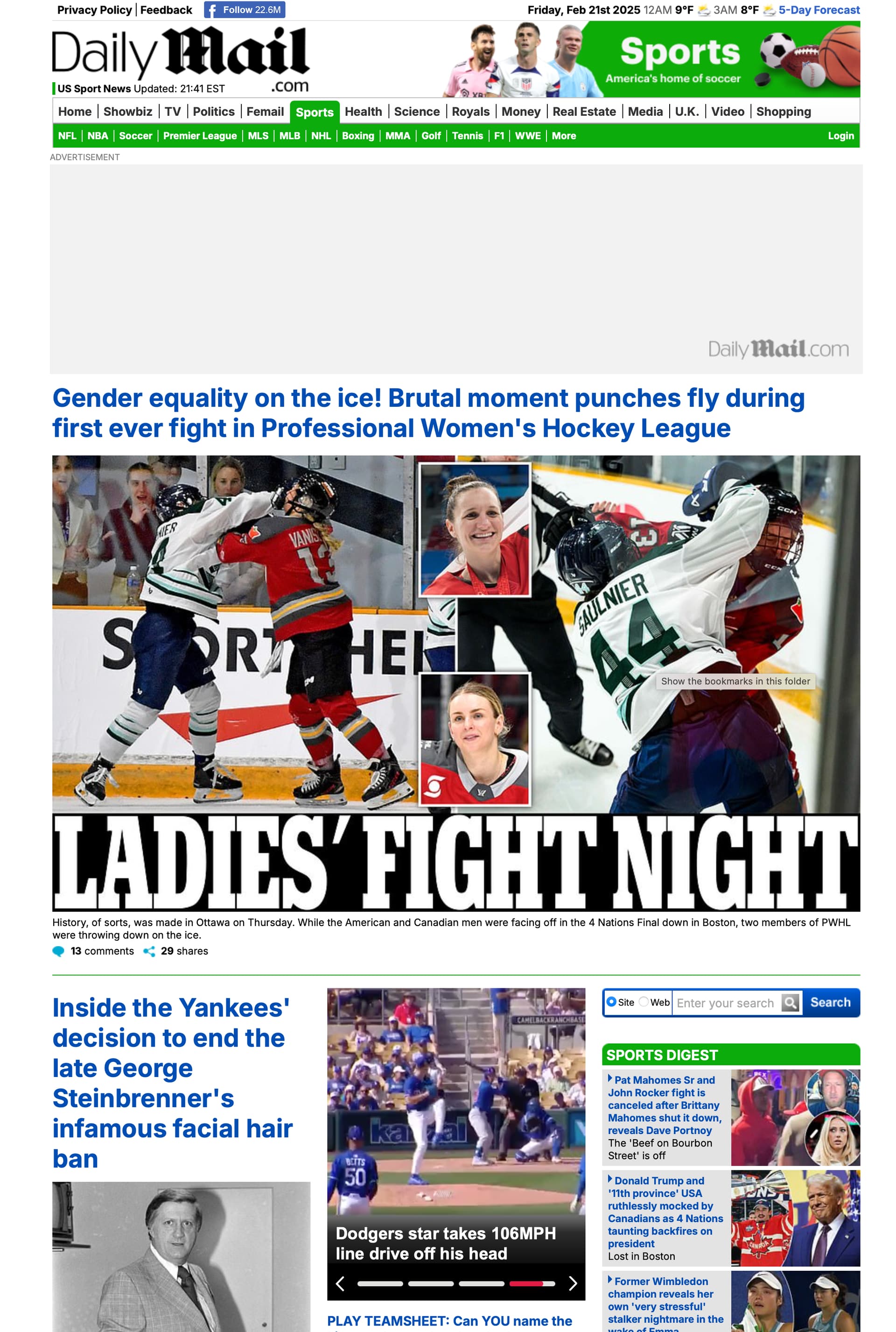

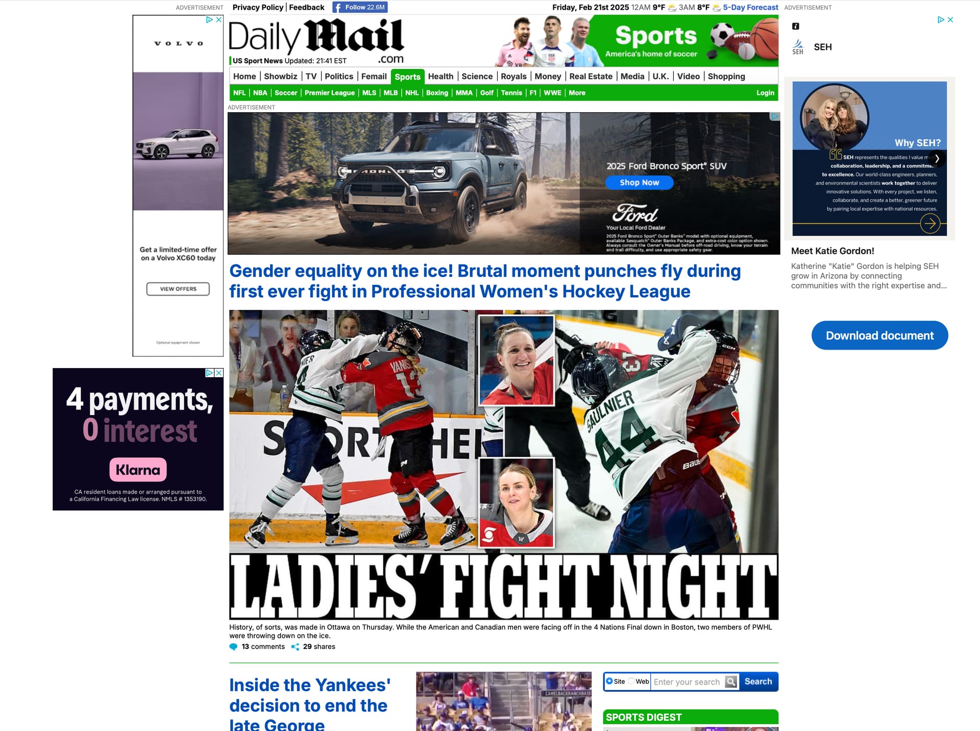

Here are screen shots just taken of the daily mail sports page.
With Pi-hole active:
With Pi-hole disabled - no blocking:
