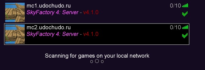

I'm try to check my srv record by nslookup and in game client. Client show me this, two different adress and same server

I'm not noob in installing minecraft's servers, i'm noob in Pi-hole DNS configure. So, this problem in Pi-Hole FTL Dns server, i understand it correctly, right ?
What i want to do. I want make next thing
When player from local network connect to mc1.udochudo.ru his client will got 192.168.212.104:25565
When player trying connect to mc2.udochudo.ru his clietn will got 192.168.212.104:25566
But if we look on screen, When client ask server by mc1 and mc2 it will got only one DNS response, but if we check it with nslookup it will show what mc1 response port 25565 and mc2 response port 25566. And now i'm confuse, because if i do this from Yandex.DNS Manager and i'm add SRV records then i will got or Empty response, or Port 25565 or Port 25566 but client will send Error "Unknown host"
This domain exist in both network, in my Local and in External, but i want make loopback, when my PC try go to mc1.udochudo.ru it must got my local IP with specific port, but when computer from internet try ask mc1.udochudo.ru it must got my real IP adress with same specific port

Minecraft Client send packet to mc1 OR mc2 and PiHole-FTL resolve 192.168.212.104:25565 on BOTH MC1 and MC2 subdomain
UPD.
Example in Client
https://imgur.com/a/kw2j0tV SkyFactory runing on port 25565 Milona's Family runing on port 25566
