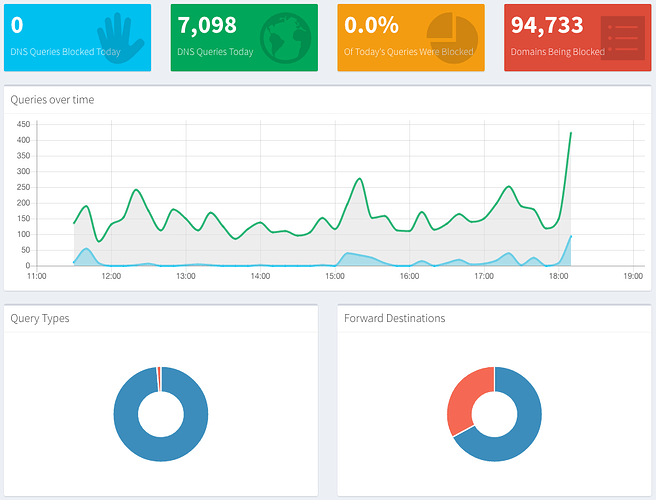

Update.
I've manually added the /etc/pihole/adlists.default file from Github repo.
And now the web interface tells me I have 94,733 domain blocked…
Still testing!
Seems to work but no sitw has been blocked (and I've visited on pourpose a couple of p0rn websites with ads… that have loaded :frowning:
