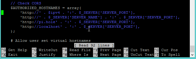

Investigated some more, found this in the auth.php file:
root@DiskStation:/# grep -rnw '/' -e "Failed Host Check"
/var/www/html/admin/php/auth.php:37: log_and_die("Failed Host Check: " . $_SERVER['HTTP_HOST'] .' vs '. join(', ', $AUTHORIZED_HOSTNAMES));
The code that generates the $AUTORIZED_HOSTNAMES array does not account for installations that deviate from the standard web port of your browser when checking for host header spoofing. And good luck getting port 80 unbound on your Synology. Because i first tried for an hour to get Synology unbound web server from port 80, and it apparently was easier to fix the source code.
Here is the fix:
File: /var/www/html/admin/php/auth.php
// Check CORS
$AUTHORIZED_HOSTNAMES = array(
    'http://' . $ipv4 . ':' . $_SERVER['SERVER_PORT'],
    'http://' . $_SERVER['SERVER_NAME'] . ':' . $_SERVER['SERVER_PORT'],
    'http://pi.hole' . ':' . $_SERVER['SERVER_PORT'],
    'http://localhost'  . ':' . $_SERVER['SERVER_PORT'],
I have made a pull request here: https://github.com/pi-hole/AdminLTE/pull/279

Thank you cbgj, This fixed my problem!
Minor note: the last comma is not needed after 'http://localhost' . ':' . $_SERVER['SERVER_PORT'],
Thanks cbgj same as noudklaver all fixed with this modification

You don't have to do anything. My changes have been merged five days ago and are available as an update since a few days. No need to change any files when your web UI is up-to-date (> v2.0)

This is probably a bug on our part. We modified one security check to allow custom ports, but didn't change the CORS security check. We'll fix it for the next update.
See here for the code in question: https://github.com/pi-hole/AdminLTE/blob/master/php/auth.php#L50
Edit: You can try out the changes in this PR:
https://github.com/pi-hole/AdminLTE/pull/301
Thanks for the quick reply @Mcat12. Will try the changes and post back.
@johnny2678
Replace you /var/www/html/admin/php/auth.php by this updated file:
https://raw.githubusercontent.com/pi-hole/AdminLTE/devel/php/auth.php
The issue will be fixed in the next release as the corresponding PR has already been merged.
