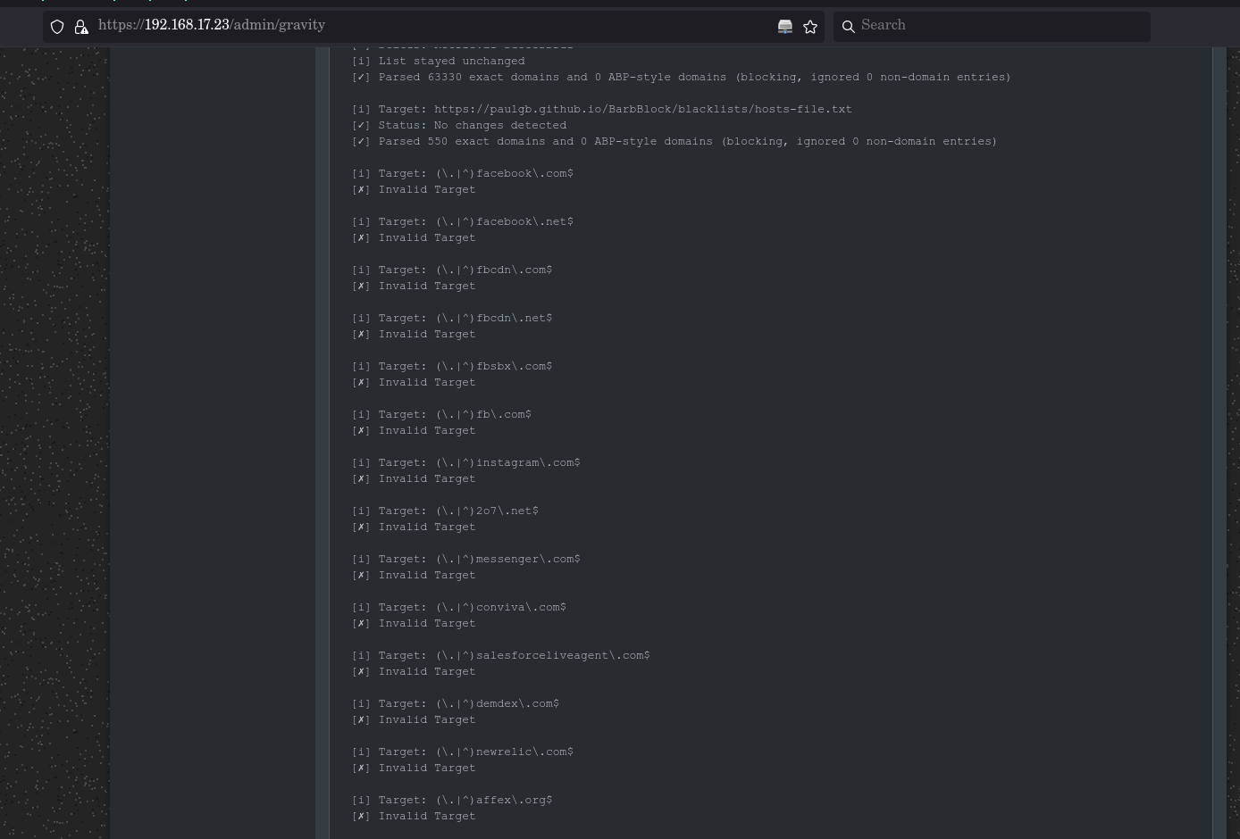

I got a bit carried away and pasted regex stuff to block in the wrong list.
So when I updated Pihole, it threw these messages at me.
So now when I try to get to the Groups it gives me this error:
An unknown error occurred while loading the data.
{"error":{"key":"database_error","message":"Could not read domains from database table","hint":"Database not available"},"took":0.00081777572631835938}
And the groups list doesn't display.
