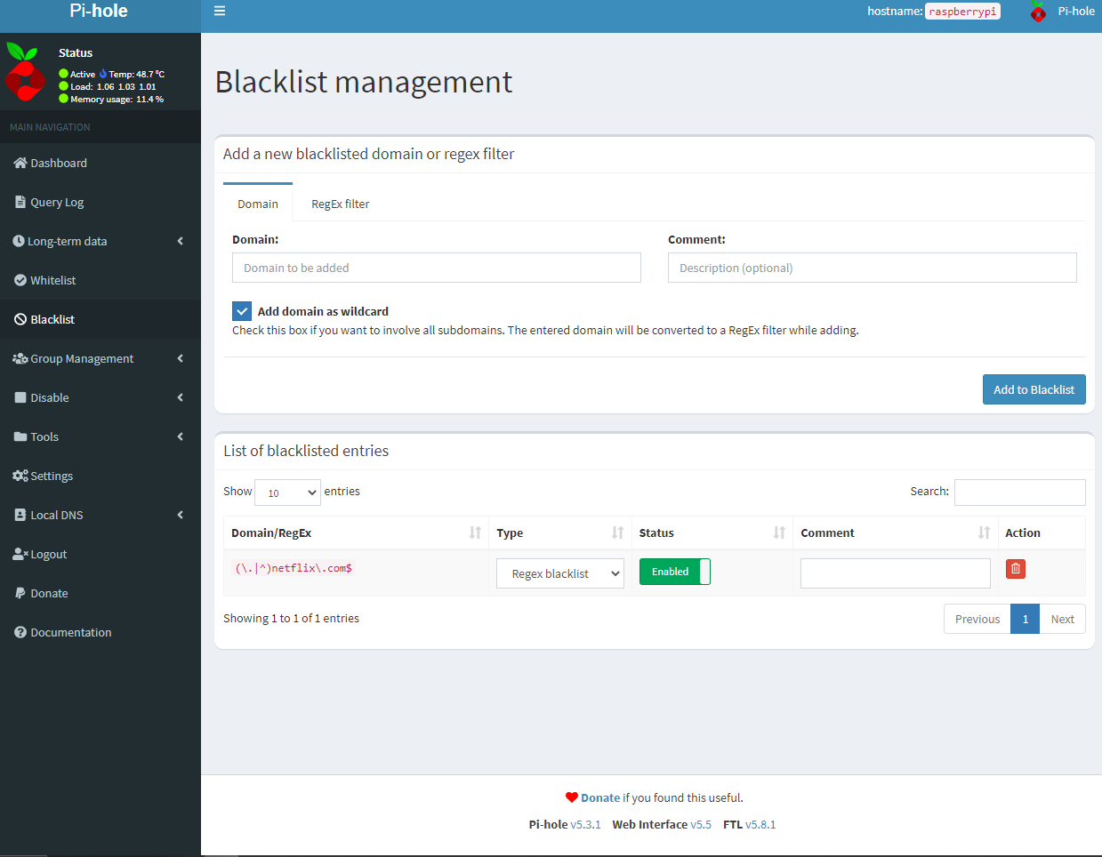

For the domain that serves the website, block that domain. Example:
https://facebook.com/somecontent.html
is a URL.
The domain is facebook.com
To block Facebook, add the domain to your black list as a wildcard.

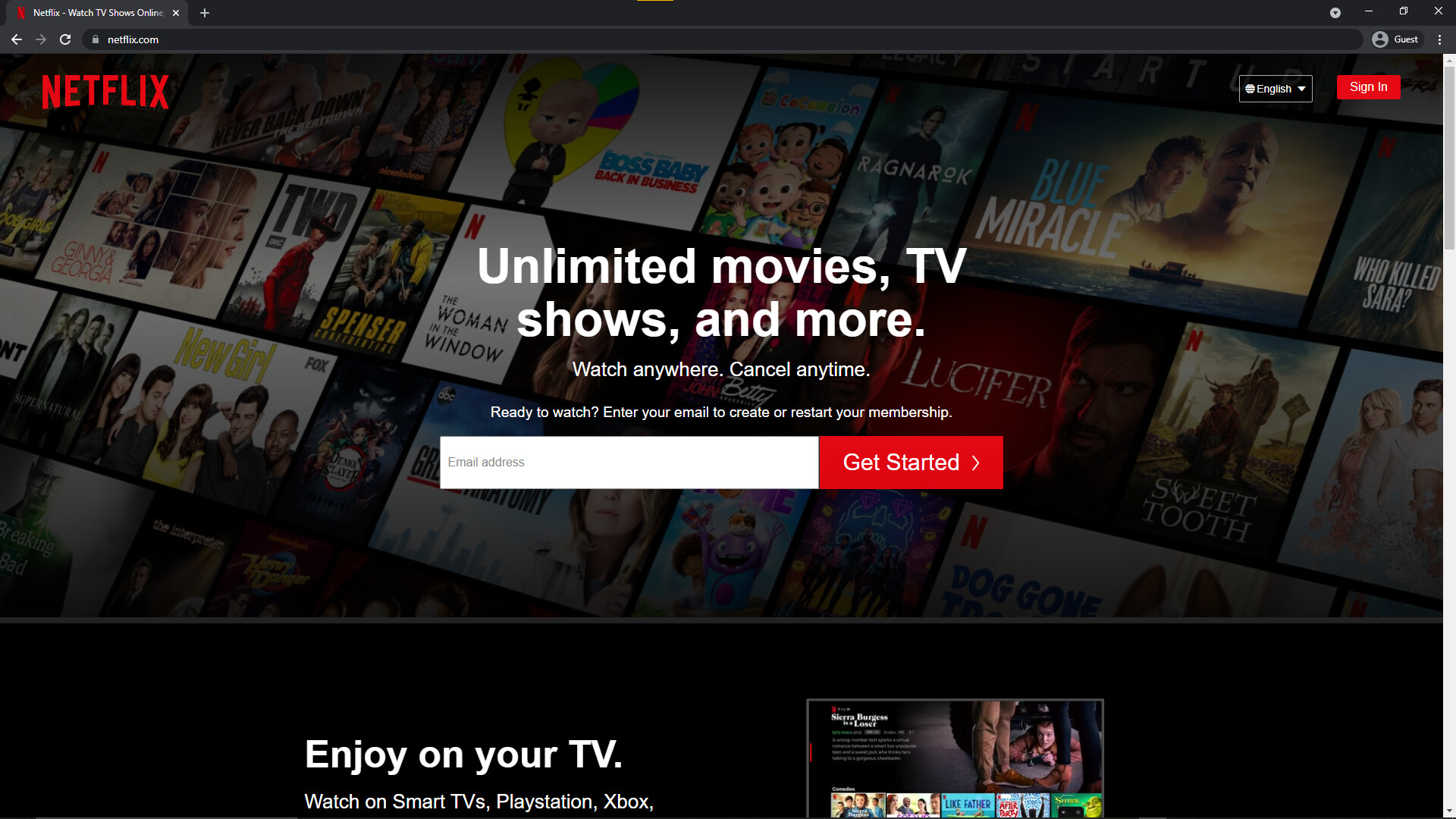

it did not work
tried to block Netflix, i set it as a wildcard, then I tried to go on Netflix, and somehow, i got to Netflix perfectly, so it did not block?
