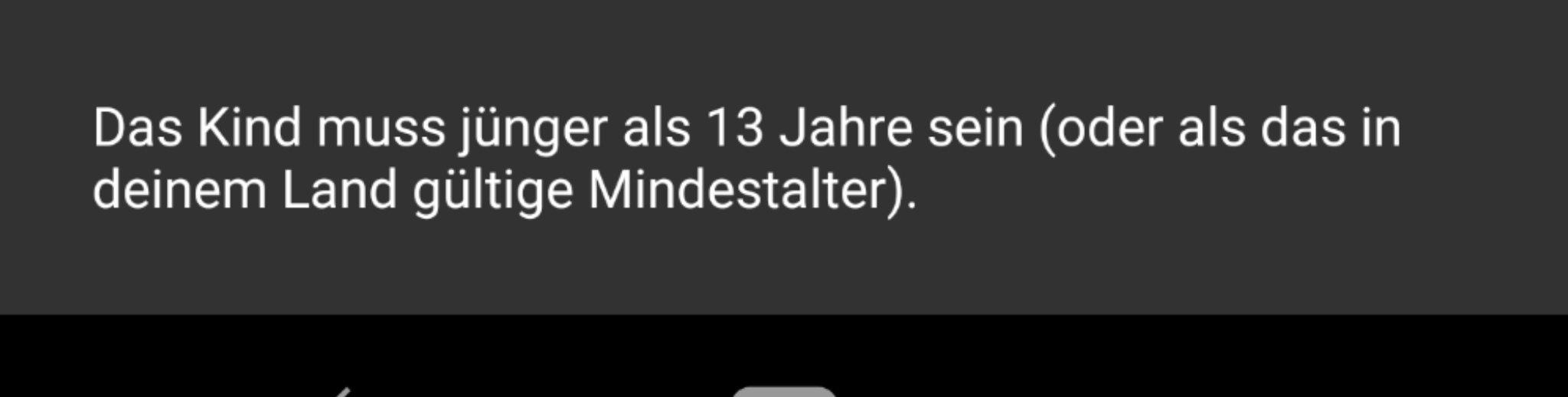

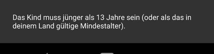

No than family Link says: Child has to be under 18 or the Age Barrier for Age-Restrictions valid in your Country.
Yeah, I think you have to enter something like 16, then confirm you entered the wrong date previously and they give you all kinds of warnings, but in the end it should work. I don't think they require a birth certificate or something like that. In any case, you can also create a new Google account, transfer all the data, then add it to Family Link if you really want to control it via Family Link. Alternatively you can just use 18+ and be logged into his account and check what he does via myactivity.google.com
No. Any date which makes him older than 15 affects the confirm button to be passive!
