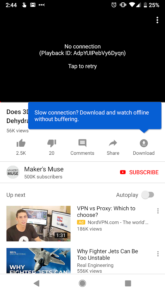

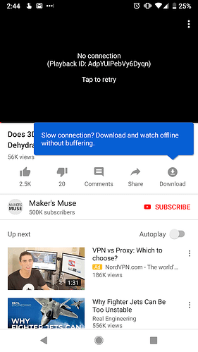

And here is what happens on my phone:

Currently no videos will load, and adding exact match for a subset makes no impact - I get an ad on every video that has an ad. But blocking all of them results in no videos loading, even videos that don't have ads.
I'm checking the query log for anything that looks different but I don't see anything, I relaunched the youtube app multiple times and force closed it in between and saw plenty of ads, so it should be here somewhere:
