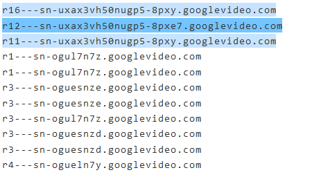

I've added the above regex. (Hope it's correct)
My youtube domains is tailing out these. I've checked with a regex checker and it's not catching it. Different because of region location?
r1---sn-ogul7n7z.googlevideo.com
r3---sn-oguesnze.googlevideo.com
r3---sn-ogul7n7z.googlevideo.com
r3---sn-oguesnzd.googlevideo.com
r4---sn-ogueln7y.googlevideo.com
Hello @duceduc
Your regex
grafik
and blocking result are perfectly fine that way. The regex does exactly what it was built for. Namely, find domains that have a very specific structure.
please refer:
The reason why I built the regex is that - at least for me - a lot of advertising come from domains, which have exactly this structure. As stated above, it is almost impossible to get the advertising on Youtube using Regex under control. The only thing that currently helps against this type of advertising is a browser extension (AddBlocker).

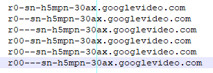

Anyone assist to make a regex for this:
r6---sn-h5mpn-30ad.googlevideo.com
r1---sn-h5mpn-30al.googlevideo.com
r3---sn-h5mpn-30ay.googlevideo.com
Thank you.

@ssneoh
Try this regex
grafik
This should match the following variants of your domains.
Speedy70
