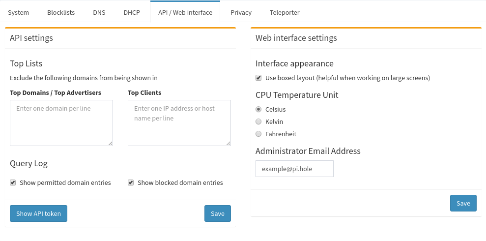

How can I remove the "Administrator Email Address" from the Pi-hole web interface?
How can I remove the "Administrator Email Address" from the Pi-hole web interface? I put in my email to test it but I don't want my email there.
Suggestion: add a "Remove Administrator Email Address" button for people to remove the email from the web interface. Because when I make it empty it goes back to what it previously was and not empty.
You are right: UI will rewrite the email address it already knows rather than deleting it.
Completely remove the line starting with ADMIN_EMAIL from setupVars.conf:
sudo nano /etc/pihole/setupVars.conf
I just found out that pihole -a email also works, it removes the email. But I would like a button on the web interface though as that would be convenient.
