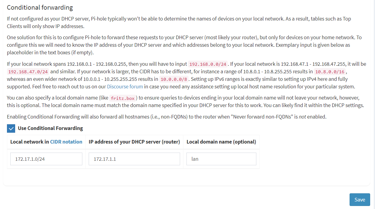

If you go to Settings > DNS on your Pi-Hole, then scroll all the way to the bottom of the page, you will find configuration for Conditional Forwarding. There you can set if you want to use .lan or .local for your local network domain name.
EDIT: You might also need to change some configuration on your router.
In the picture below you can see the following line:
The local domain name must match the domain name specified in your DHCP server for this to work. You can likely find it withing your DHCP settings.
