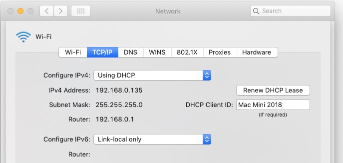

Look in the Mac system preferences > Network > Advanced > TCP/IP and see what name the Macbook is advertising.

You mean DHCP Client ID? It's empty on my MacBook.

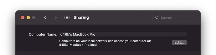

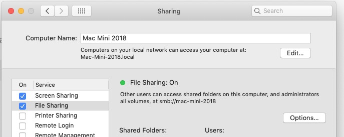

Also check the sharing section of the Mac system preferences - there is an optional device name setting there as well:

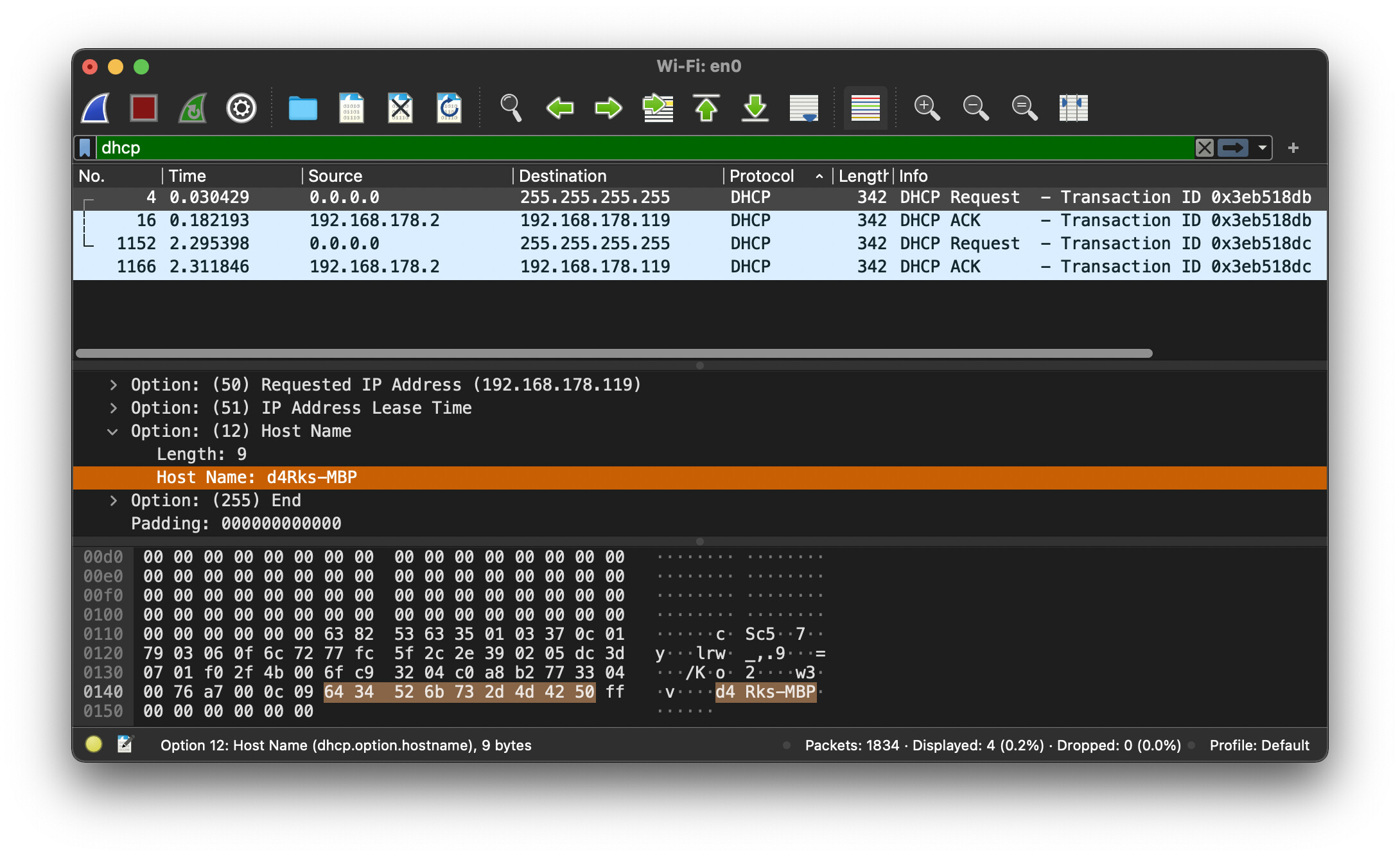

BUT I just did a packet capture using Wireshark, while renewing the DHCP lease.
And here it looks a lot different:
So I guess, I will point the research/debugging more towards the MacBook now!
Got it. :partying_face:

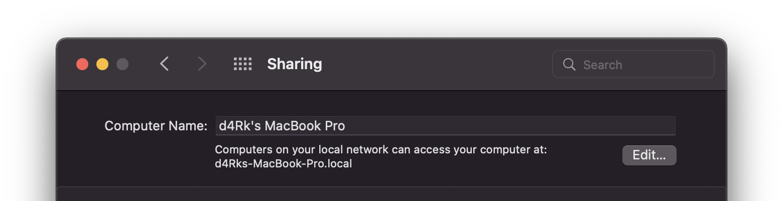

There must not be a space inside the "Computer Name" (System Preferences -> Sharing), see link below.:see_no_evil_monkey:
Really no clue, why I can set the hostname to whatever I want, when in the end, it matters what the computer name is?! Thx Apple for this confusion :wink:
