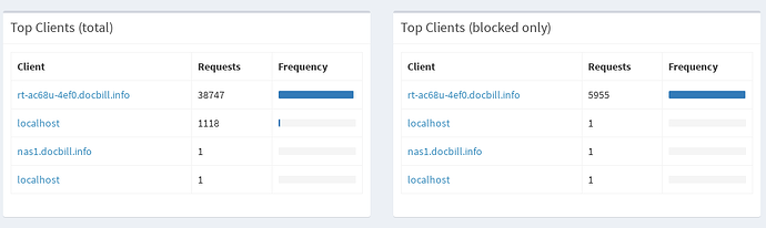

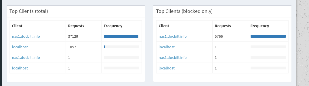

Here is an example when I login to nas1.docbill.info:
As you can see it shows all the queries coming from nas1.docbill.info and localhost. Even though I can see pihole filtering is working normally on all my devices.

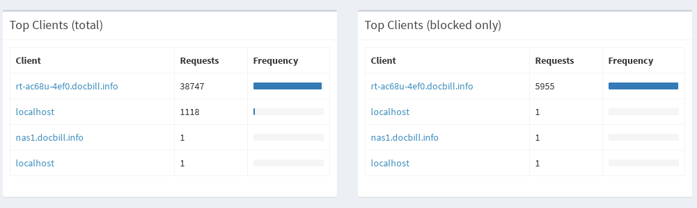

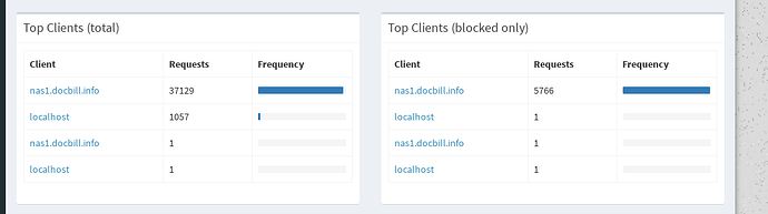

It looks resolved to me:
The updated stats are now reporting as everything coming from my router. But I think this is correct, as the way the asus router seems to be working is it tells all devices that it is the DNS sever, and then it redirects traffic to my pihole servers. So unless I have pihole take over as the dhpc server, that is seems like the best the pihole server can do.
