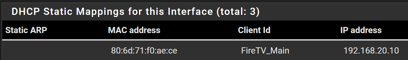

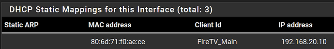

In pfsense VLAN 20 DHCP Server:
Client ID: FireTV_Main
IP Address: 192.168.20.10
Those results suggest that the DNS server on your 192.168.20.1 / 192.168.1.1 isn't aware of your VLAN20 hostnames.

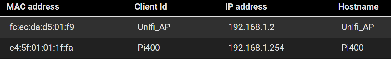

root@raspberrypi:~# nslookup Pi400 192.168.1.1
Server:         192.168.1.1
Address:        192.168.1.1#53
** server can't find Pi400: NXDOMAIN
root@raspberrypi:~# nslookup Unifi_AP 192.168.1.1
Server:         192.168.1.1
** server can't find Unifi_AP: NXDOMAIN
root@raspberrypi:~# nslookup 192.168.1.254 192.168.1.1
** server can't find 254.1.168.192.in-addr.arpa: NXDOMAIN
root@raspberrypi:~# nslookup 192.168.1.2 192.168.1.1
** server can't find 2.1.168.192.in-addr.arpa: NXDOMAIN
