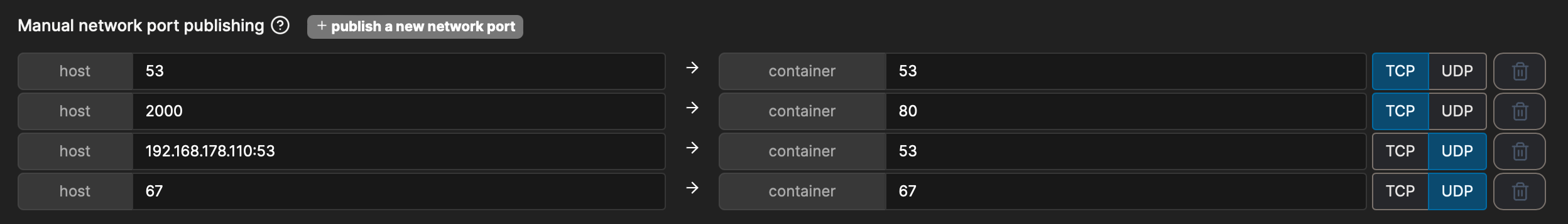

Ok digging deeper into the topic .. I changed the port allowcations now in portainer from:
...to this:
If I now do an nslookup inside the pihole container it gives correct feedback:
root@pihole:/# nslookup fritz.box
Server:         192.168.178.110
Address:        192.168.178.110#53

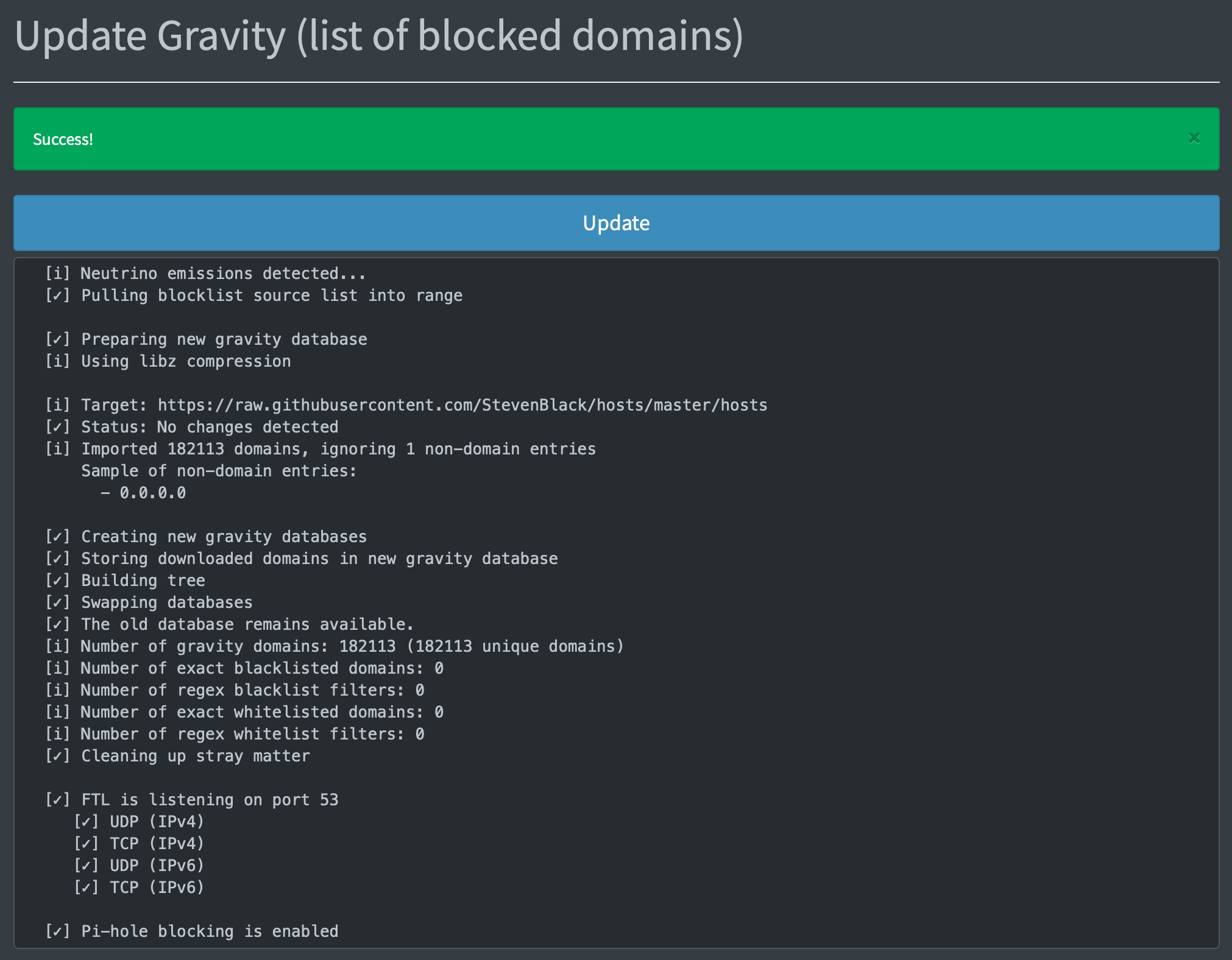

...and gravitiy updates also work now:

The vital info for me was to map the full pihole IP directly to port 53 (UDP).
