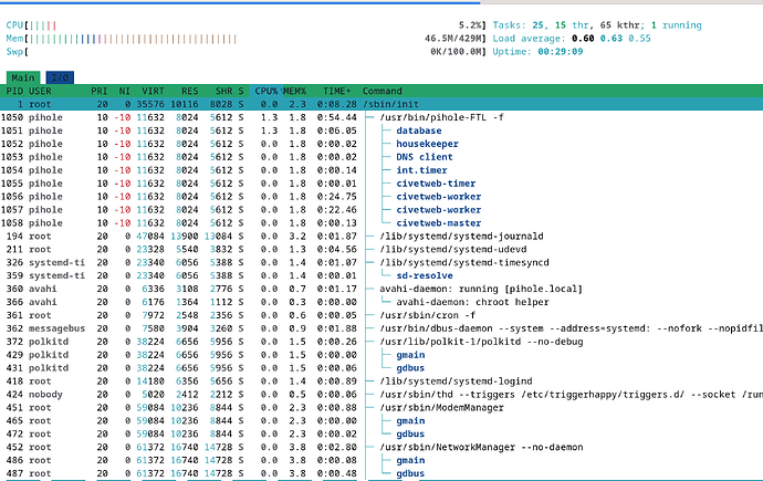

after a complete fresh install of pihole and raspbian

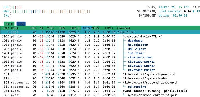

Please click on CPU% to sort by processor load so pihole-FTL is on the top and make a new screenshot.

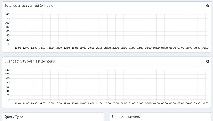

How many queries does your Pi-hole show as typical figure in 24 hours?

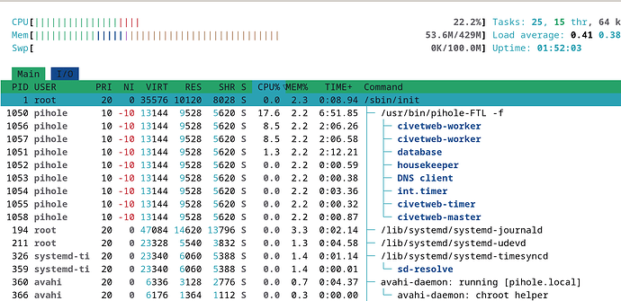

In this screenshot pihole-FTL is consuming only about 1.3% at that time. Overall your system is running for nearly 30 minutes now and FTL used slightly less than one minute of "CPU time". This means it used less than one minute a 100%-equivalent of computing time so about 3% of the total available CPU time since you started the machine.
Your screenshot furthermore shows that almost all work was done by the two civetweb-worker threads but currently they aren't doing anything. This may be expected on such a low-power device as the Pi Zero and comes from that we update the content on the web interface really frequently (up to once per second for the statistics). Maybe this is just too much for such a device.

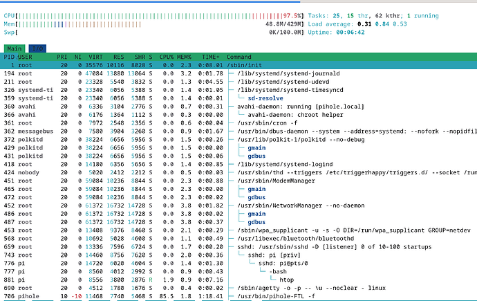

This is when I open the webinterface

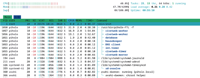

Looks better
