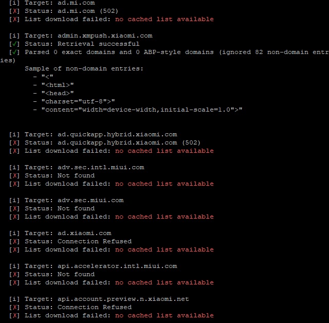

I have a problem with a lot of "xiaomi" domain lists that I found, they seemed to really work, but both with Update gravity, and with "pihole -r", I get again the same lists that the vast majority stay at:
[i] Target: xxx.xxxx.xxxx
[✗] Status: Not found
[✗] List download failed: no cached list available
With which this generates erroneous lists that always give errors when restarting and turning off the Raspberry Pi, I cannot delete them one by one because it tells me that it is read-only or that the database is locked (errors that I have seen here and everything leads me to the "pihole -r" command), but whatever I choose, the reconfiguration loads those non-existent domains again... I'm already crazy lost from attempts without results.
Please, as I can delete all the lists without any of them being loaded by a complete Wipe, what command to use if it exists.

The problem is that after those lists URLs you have 437 entries which are actual domain names. These should not be in the Adlists section because they are not adlist URLs. If you want to block those domains they should be in the Domains section.

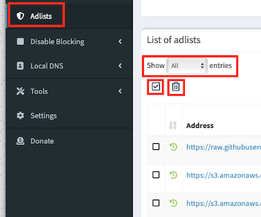

To remove these do the following:
  • Click on the Adlists section
  • Select Show All entries in the dropdown box
  • Tick the box just underneath that to select everything in there
  • Now carefully go down the list and untick all 32 of the https:// entries because these are all okay
  • Leave everything after those ticked
  • Now scroll the page back up and find the Delete icon which looks like a trash can, just underneath where it says Show All entries
  • Click that to delete the domain entries. It will take a few moments
  • Once done, confirm that you just have the https:// lines left in there
Now go to Tools > Update Gravity and click Update to do a fresh update of the database with the good lists that were left behind. Leave it on that screen until it says that it has finished.
