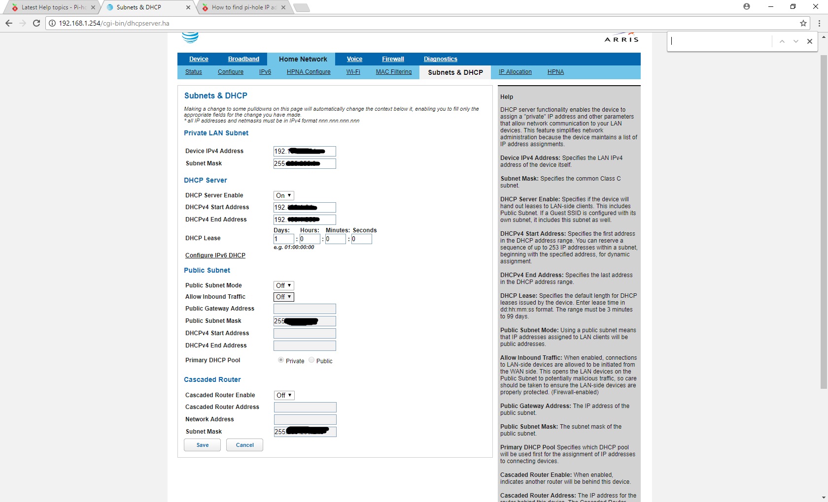

I tried to follow the installation and setup as described on this website. I got to the step to change my router's LAN DHCP settings so the static DNS is the Pi Hole's IP address. I know that every router is different but I am having trouble finding the corresponding area in my router's setup page. I found the "Subnets and DHCP" settings page, I assume one of these is the one I need to change, but I do not know which field to put the Pi Hole IP address. I have attached a screenshot, hopefully someone can help me. Thank you.
If you are going to use the Pi-hole as your DHCP server, just set DHCP Server Enable to Off.

Thank you for your reply. I did as you said and turned off the DHCP Server Enable, and then I changed the Start and End addresses to a range that would be away from my Pi Hole IP address. I rebooted my network, and when my network came back, I lost my internet, Wifi, and cable TV. I changed the settings back to what they were in my screenshot and I regained all of my services.
What am I doing wrong?
