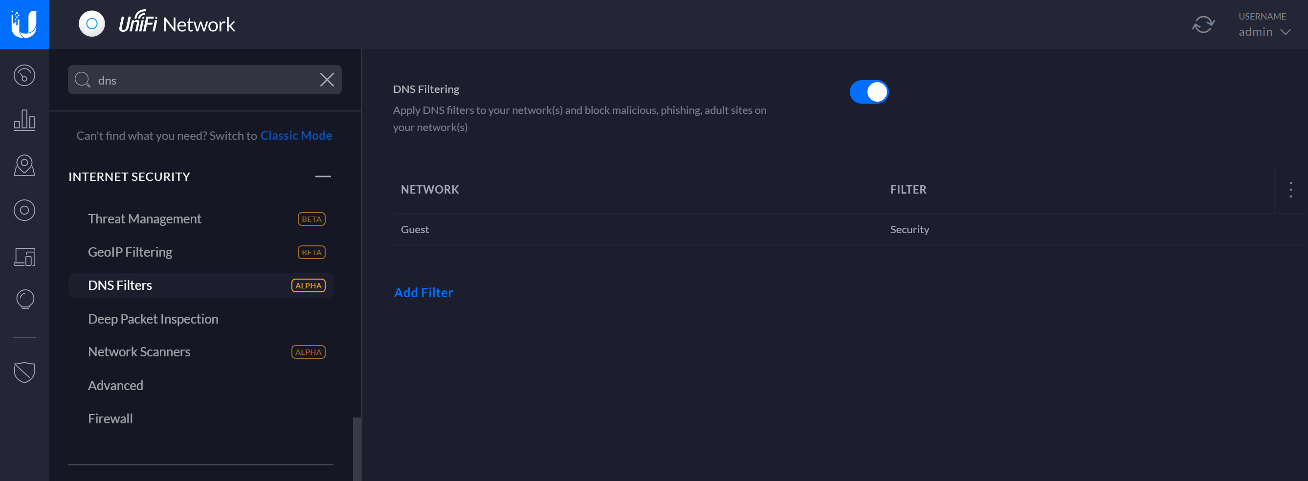

Ok... Finally have a resolution here.
Turns out content filtering was set on my UDM Pro. The UDM Pro must be intercepting all DNS traffic and replying back to the workstation after querying to it's own DNS providers. The source IP still shows as the pihole server and that is what was causing all the confusion on my end and making it difficult/"impossible" to see what is happening.
Now that content filtering is disabled I see the DNS queries show up in the pihole log for other subnets.
Thanks for pointing out the DNS intercept from the UDM. I just found this article that explains it a bit more in depth:
