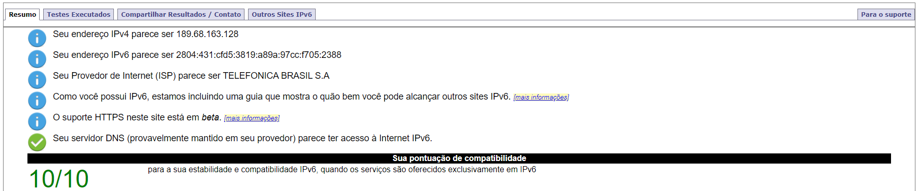

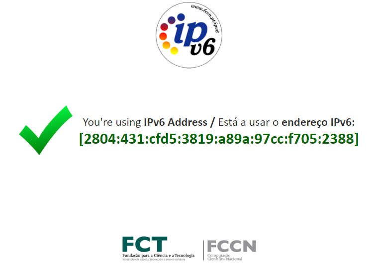

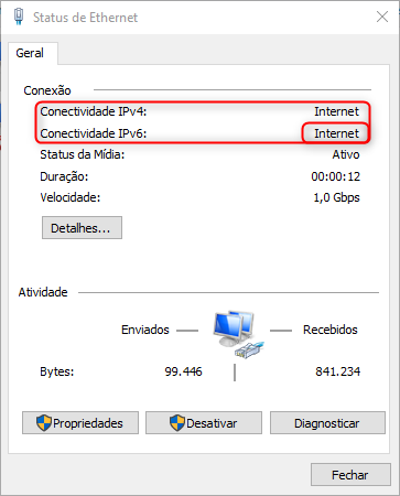

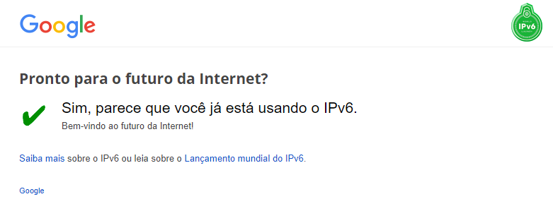

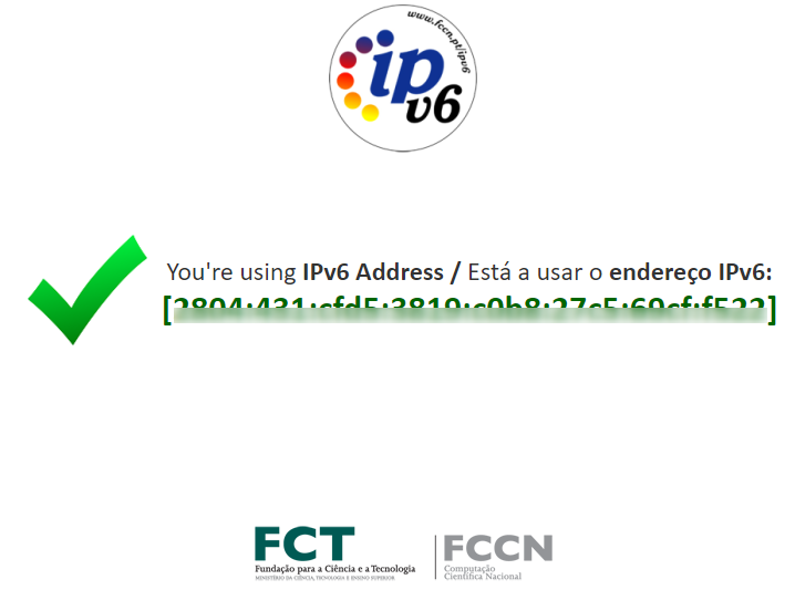

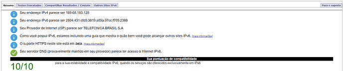

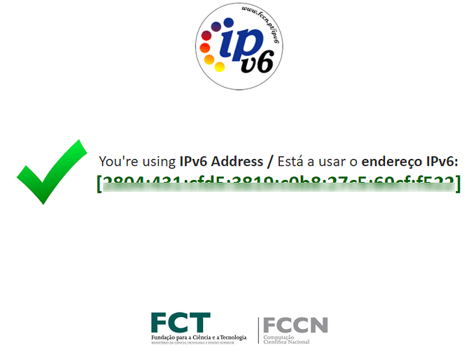

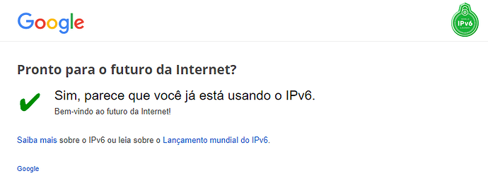

When a run tests about IPV6 in Internet, without use Pi-Hole, I have "OK" from tests, like screens bellow:

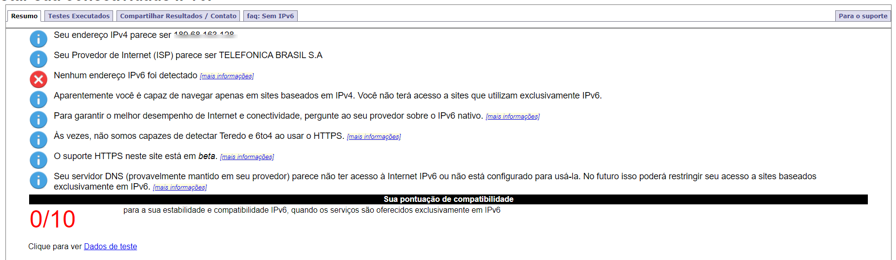

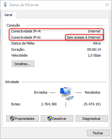

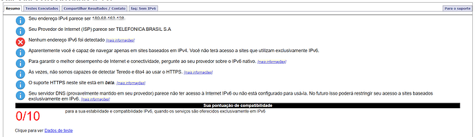

I temporarily disabled Pi-Hole, however, if I enable and test again on the same sites or even on other sites, I get an error in the IPV6 tests, , which indicates that there is some wrong configuration in the Pi-hole regarding IPV6.

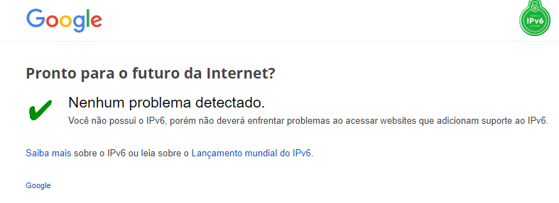

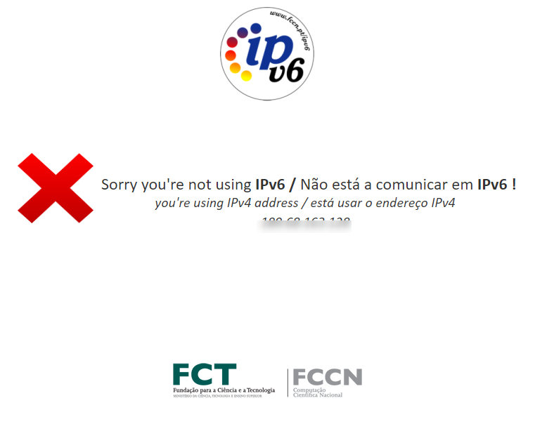

Repeating the same tests I did above, on the same sites, I have the following errors using Pi-Hole:

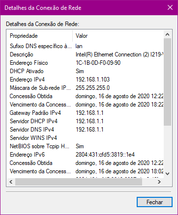

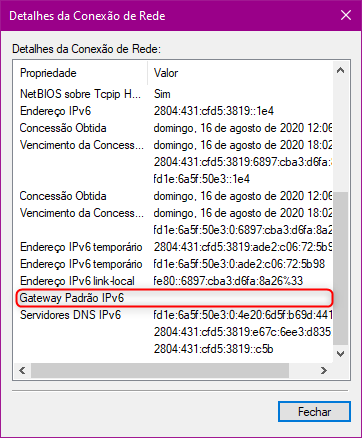

Guys, something caught my attention now ...

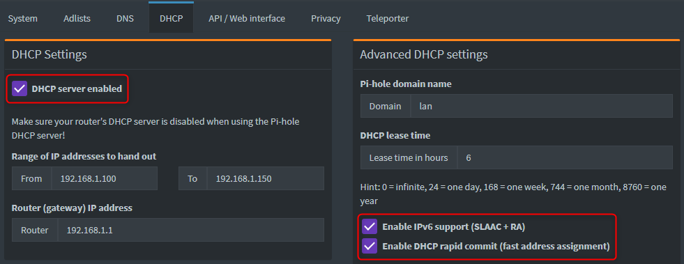

When I configure Pi-Hole to be a DHCP server (and DNS obviously), it does not deliver an IPV6 gateway on my machine's network card, see:
There is no problem in showing the IP addresses above as I will completely reconfigure my local network.
Removing the Pi-Hole and leaving only my router settings with Openwrt, version 19.07.2 ...
My provider here in Brazil is Vivo, from Telefónica Group ...
I get IPV6 from the provider via Virtual Dynamic Interface (DHCPv6 client) like this:
The IPV6 addresses above will change as soon as I reconfigure the PPPOE (restart) connection, so there is no problem showing them at this point ...

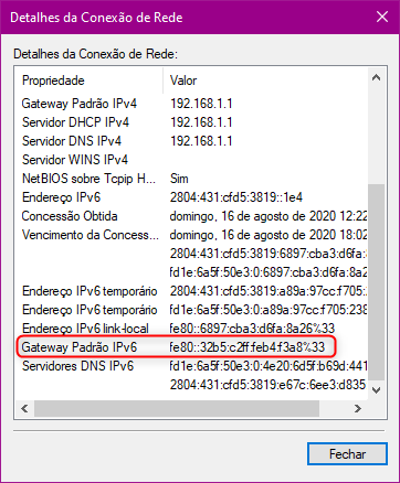

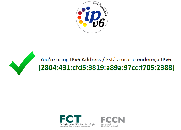

However, now look at the IP addresses configured on my machine's network card ...

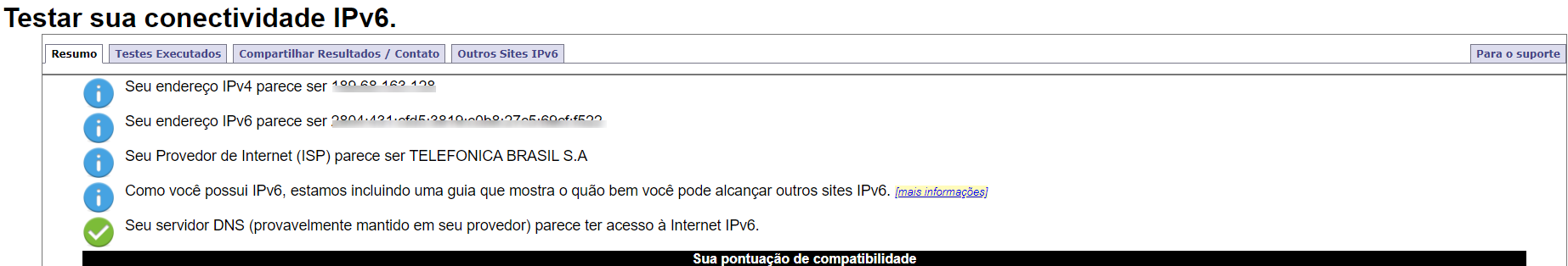

Repeating same tests ate same sites...
With that, I conclude that I am missing something in the Pi-Hole configuration so that it can deliver me an IPV6 gateway, however, I have no idea where I am missing, so I asked you for help, even for not having found a step-by-step Pi-Hole configuration tutorial for IPV6, as well as there are numerous available for IPV4 ...

That is a misconception:
Pi-hole's installation covers IPv4 as well as IPv6.
For the DNS part, there is nothing to configure in Pi-hole apart from providing a stable IPv6 address.
DHCPv6 options as accessible via Pi-hole's UI are sufficient for the majority of home users (for more exotic scenarios, dnsmasq's documentation -Pi-hole's embedded DNS/DHCP server- has all available options).
Specifically, there is no lack of an IPv6 gateway in Pi-hole's DHCP UI:
DHCPv6 has no gateway option.
Instead, a client learns the default gateway by digesting a router advertisment (RA) as the the link-local address of a respective router.
You'd have to convince your router to advertise itself as a gateway for IPv6..
You may want to further familiarise yourself with IPv6 in general and the different ways a client may join a network in specific, i.e. stateful vs. stateless DHCPv6 vs. SLAAC.
