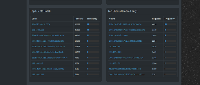

In my statistics, all i am seeing is IP addresses.

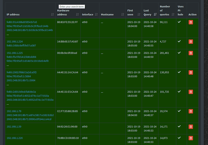

My network table shows no populated Host name information

Current Behavior: Pihole is detecting EDNS0 information, but is not populating it to network tables or statistic information.
Expected Behavior: Pihole should populate Hostnames for IP address from EDNS0 information connected.
