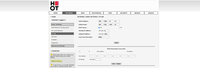

That's the LAN settings in my router before I turned off the DHCP server:
The DNS server that I used in the settings in the raspberry pi is 213.57.2.5 as written in my router
Best now to create a debug log for someone to look at. It's in Tools > Generate debug log > tick box for Upload > click Generate debug log.
Once it's done post the debug token URL in here so staff can find it. And please also post the results of those two nslookup commands.
