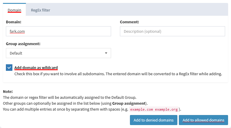

Your query log shows the domain is not fark.com. It is actually www.fark.com.
You can add the domain using the "Add domain as wildcard" checkbox:
Thank you. This was what I was looking for.
