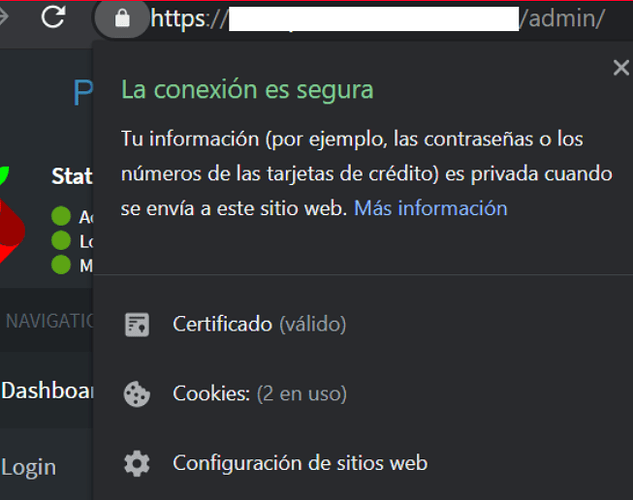

I leave the solution in case someone needs it:

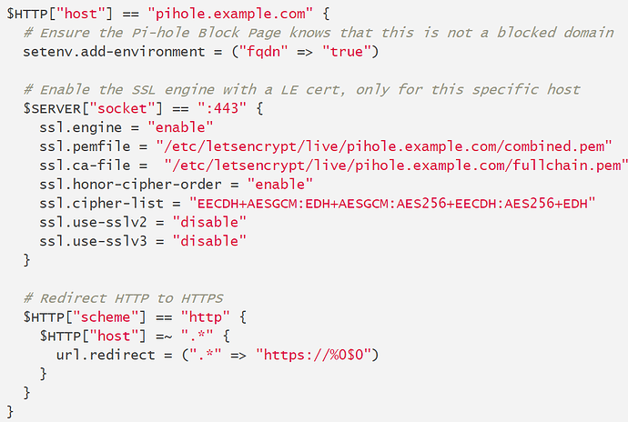

We create the folder /etc/letsencrypt/live/pihole.example.com/
pihole.example.com would be the name of our domain.
With permissions rw-r--r-- (0644)
We copy the .pem files that we create in this folder.
sudo chown www-data -R /etc/letsencrypt/live
We open /etc/lighttpd/external.conf
sudo service lighttpd restart
