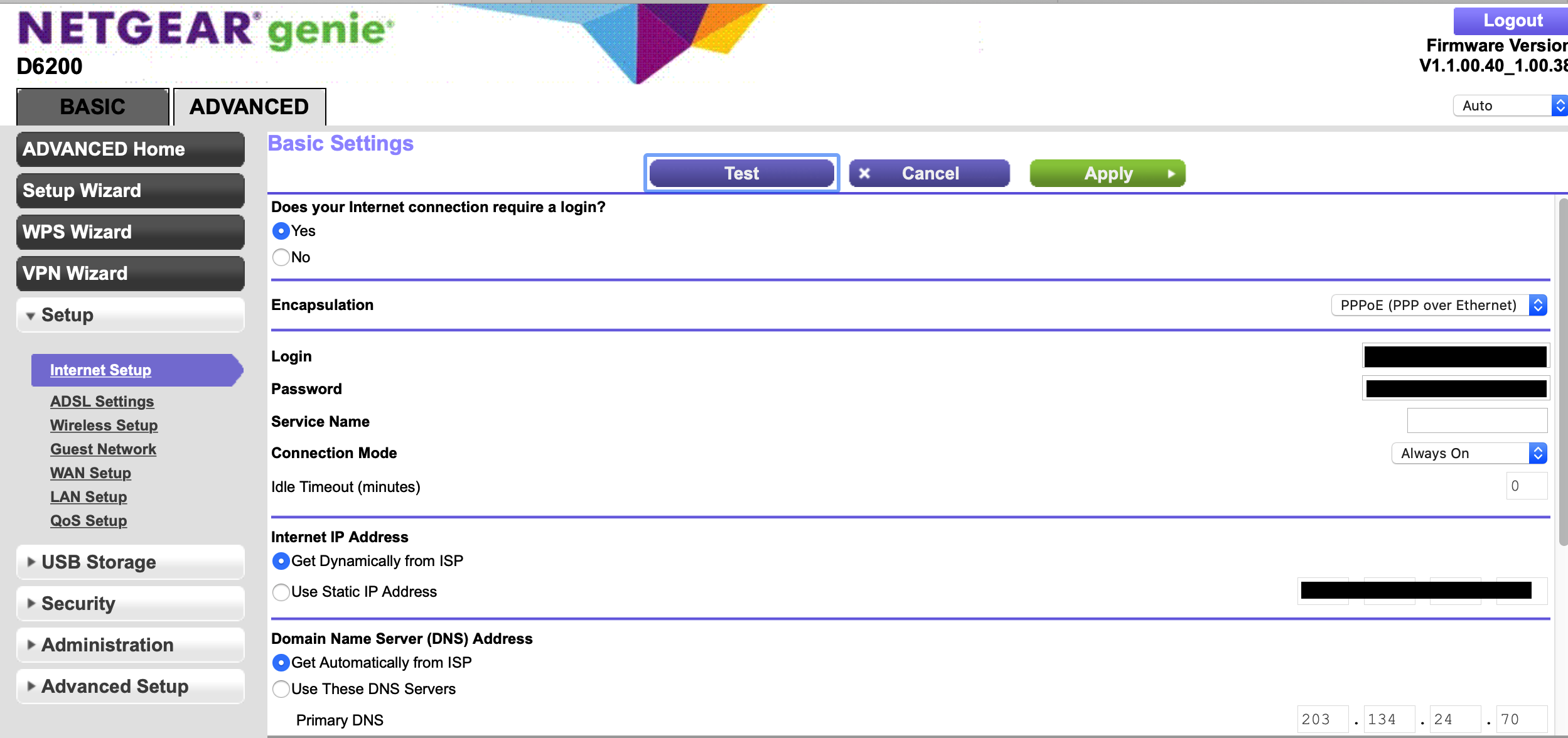

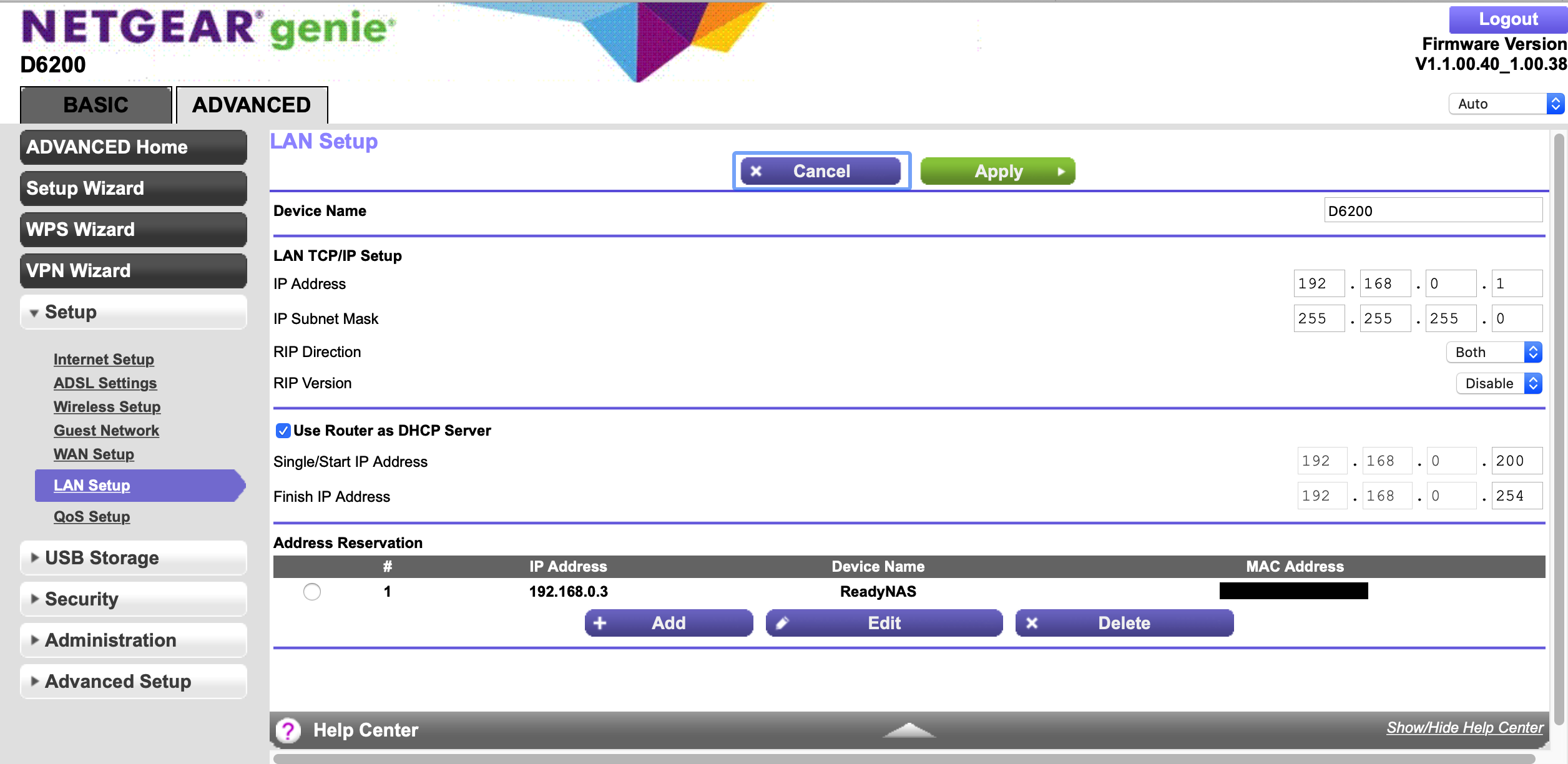

I did check. Mine is a Netgear D6200, and there is only one screen to specify DNS and a different screen to control DHCP.
Could you show both of those settings?
Also, we're still lacking the debug token.

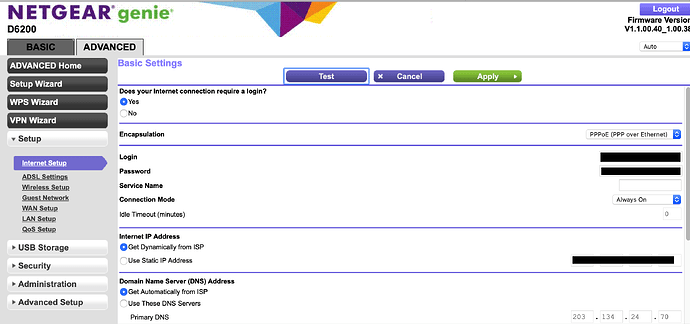

Below are the current screen shots from the router admin. Obviously when pihole is running I point the DNS to that (192.168.0.18) and turn off DHCP. However, I'm too scared to do that while my daughters are in the house, lest they are without internet for two minutes, and tear the skin from my body. And I assume the debug token is only relevant with these settings in place. But regardless, pihole is working flawlessly - it's my router that is the problem.
When Pi-hole is your DHCP server, there is no direct need to point your router to use Pi-hole as its upstream, as Pi-hole would provide DHCP clients with a local DNS server via DHCP (i.e. Pi-hole would distribute its own IP address).
As mentioned, by leaving your router's Internet/WAN DNS settings untouched, you would probably avoid those address shifts.
Note that you may have to force a client to renew its DHCP lease with Pi-hole before it would start picking up Pi-hole as local DNS (e.g. by dis- and reconnecting its wifi, or by power-cycling it).
Knowing the debug token would have allowed us to check on your DHCP server configuration as current at the time of debug log creation.
