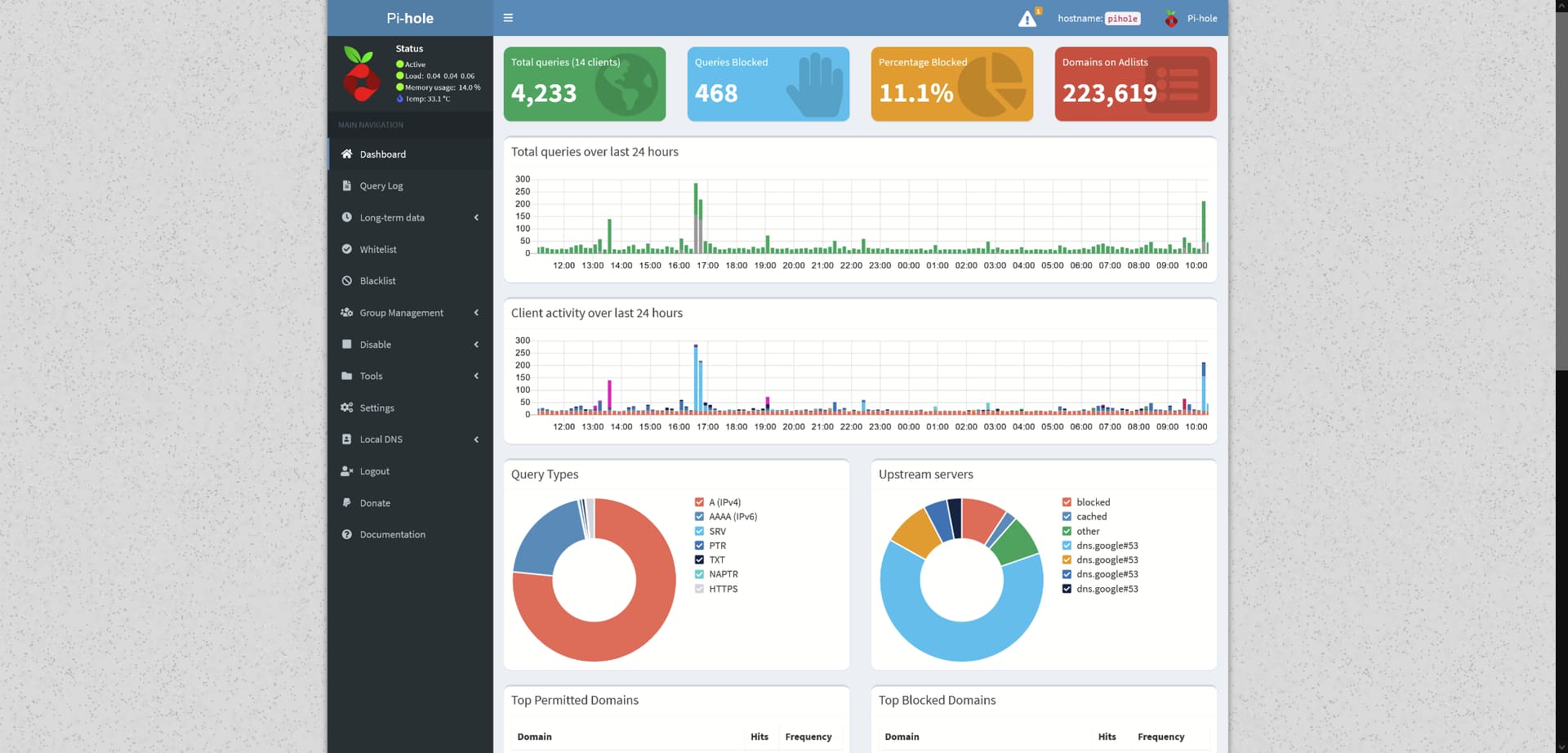

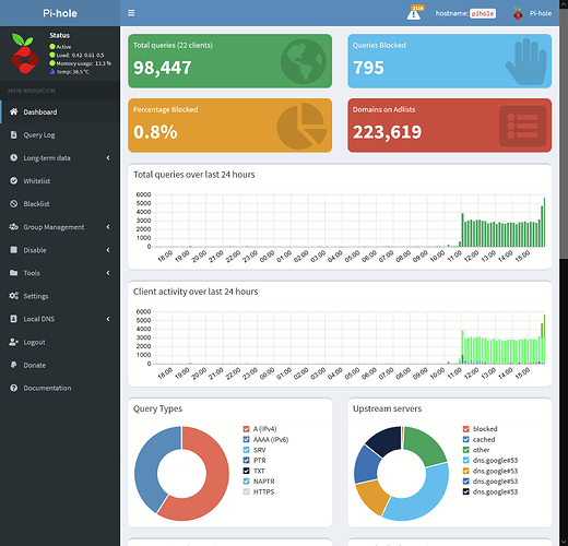

The stats seem to be misleading cause I find it hard to believe that it's stopping 11% but here is the home page

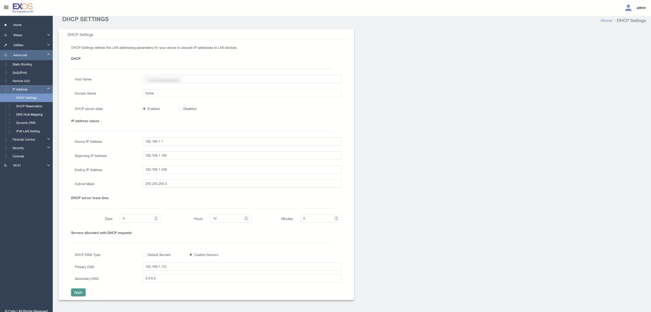

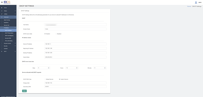

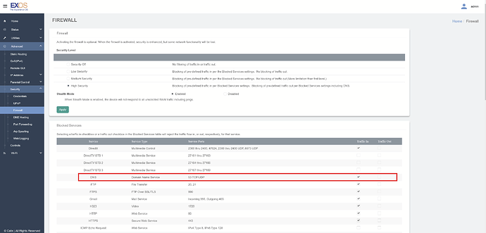

My router
  • I should also mention that I upgraded my router to a Calix device which is commercial grade to help me with coverage across my house but has the basic DNS settings that I think are correct.
  • This is the router https://www.calix.com/platforms/exos/exos-systems/gigaspire.html
    So here is my
  • Here are some of the DNS settings
I wish ads would get blocked again.
Ads are still coming through.

Your router's second DNS address should be blank because when it is used, pi hole is bypassed. And second doesn't mean only used if first fails.
Thanks for this. I've just removed the secondary DNS so I'll let you know how it goes, here are the current stats

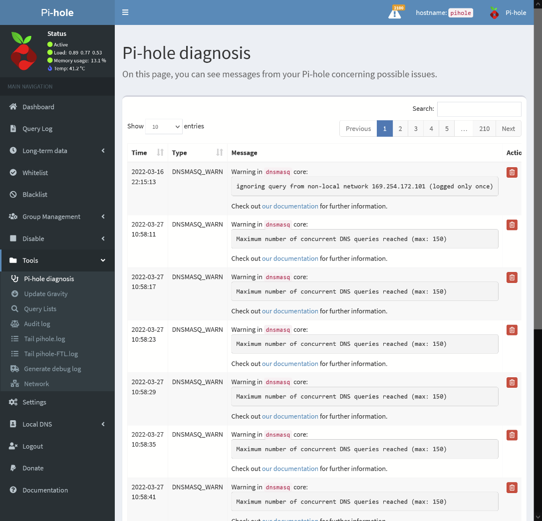

However, I'm getting a bunch of alerts it would appear, here is a snapshot
From the dash, one client seems to have a lot of those queries. You could start by checking that out. Also, another thread is discussing a large number of queries. Do you have conditional forwarding disabled, which could prevent circular queries?
If you don't find answers in from a search and you're still having trouble, you could run a pihole diagnosis from the dash and upload a debug token.
