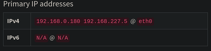

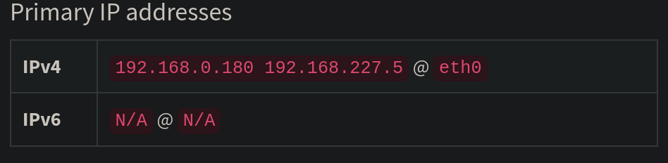

Part of the problem I see can be found in settings where the IPv4 has two addresses:
It used to be I would reboot 3-4 times and eventually it would assign 192.168.227.5 (rather than 192.168.0.180 - the LAN IP) and everything would work swimmingly.
Today, I updated DietPi and for some reason that reboot trick no longer works. I have tried to reconfigure the IPv4 by running pihole -r but this happens:

I see that 192.168.0.180 is assigned via DHCP from 192.168.0.1. If this is the intended IP used by other network members to connect to Pi-hole, then it probably makes sense to assign it as static IP not use the DHCP client at all. But if it is reserved at the DHCP server, that should be fine as well. The client (?) you pasted the output from above has 192.168.0.124, which suggest that this really is the intended network.
But where is 192.168.227.5 coming from? While the DHCP discovery at time of test did not get any answer with this IP, it actually seems to be obtained via DHCP as well, assigned to the same eth0 interface, and at time of test assigned the default route:
default via 192.168.227.1 dev eth0 src 192.168.227.5 metric 1002
192.168.0.0/24 dev eth0 proto kernel scope link src 192.168.0.180
192.168.227.0/24 dev eth0 proto dhcp scope link src 192.168.227.5 metric 1002
Is there another router/DHCP server in your network? Currently, the default gateway is 192.168.227.1, hence if your actual Internet facing router is 192.168.0.1, the system wouldn't have Internet access.
Assigning the IP 192.168.0.180 and gateway 192.168.0.1 statically at the Pi-hole host, instead of relying on DHCP, would solve this issue as well. But you should check for the rogue DHCP server (?) which tries to distribute the 192.168.227.0/24 network. If DHCP shall work at all, two networks must not be distributed throughout the same network adapters.
EDIT: The Pi-hole test also tried to ping the gateway 192.168.227.1 which did not respond. Whichever device this is, its DHCP server should be shut down.

The first debug log shows the router as the sole DHCP responder but the network port has two IPv4s, one set as noprefixroute
link/ether XXXXXX
inet 192.168.0.180/24 brd 192.168.0.255 scope global eth0
inet 192.168.227.5/24 brd 192.168.227.255 scope global noprefixroute eth0
inet6 fe80::XXXXXXX/64 scope link
