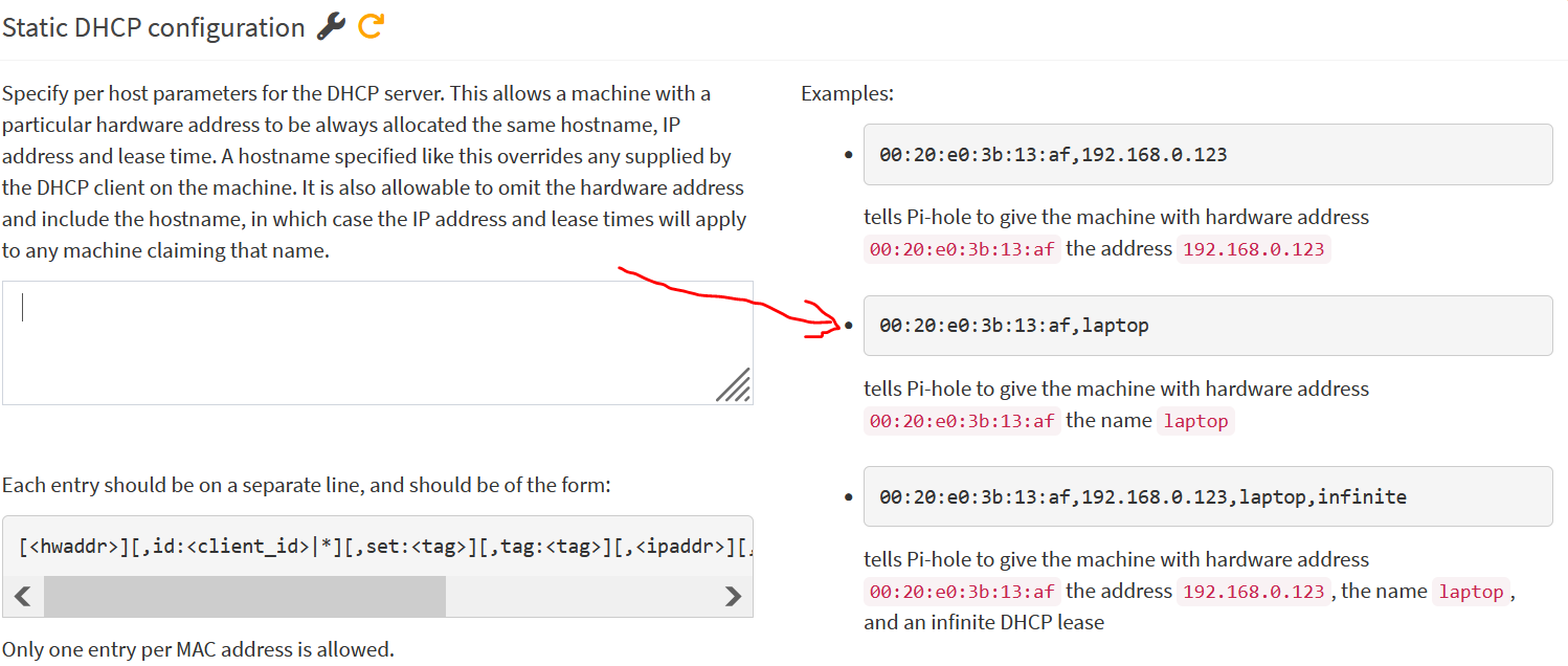

I really appreciate the help on this! One (hopefully) final question. Pihole is assigning super generic names to my devices, e.g. iPhone. Is there a way to customize these?
Edit the names on the devices themselves.
Most advertise a name or their own hostname via DHCP (the first tail).
If nothing else, you could fiddle with below setting if the MAC of the device is not changing:
