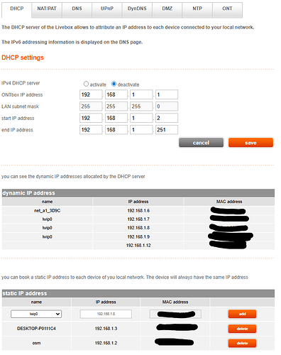

Here is my router configuraion:

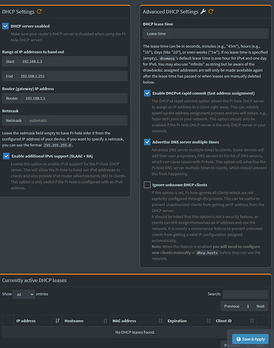

And this is my pihole configuration:

it is 192.168.1.2 i set it as static, you can see at the bottom of the router config
Your pi-hole is set with a static dhcp lease from your router. When you disable the dhcp server on your router, your pi-hole does not know where to get an IP from. This effectively stops the pi-hole from connecting to your network and handing out DHCP leases.
The solution is to set a static IP address of 192.168.1.2 on your pi-hole, that way it does not rely on an external dhcp server.

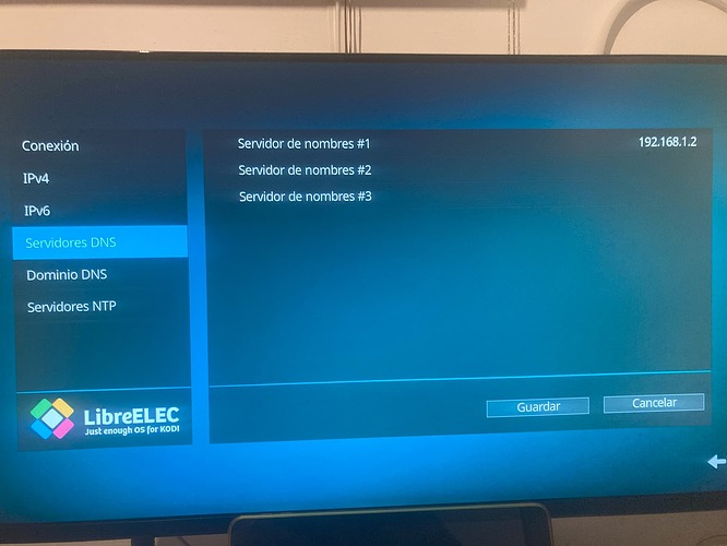

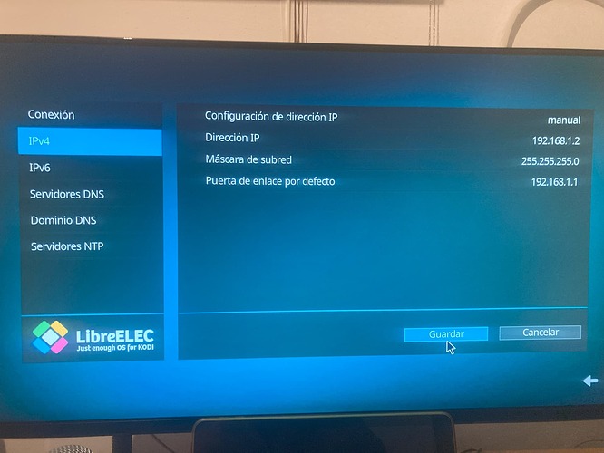

Are you running pihole along side librelec?
In your pihole setting, it looks like there is no value for the DHCP lease time. Could you try entering 1d in that text box and see if things work?

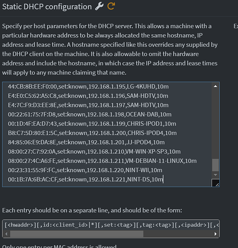

The static DHCP settings on the pihole (v6) should look something like this

What is your setup? You posted a picture of libreElec earlier with the same IP as the pi-hole, and now you are saying that it's a docker container. We need more information.
I am running pihole on my raspberry in a docker container. The OS that the raspberry is running is Libreelec.

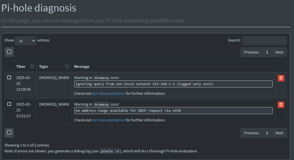

I am getting this in diagnosis
