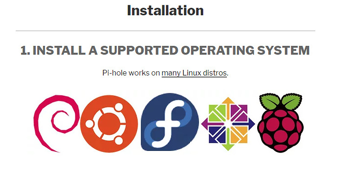

As for supported devices and environments, check out Installation on:
