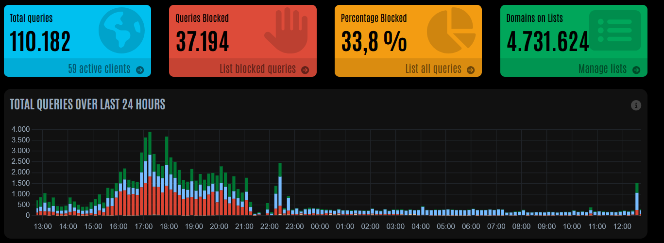

The update went on smoothly according to the log, but both the DNS and the UI were unusable, so I switched to a parallel running v5 (basicall telling my FritzBox to distribute the IPs for the v5-docker) - but left the v6 running over night. Not all clients are on the docker-Pihole as of now, but as you can see, after the update at around 21h, the request rapididly went down:

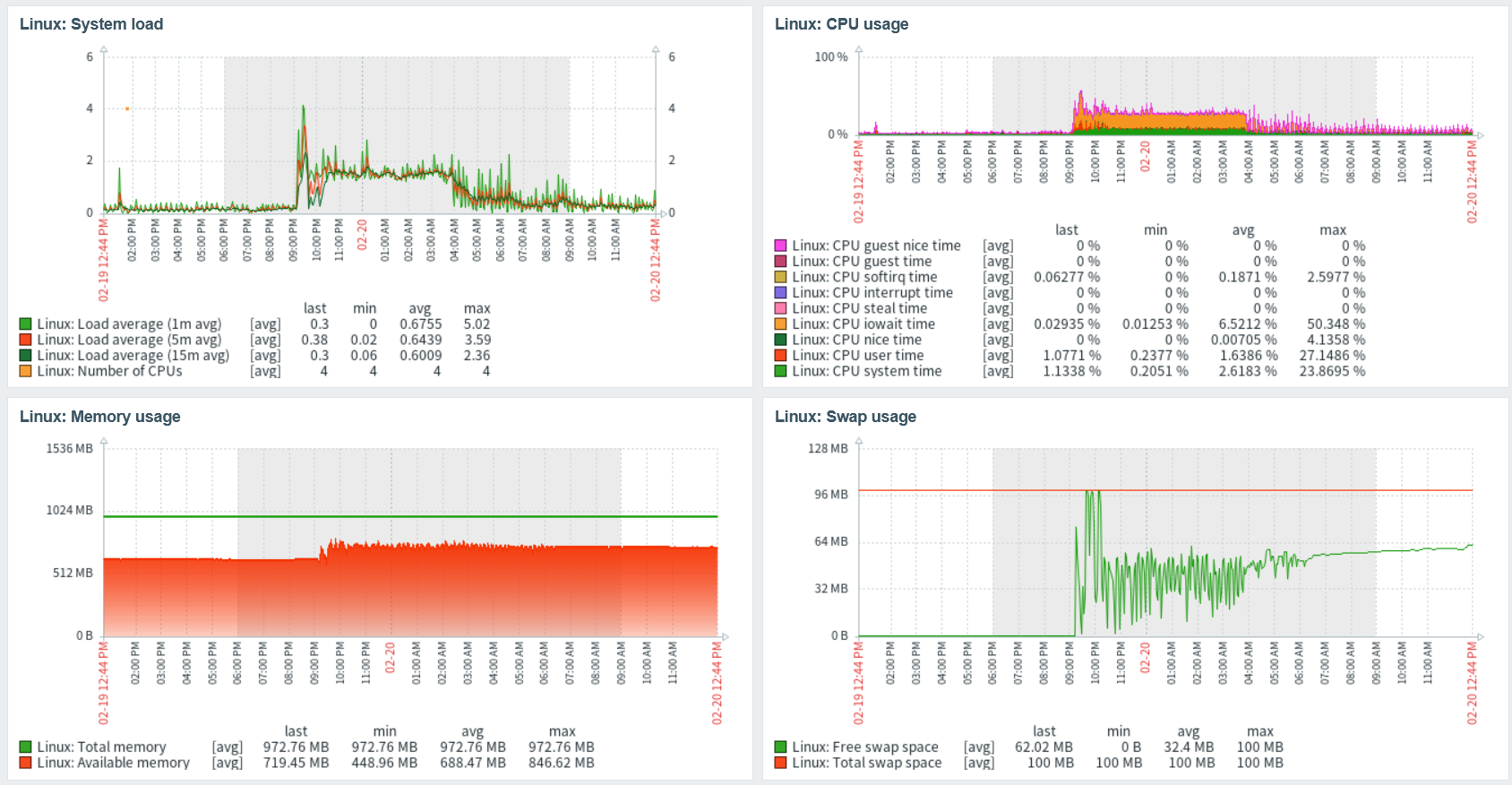

I also have Zabbix running in parallel, which showed this behaviour:

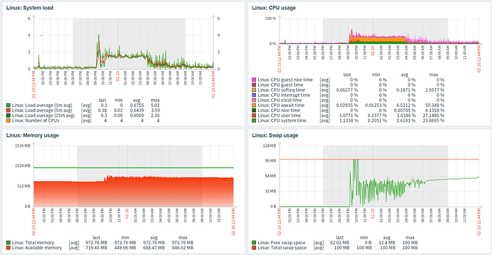

The Zabbix charts seem to concur with my experience, that now the UI works everytime without lags and the DNS works also (of course now with much less traffic)...
Is it save to assume, the upgrade needed like 6h for "after upgrade optimizations" on my Pi2? and now it would be safe to switch back to my initial Pi2 installation?

My FTL database is 4,5GB in size. I think it took that long to migrate the database for v6 or something...
This post explains it:
