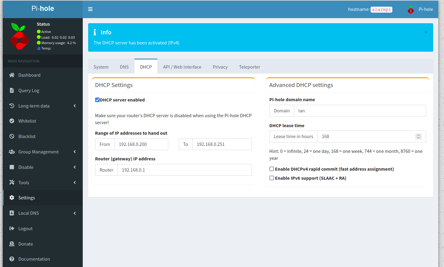

I ran pihole on Arch on a Raspberry Pi. I went to /admin/settings.php?tab=piholedhcp and checked the "DHCP server enabled" option and clicked "Save". I expected the DHCP server to start.
The DHCP server did not start, and half of the settings page disappeared.

Ok, this issue was solved by running
install -m 644 -o pihole -g pihole /dev/null /etc/pihole/dhcp.leases
Please consider to report that to the ArchLinux community as well.
ArchLinux is not officially supported by Pi-hole, but they kindly maintain their own AUR package for Pi-hole, so they may be interested in your findings (and perhaps may even be able to address them).
Thanks for the tip! I reported it in the AUR page for the package: https://aur.archlinux.org/packages/pi-hole-server#comment-864933
