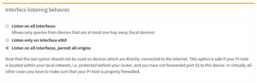

Yes, that should work equally well. You may have to change this setting on your Pi-hole dashboard:
(see Settings -> DNS)
