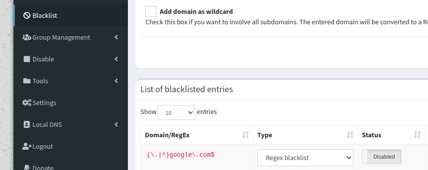

To block direct access to the site I had to add that url to the blacklist (as a wildcard regex). Then it was actually blocked when entered into the browser address field.

By adding badporn.com to your blacklist as a wildcard (which Pi-hole then converts to a regex), you block both this domain and any subdomains (which would include the www variant).
This is not correct. You can add as many domains to the blacklist as you like at once, as long as they are properly separated by spaces or line breaks (which will convert to spaces when you paste).

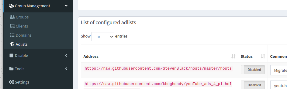

my confusion is really adlist
vs blacklist
So what you are saying is that an "ad blocked" domain is "blacklisted" but if the adblock list doesn't specifically include a subdomain (like www.) that subdomain won't be blocked. Ok that is what I experienced.
So then what about those "ad" lists. Looking at this adlist https://raw.githubusercontent.com/mhhakim/pihole-blocklist/master/porn.txt I observe it does not contain any wildcard regex. Does that mean an adlist can ONLY contain specific (sub)domains and never a wildcard regex? If so maybe THAT is why there is a totally separate place to add blocks (i.e. the blacklist) and there is where one can use wildcar regex?
BUT if an adlist can contain wildcard regex then why didn't they use it instead of repeating www. and www.www. for each base domain?
