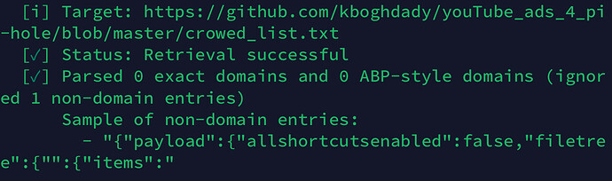

Hi everyone thanks for the replies. I’ve used pihole -g multiple times but I noticed the output stating that it parsed 0 domains. Could this be the cause?
For clarification I’ve used the pihole -g command to update the lists manually on the host as well used the ui to update them. I’ve also changed the perms to pihole for all the lists but I believe they had read access beforehand. After this I still saw no change, but today I noticed the some output of pihole -g said parsed 0 domains. I’m thinking it could be related to pihole not reading the lists.
Most of your links are not pointing to list files.
They are pointing to Github pages, showing the repository contents.
(You can see the difference if you open the links on your browser.)

rdwebdesign is right, this looks to be the problem. Your log shows most of your adlist links are using github.com. This won't work because they give the GitHub page, with the menus, the profile image, the meu list and so on. Those links are for humans to interact with.
What Pi-hole needs is just the actual raw text file. GitHub has a special address for that. To get to it, first copy one of your github.com links from Pi-hole and paste into a browser. You'll see the page load up.
Then edit the URL and replace the word blob with the word raw and press Enter.
blob
raw
You'll see that GitHub will bounce you over to the raw file, and it's just a .txt file of the list sitting on raw.githubusercontent.com
realraw
Copy that full link from the browser address bar. That is the link you need to put into Pi-hole for this adlist.
Delete the old github.com adlist and add this new raw.githubusercontent.com adlist. Do that for all your github.com links.
Once all done, run a Gravity Update so Pi-hole can update its database with all these new domains.
Thank you everyone! The issue was because of I needed the raw file.
