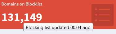

When I hoover over the Blocklist tab on the web interface it says last update 20:20 ago which is 3.13pm last Wednesday. If I check the modified date on the file /etc/pihole/gravity.list it says 3.13pm last Wednesday as well.
Though if I check the last modified date of /var/log/pihole_updateGravity.log it says 4.01am last Wednesday. Which should be the correct time (cron runs at 4am).
I'm a bit confused now. Why does the hoover say something different?
When does my Gravity update run now exactly?

I know the standard cron is random. I just changed it to 4am (instead of the random 4.23am) it was before.
I did for sure reload/refresh the page multiple times.
To make it even more strange it now says: last updated 01.57 ago
I did not do a manual update...
The time shown on the web interface is the last modification date of /etc/pihole/gravity.list, as you found out. If that time changes, then so will the time shown on the web interface.
