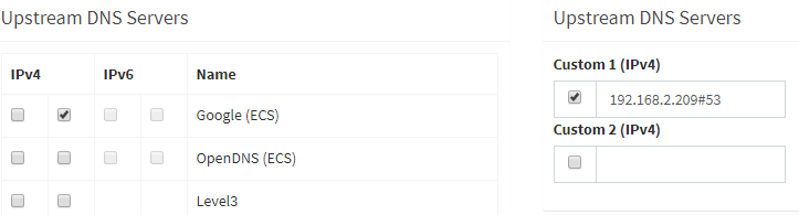

Thanks for the clarification! I guess I should say that of the two columns under "ipv4" in the upstream dns servers section of the pihole's dns settings, the one on the right is checked for Google. I have "Custom 1 (IPv4)" set originally to my pihole's reserved IP, but it seems to have that #53 added afterwards.

Can you provide a screenshot? Does this mean you set the IP of the Pi-hole as a DNS server on the Pi-hole? This would end up in an infinite loop as the Pi-hole would ask the Pi-hole would ask the Pi-hole would ask the Pi-hole, ...
This should obviously not be done. A healthy setup is to just use any combination of check boxes on the left side, there is no need to specify custom DNS servers for the vast majority of users.
The added #53 is expected, this is the port it tries to connect to (it automatically adds port 53 is you specified none).

Well now that you say it like that, it does sound pretty stupid. When I was trying to figure this all out and dealing with the GWF making things tricky, I think some screenshot on some tutorial had that Custom 1 pointed at the pihole. I'll remove that.
