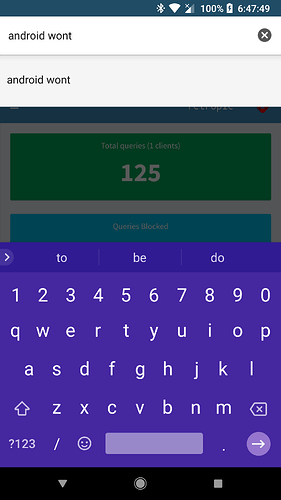

I'm currently using open dns as primary and secondary dns on the PiHole. So what your saying is change that to use Google dns and the search bar should work as normal?
It's looking like it still isn't working. I changed my DNS servers to Google DNS and I still get nothing for suggestions. As seen here.
I am getting csi.gstatic.com blocked. But I'm not sure if this is a Google domain or not. ssl.gstatic.com is show as forwarded. Maybe I should whitelist that domain?
Edit: just found that gstatic is a Google domain so I added it to the whitelist. Not sure if it will work or not.
Edit: still doesn't work
