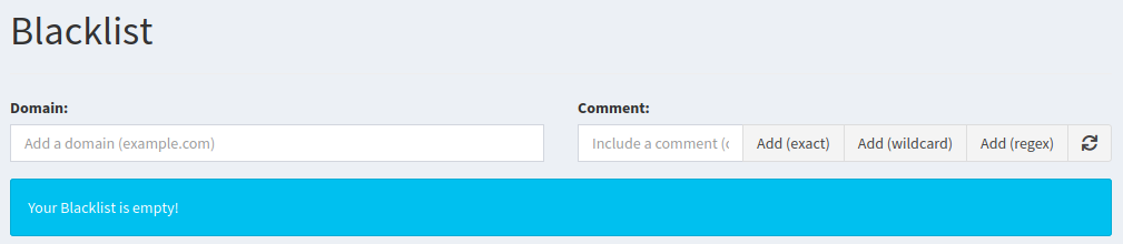

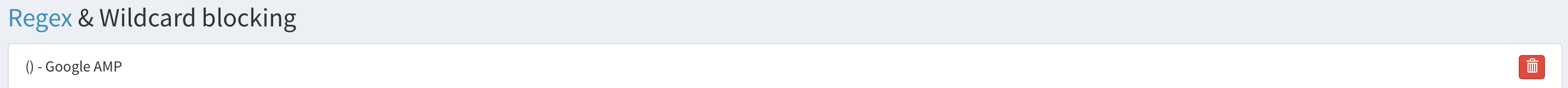

I managed to get a "ghost" regex blacklist entry I can't seem to remove through normal means. I tried adding ^(.+\.)?amp\..+\.com$ with comment "Google AMP" using the web interface, and it added this to my list:
Clicking the delete button appeared to delete the entry and showed a green success message. However, upon reloading the page the entry is still there.

I should note that while I was able to remove the bugged () entry through the group management page, attempting to add ^(.+\.)?amp\..+\.com$ as a regex blacklist entry incorrectly creates a () entry through BOTH the group management and legacy page. So, simply getting rid of the legacy pages wouldn't completely fix this bug.

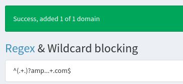

I tried this now and was not able to reproduce what you described. Here is exactly what I did:
  1. Went to http://pi.hole/admin/list.php?l=black
  2. Put in ^(.+.)?amp…+.com$ (no comment) and clicked Add (regex)
  3. See which I was expecting
  4. Click the Trash icon
  5. See domain got removed, checked this on the group management domain page as well
The domain you attempted to add was ^(.+.)?amp…+.com$. The domain I mentioned was ^(.+\.)?amp\..+\.com$. Like you, I am unable to reproduce the issue with the former, but am still able to reproduce the issue with mine using an up-to-date installation.
