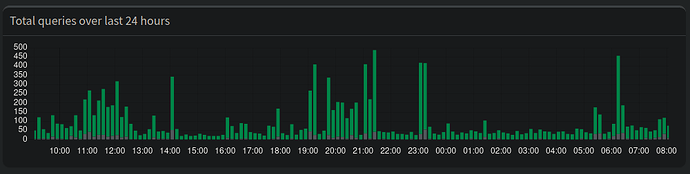

Yes, this. FTL aims at both efficiency and as small as possible memory footprint. Hence, the overTime slots are static and relative to the current system time. Each slot corresponds to one bar in this graph:
When loading queries from the database, we bin them into these slots. The last slot is "right now", the first one is "24 hours ago". So if your system clock says "last week" and we import a query that is today (or, in fact, any more recent than two weeks ago), it'd have to be binned into a slot that is in the future (remember that our system clock tells us that it is still two weeks ago). However, FTL knows that a query in the future is not a good idea so it complains. We should improve this warning message. Maybe ensure it is only printed once.
This all has no effect on how your DNS server works, it just means that some of the statistics computed from the imported queries will be incorrect.
