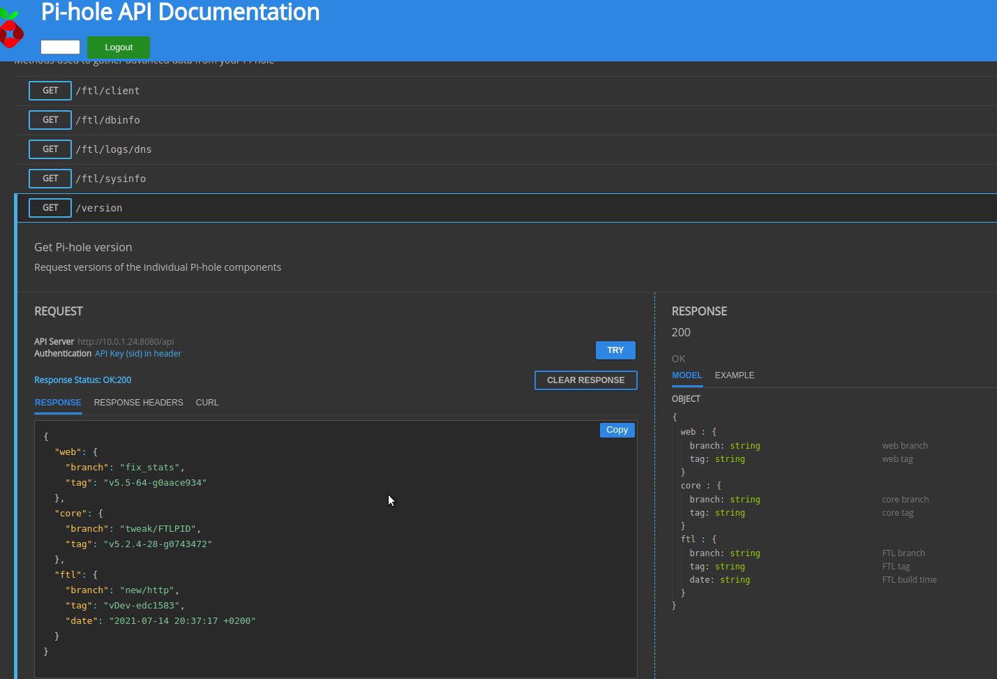

I don't think so.
Part of this information is already available in the new API which is currently in development and will be part of Pi-hole v6.0

Thanks. That new v6 API looks promising, definitely something I could work with.
