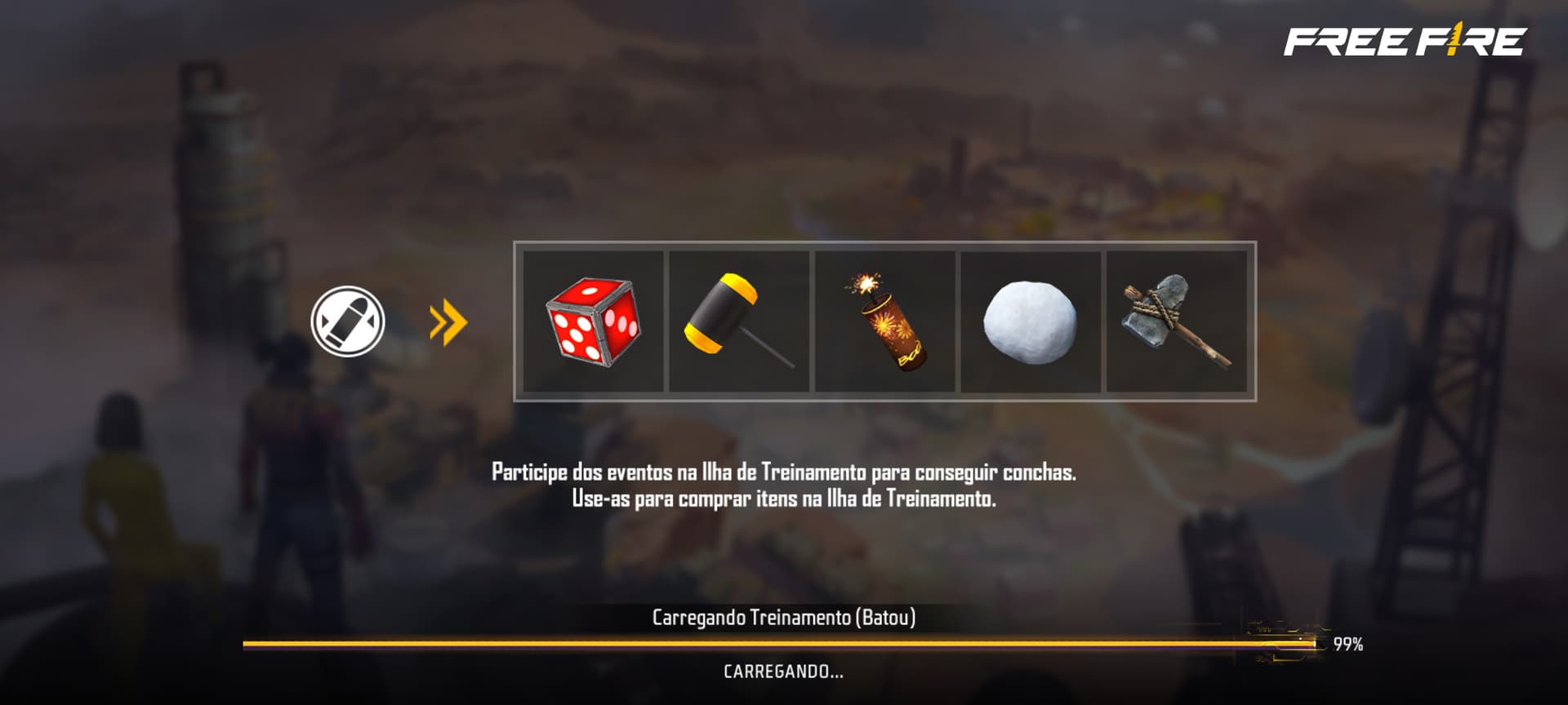

In the image below it shows the charging status at 99% and it does not start. (This happens when installing Pi-Hole and Unbound. At first it works but after a few minutes it stops working.)
Maybe it's the cache or Unbound, I don't know. But it's not Pi-Hole's ad blocker.
