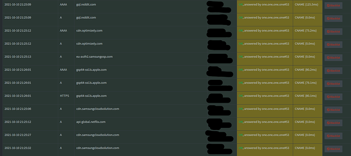

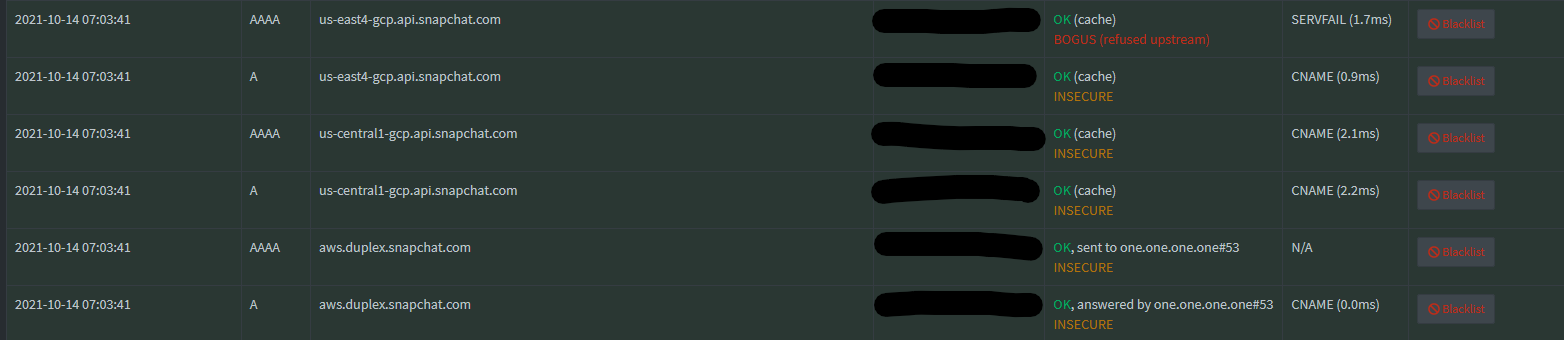

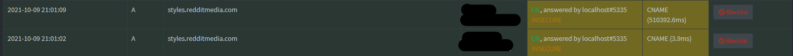

Garbage response times for many (almost half at times) CNAME answers
Pi-hole measures the response time of any query accurately in units of 1/10 ms and displays it in the Query Log.

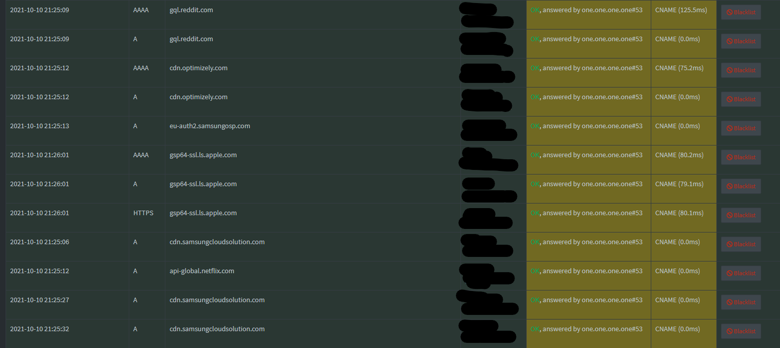

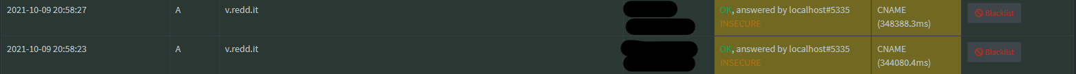

The response times for queries that end in CNAME records are really unreliable. Many of the response times are displayed as 0.0 ms, presumably because response times greater than 30 min are filtered out. But every now and again the reported response times are less than 30 minutes and really highlight the issue.

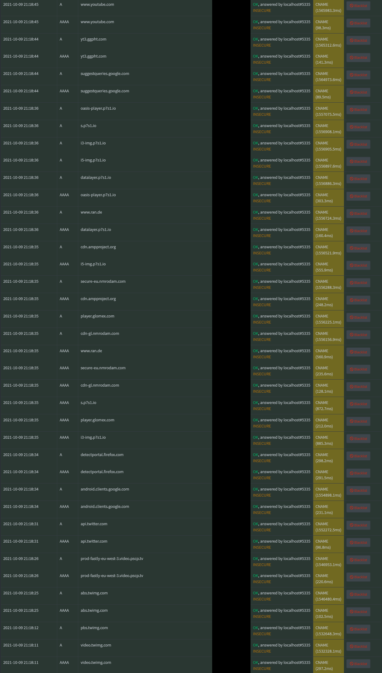

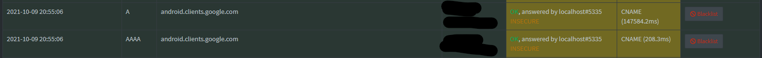

Of these 39 A and AAAA queries in a 10 minute interval whose responses were recorded as CNAMEs 19 (almost half) show a ridiculous response time of over 25 minutes despite a second query for the same domain showing a reasonable response time of mostly less than 200 milliseconds.

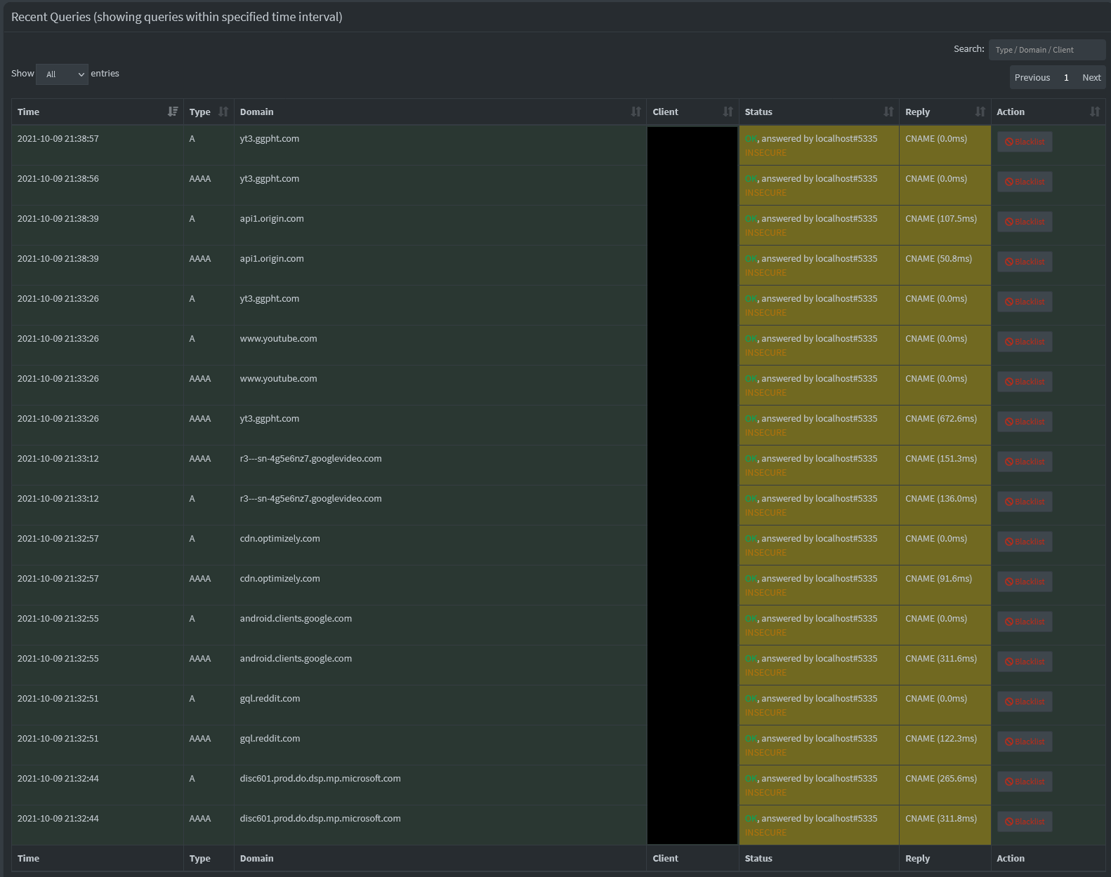

Here is a second equivalent case 2 intervals later where 8/18 recorded responses are shown as 0.0 ms.
The issue seems to come and go without any discernible pattern. Most of the time it's just a few queries here and there with a wrong response time but other times it's almost half of all queries.
Some of these domains point at lengthy CNAME chains with every link having a shorter TTL, other's CNAME records point directly at A or AAAA resources with identical TTLs without additional CNAMEs in between.
I experimented with removing the filter that I linked to above and found that in all cases I could find the response time is very close to the timestamp of the query, resulting in response times of half a century.

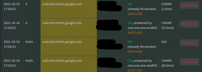

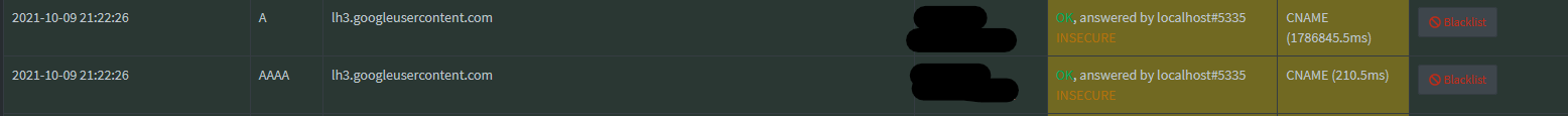

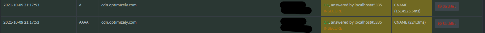

But when I do catch these low but still ridiculous times they seem to get gradually worse over time:

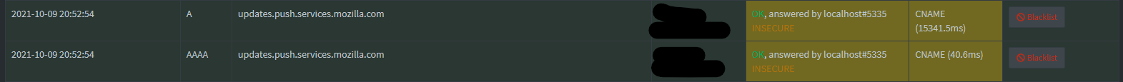

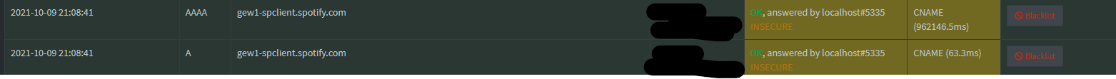

40 ms followed by 15 seconds.
2 minutes later: 200 ms followed by 147 seconds
Another 3.5 minutes later: response times of almost 6 minutes
Again 2.5 minutes later: 3.9 ms (probs cached by unbound) followed by 8.5 minutes
7 minutes later: 15 minute response time
10 minutes later: 25 minute response time
4.5 minutes later: the largest response time displayed is 29.8 minutes
Everything else after that shows 0.0 ms in the Query Log because of the filter. Maybe the timestamp of when the query is send upstream isn't updated and just freezes. I have no idea why it would only affect one query of the A/AAAA pairs and not the other. And as stated above, it doesn't happen to all pairs of queries either.

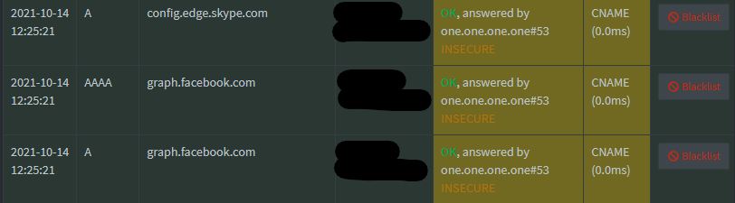

In my case around 11% of all queries are affected by this.
$ echo ">getallqueries >quit" | nc 127.0.0.1 4711 | awk '{if($8 == "0"){count+=1}}; {total+=1} END {print total,count}'
21948 2499
Edit: Just thought about maybe checking against all queries isn't really useful. So here are the numbers for just forwarded queries that resulted in a CNAME reply with 0 response time:
$ echo ">getallqueries >quit" | nc 127.0.0.1 4711 | awk '{if($5 == "2" && $7 == "3"){if($8 == "0"){count+=1}; {total+=1}}} END {print total,count}'
5612 1081
That's worse actually, just under 20%.

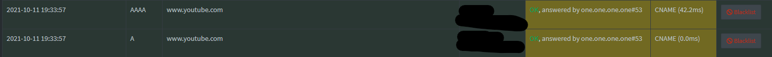

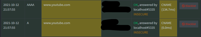

Nope, still see a lot of 0.0 ms for CNAME replies.
Pi-hole version is v5.5 (Latest: v5.5)
AdminLTE version is in detached HEAD state at v5.7 (Latest: v5.7)
FTL version is fix/reponse_times vDev-610c32e (Latest: v5.10.2)
Can you show us the correlated /var/log/pihole.log lines? Just thinking that if the replies are not properly logged, we may not know when the reply arrived.
0.0 has now the meaning of "no reply so far". That changed as I removed the artificial upper boundary for the reply time.

It looks like it was logged properly.
Yeah, indeed. Thanks for the testing domain, I should be able to reproduce this locally in 5 minutes...

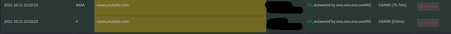

The issue also doesn't happen consistently, that's why every screenshot is of a different domain. :sweat_smile:
Nvm, managed to trigger www.youtube.com again (just opened a private window of Firefox and went to that domain, took a couple tries though).
pihole.log
Oct 11 22:32:25 dnsmasq[18362]: 1260 192.168.178.20/59780 query[A] www.youtube.com from 192.168.178.20
Oct 11 22:32:25 dnsmasq[18362]: 1260 192.168.178.20/59780 cached www.youtube.com is <CNAME>
Oct 11 22:32:25 dnsmasq[18362]: 1260 192.168.178.20/59780 forwarded www.youtube.com to 1.1.1.1
Oct 11 22:32:25 dnsmasq[18362]: 1261 192.168.178.20/58875 query[AAAA] www.youtube.com from 192.168.178.20
Oct 11 22:32:25 dnsmasq[18362]: 1261 192.168.178.20/58875 forwarded www.youtube.com to 1.1.1.1
Oct 11 22:32:25 dnsmasq[18362]: 1260 192.168.178.20/59780 reply www.youtube.com is <CNAME>
Oct 11 22:32:25 dnsmasq[18362]: 1260 192.168.178.20/59780 reply youtube-ui.l.google.com is 142.250.185.78
Oct 11 22:32:25 dnsmasq[18362]: 1260 192.168.178.20/59780 reply youtube-ui.l.google.com is 142.250.185.206
Oct 11 22:32:25 dnsmasq[18362]: 1260 192.168.178.20/59780 reply youtube-ui.l.google.com is 142.250.184.206
Oct 11 22:32:25 dnsmasq[18362]: 1260 192.168.178.20/59780 reply youtube-ui.l.google.com is 142.250.186.142
Oct 11 22:32:25 dnsmasq[18362]: 1260 192.168.178.20/59780 reply youtube-ui.l.google.com is 142.250.185.110
Oct 11 22:32:25 dnsmasq[18362]: 1260 192.168.178.20/59780 reply youtube-ui.l.google.com is 142.250.186.174
Oct 11 22:32:25 dnsmasq[18362]: 1260 192.168.178.20/59780 reply youtube-ui.l.google.com is 142.250.185.238
Oct 11 22:32:25 dnsmasq[18362]: 1260 192.168.178.20/59780 reply youtube-ui.l.google.com is 172.217.16.142
Oct 11 22:32:25 dnsmasq[18362]: 1260 192.168.178.20/59780 reply youtube-ui.l.google.com is 142.250.181.238
Oct 11 22:32:25 dnsmasq[18362]: 1260 192.168.178.20/59780 reply youtube-ui.l.google.com is 172.217.18.110
Oct 11 22:32:25 dnsmasq[18362]: 1260 192.168.178.20/59780 reply youtube-ui.l.google.com is 172.217.23.110
Oct 11 22:32:25 dnsmasq[18362]: 1260 192.168.178.20/59780 reply youtube-ui.l.google.com is 142.250.184.238
Oct 11 22:32:25 dnsmasq[18362]: 1260 192.168.178.20/59780 reply youtube-ui.l.google.com is 142.250.185.174
Oct 11 22:32:25 dnsmasq[18362]: 1260 192.168.178.20/59780 reply youtube-ui.l.google.com is 142.250.185.142
Oct 11 22:32:25 dnsmasq[18362]: 1260 192.168.178.20/59780 reply youtube-ui.l.google.com is 216.58.212.142
Oct 11 22:32:25 dnsmasq[18362]: 1260 192.168.178.20/59780 reply youtube-ui.l.google.com is 142.250.186.110
Oct 11 22:32:25 dnsmasq[18362]: 1261 192.168.178.20/58875 reply www.youtube.com is <CNAME>
Oct 11 22:32:25 dnsmasq[18362]: 1261 192.168.178.20/58875 reply youtube-ui.l.google.com is 2a00:1450:4001:831::200e
Oct 11 22:32:25 dnsmasq[18362]: 1261 192.168.178.20/58875 reply youtube-ui.l.google.com is 2a00:1450:4001:813::200e
Oct 11 22:32:25 dnsmasq[18362]: 1261 192.168.178.20/58875 reply youtube-ui.l.google.com is 2a00:1450:4001:812::200e
Oct 11 22:32:25 dnsmasq[18362]: 1261 192.168.178.20/58875 reply youtube-ui.l.google.com is 2a00:1450:4001:811::200e
pihole-FTL.log
[2021-10-11 22:32:25.148 18362M] Processing FTL hook from src/dnsmasq/forward.c:1575...
[2021-10-11 22:32:25.148 18362M]      Flags: F_FORWARD F_IPV4 F_QUERY
[2021-10-11 22:32:25.149 18362M] **** new UDP IPv4 query[A] query "www.youtube.com" from wlan0:192.168.178.20#59780 (ID 1260, FTL 36380, src/dnsmasq/forward.c:1577)
[2021-10-11 22:32:25.149 18362M] www.youtube.com is known as not to be blocked
[2021-10-11 22:32:25.150 18362M] Processing FTL hook from src/dnsmasq/rfc1035.c:1502...
[2021-10-11 22:32:25.150 18362M]      Flags: F_FORWARD F_CNAME
[2021-10-11 22:32:25.150 18362M] **** got cache reply: www.youtube.com is (CNAME) (ID 1260, src/dnsmasq/rfc1035.c:1502)
[2021-10-11 22:32:25.150 18362M] Set reply to CNAME (3) in src/dnsmasq_interface.c:2015
[2021-10-11 22:32:25.152 18362M] Processing FTL hook from src/dnsmasq/forward.c:522...
[2021-10-11 22:32:25.152 18362M]      Flags: F_FORWARD F_IPV4 F_SERVER
[2021-10-11 22:32:25.152 18362M] **** forwarded www.youtube.com to 1.1.1.1#53 (ID 1260, src/dnsmasq/forward.c:522)
[2021-10-11 22:32:25.153 18362M] Processing FTL hook from src/dnsmasq/forward.c:1575...
[2021-10-11 22:32:25.153 18362M]      Flags: F_FORWARD F_IPV4 F_QUERY
[2021-10-11 22:32:25.154 18362M] **** new UDP IPv4 query[AAAA] query "www.youtube.com" from wlan0:192.168.178.20#58875 (ID 1261, FTL 36381, src/dnsmasq/forward.c:1577)
[2021-10-11 22:32:25.154 18362M] www.youtube.com is known as not to be blocked
[2021-10-11 22:32:25.155 18362M] Processing FTL hook from src/dnsmasq/forward.c:522...
[2021-10-11 22:32:25.156 18362M]      Flags: F_FORWARD F_IPV4 F_SERVER
[2021-10-11 22:32:25.156 18362M] **** forwarded www.youtube.com to 1.1.1.1#53 (ID 1261, src/dnsmasq/forward.c:522)
[2021-10-11 22:32:25.186 18362M] FTL_CNAME called with: src = (null), dst = www.youtube.com, id = 1260
[2021-10-11 22:32:25.187 18362M] www.youtube.com is known as not to be blocked
[2021-10-11 22:32:25.187 18362M] Query 1260: CNAME www.youtube.com
[2021-10-11 22:32:25.188 18362M] Processing FTL hook from src/dnsmasq/rfc1035.c:782...
[2021-10-11 22:32:25.189 18362M]      Flags: F_FORWARD F_CNAME F_UPSTREAM
[2021-10-11 22:32:25.189 18362M] **** got upstream reply from 1.1.1.1#53: www.youtube.com is (CNAME) (ID 1260, src/dnsmasq/rfc1035.c:782)
[2021-10-11 22:32:25.190 18362M] FTL_CNAME called with: src = www.youtube.com, dst = youtube-ui.l.google.com, id = 1260
[2021-10-11 22:32:25.190 18362M] youtube-ui.l.google.com is known as not to be blocked
[2021-10-11 22:32:25.190 18362M] Query 1260: CNAME www.youtube.com ---> youtube-ui.l.google.com
[2021-10-11 22:32:25.191 18362M] Processing FTL hook from src/dnsmasq/rfc1035.c:893...
[2021-10-11 22:32:25.191 18362M]      Flags: F_FORWARD F_IPV4 F_UPSTREAM
[2021-10-11 22:32:25.191 18362M] **** got upstream reply from 1.1.1.1#53: youtube-ui.l.google.com is 142.250.185.78 (ID 1260, src/dnsmasq/rfc1035.c:893)
[2021-10-11 22:32:25.192 18362M] FTL_CNAME called with: src = (null), dst = youtube-ui.l.google.com, id = 1260
[2021-10-11 22:32:25.192 18362M] youtube-ui.l.google.com is known as not to be blocked
[2021-10-11 22:32:25.192 18362M] Query 1260: CNAME youtube-ui.l.google.com
[2021-10-11 22:32:25.193 18362M] Processing FTL hook from src/dnsmasq/rfc1035.c:893...
[2021-10-11 22:32:25.193 18362M]      Flags: F_FORWARD F_IPV4 F_UPSTREAM
[2021-10-11 22:32:25.193 18362M] **** got upstream reply from 1.1.1.1#53: youtube-ui.l.google.com is 142.250.185.206 (ID 1260, src/dnsmasq/rfc1035.c:893)
[2021-10-11 22:32:25.194 18362M] FTL_CNAME called with: src = (null), dst = youtube-ui.l.google.com, id = 1260
[2021-10-11 22:32:25.194 18362M] youtube-ui.l.google.com is known as not to be blocked
[2021-10-11 22:32:25.195 18362M] Query 1260: CNAME youtube-ui.l.google.com
[2021-10-11 22:32:25.195 18362M] Processing FTL hook from src/dnsmasq/rfc1035.c:893...
[2021-10-11 22:32:25.195 18362M]      Flags: F_FORWARD F_IPV4 F_UPSTREAM
[2021-10-11 22:32:25.195 18362M] **** got upstream reply from 1.1.1.1#53: youtube-ui.l.google.com is 142.250.184.206 (ID 1260, src/dnsmasq/rfc1035.c:893)
[2021-10-11 22:32:25.196 18362M] FTL_CNAME called with: src = (null), dst = youtube-ui.l.google.com, id = 1260
[2021-10-11 22:32:25.196 18362M] youtube-ui.l.google.com is known as not to be blocked
[2021-10-11 22:32:25.197 18362M] Query 1260: CNAME youtube-ui.l.google.com
[2021-10-11 22:32:25.197 18362M] Processing FTL hook from src/dnsmasq/rfc1035.c:893...
[2021-10-11 22:32:25.198 18362M]      Flags: F_FORWARD F_IPV4 F_UPSTREAM
[2021-10-11 22:32:25.198 18362M] **** got upstream reply from 1.1.1.1#53: youtube-ui.l.google.com is 142.250.186.142 (ID 1260, src/dnsmasq/rfc1035.c:893)
[2021-10-11 22:32:25.198 18362M] FTL_CNAME called with: src = (null), dst = youtube-ui.l.google.com, id = 1260
[2021-10-11 22:32:25.199 18362M] youtube-ui.l.google.com is known as not to be blocked
[2021-10-11 22:32:25.199 18362M] Query 1260: CNAME youtube-ui.l.google.com
[2021-10-11 22:32:25.199 18362M] Processing FTL hook from src/dnsmasq/rfc1035.c:893...
[2021-10-11 22:32:25.200 18362M]      Flags: F_FORWARD F_IPV4 F_UPSTREAM
[2021-10-11 22:32:25.200 18362M] **** got upstream reply from 1.1.1.1#53: youtube-ui.l.google.com is 142.250.185.110 (ID 1260, src/dnsmasq/rfc1035.c:893)
[2021-10-11 22:32:25.201 18362M] FTL_CNAME called with: src = (null), dst = youtube-ui.l.google.com, id = 1260
[2021-10-11 22:32:25.201 18362M] youtube-ui.l.google.com is known as not to be blocked
[2021-10-11 22:32:25.201 18362M] Query 1260: CNAME youtube-ui.l.google.com
[2021-10-11 22:32:25.202 18362M] Processing FTL hook from src/dnsmasq/rfc1035.c:893...
[2021-10-11 22:32:25.202 18362M]      Flags: F_FORWARD F_IPV4 F_UPSTREAM
[2021-10-11 22:32:25.202 18362M] **** got upstream reply from 1.1.1.1#53: youtube-ui.l.google.com is 142.250.186.174 (ID 1260, src/dnsmasq/rfc1035.c:893)
[2021-10-11 22:32:25.203 18362M] FTL_CNAME called with: src = (null), dst = youtube-ui.l.google.com, id = 1260
[2021-10-11 22:32:25.203 18362M] youtube-ui.l.google.com is known as not to be blocked
[2021-10-11 22:32:25.203 18362M] Query 1260: CNAME youtube-ui.l.google.com
[2021-10-11 22:32:25.204 18362M] Processing FTL hook from src/dnsmasq/rfc1035.c:893...
[2021-10-11 22:32:25.204 18362M]      Flags: F_FORWARD F_IPV4 F_UPSTREAM
[2021-10-11 22:32:25.204 18362M] **** got upstream reply from 1.1.1.1#53: youtube-ui.l.google.com is 142.250.185.238 (ID 1260, src/dnsmasq/rfc1035.c:893)
[2021-10-11 22:32:25.205 18362M] FTL_CNAME called with: src = (null), dst = youtube-ui.l.google.com, id = 1260
[2021-10-11 22:32:25.205 18362M] youtube-ui.l.google.com is known as not to be blocked
[2021-10-11 22:32:25.205 18362M] Query 1260: CNAME youtube-ui.l.google.com
[2021-10-11 22:32:25.206 18362M] Processing FTL hook from src/dnsmasq/rfc1035.c:893...
[2021-10-11 22:32:25.206 18362M]      Flags: F_FORWARD F_IPV4 F_UPSTREAM
[2021-10-11 22:32:25.206 18362M] **** got upstream reply from 1.1.1.1#53: youtube-ui.l.google.com is 172.217.16.142 (ID 1260, src/dnsmasq/rfc1035.c:893)
[2021-10-11 22:32:25.207 18362M] FTL_CNAME called with: src = (null), dst = youtube-ui.l.google.com, id = 1260
[2021-10-11 22:32:25.207 18362M] youtube-ui.l.google.com is known as not to be blocked
[2021-10-11 22:32:25.208 18362M] Query 1260: CNAME youtube-ui.l.google.com
[2021-10-11 22:32:25.208 18362M] Processing FTL hook from src/dnsmasq/rfc1035.c:893...
[2021-10-11 22:32:25.210 18362M]      Flags: F_FORWARD F_IPV4 F_UPSTREAM
[2021-10-11 22:32:25.210 18362M] **** got upstream reply from 1.1.1.1#53: youtube-ui.l.google.com is 142.250.181.238 (ID 1260, src/dnsmasq/rfc1035.c:893)
[2021-10-11 22:32:25.211 18362M] FTL_CNAME called with: src = (null), dst = youtube-ui.l.google.com, id = 1260
[2021-10-11 22:32:25.211 18362M] youtube-ui.l.google.com is known as not to be blocked
[2021-10-11 22:32:25.212 18362M] Query 1260: CNAME youtube-ui.l.google.com
[2021-10-11 22:32:25.212 18362M] Processing FTL hook from src/dnsmasq/rfc1035.c:893...
[2021-10-11 22:32:25.212 18362M]      Flags: F_FORWARD F_IPV4 F_UPSTREAM
[2021-10-11 22:32:25.213 18362M] **** got upstream reply from 1.1.1.1#53: youtube-ui.l.google.com is 172.217.18.110 (ID 1260, src/dnsmasq/rfc1035.c:893)
[2021-10-11 22:32:25.213 18362M] FTL_CNAME called with: src = (null), dst = youtube-ui.l.google.com, id = 1260
[2021-10-11 22:32:25.213 18362M] youtube-ui.l.google.com is known as not to be blocked
[2021-10-11 22:32:25.214 18362M] Query 1260: CNAME youtube-ui.l.google.com
[2021-10-11 22:32:25.214 18362M] Processing FTL hook from src/dnsmasq/rfc1035.c:893...
[2021-10-11 22:32:25.214 18362M]      Flags: F_FORWARD F_IPV4 F_UPSTREAM
[2021-10-11 22:32:25.215 18362M] **** got upstream reply from 1.1.1.1#53: youtube-ui.l.google.com is 172.217.23.110 (ID 1260, src/dnsmasq/rfc1035.c:893)
[2021-10-11 22:32:25.215 18362M] FTL_CNAME called with: src = (null), dst = youtube-ui.l.google.com, id = 1260
[2021-10-11 22:32:25.215 18362M] youtube-ui.l.google.com is known as not to be blocked
[2021-10-11 22:32:25.216 18362M] Query 1260: CNAME youtube-ui.l.google.com
[2021-10-11 22:32:25.216 18362M] Processing FTL hook from src/dnsmasq/rfc1035.c:893...
[2021-10-11 22:32:25.216 18362M]      Flags: F_FORWARD F_IPV4 F_UPSTREAM
[2021-10-11 22:32:25.217 18362M] **** got upstream reply from 1.1.1.1#53: youtube-ui.l.google.com is 142.250.184.238 (ID 1260, src/dnsmasq/rfc1035.c:893)
[2021-10-11 22:32:25.217 18362M] FTL_CNAME called with: src = (null), dst = youtube-ui.l.google.com, id = 1260
[2021-10-11 22:32:25.218 18362M] youtube-ui.l.google.com is known as not to be blocked
[2021-10-11 22:32:25.218 18362M] Query 1260: CNAME youtube-ui.l.google.com
[2021-10-11 22:32:25.218 18362M] Processing FTL hook from src/dnsmasq/rfc1035.c:893...
[2021-10-11 22:32:25.219 18362M]      Flags: F_FORWARD F_IPV4 F_UPSTREAM
[2021-10-11 22:32:25.219 18362M] **** got upstream reply from 1.1.1.1#53: youtube-ui.l.google.com is 142.250.185.174 (ID 1260, src/dnsmasq/rfc1035.c:893)
[2021-10-11 22:32:25.220 18362M] FTL_CNAME called with: src = (null), dst = youtube-ui.l.google.com, id = 1260
[2021-10-11 22:32:25.220 18362M] youtube-ui.l.google.com is known as not to be blocked
[2021-10-11 22:32:25.220 18362M] Query 1260: CNAME youtube-ui.l.google.com
[2021-10-11 22:32:25.221 18362M] Processing FTL hook from src/dnsmasq/rfc1035.c:893...
[2021-10-11 22:32:25.221 18362M]      Flags: F_FORWARD F_IPV4 F_UPSTREAM
[2021-10-11 22:32:25.221 18362M] **** got upstream reply from 1.1.1.1#53: youtube-ui.l.google.com is 142.250.185.142 (ID 1260, src/dnsmasq/rfc1035.c:893)
[2021-10-11 22:32:25.222 18362M] FTL_CNAME called with: src = (null), dst = youtube-ui.l.google.com, id = 1260
[2021-10-11 22:32:25.222 18362M] youtube-ui.l.google.com is known as not to be blocked
[2021-10-11 22:32:25.222 18362M] Query 1260: CNAME youtube-ui.l.google.com
[2021-10-11 22:32:25.223 18362M] Processing FTL hook from src/dnsmasq/rfc1035.c:893...
[2021-10-11 22:32:25.223 18362M]      Flags: F_FORWARD F_IPV4 F_UPSTREAM
[2021-10-11 22:32:25.223 18362M] **** got upstream reply from 1.1.1.1#53: youtube-ui.l.google.com is 216.58.212.142 (ID 1260, src/dnsmasq/rfc1035.c:893)
[2021-10-11 22:32:25.224 18362M] FTL_CNAME called with: src = (null), dst = youtube-ui.l.google.com, id = 1260
[2021-10-11 22:32:25.224 18362M] youtube-ui.l.google.com is known as not to be blocked
[2021-10-11 22:32:25.224 18362M] Query 1260: CNAME youtube-ui.l.google.com
[2021-10-11 22:32:25.225 18362M] Processing FTL hook from src/dnsmasq/rfc1035.c:893...
[2021-10-11 22:32:25.225 18362M]      Flags: F_FORWARD F_IPV4 F_UPSTREAM
[2021-10-11 22:32:25.225 18362M] **** got upstream reply from 1.1.1.1#53: youtube-ui.l.google.com is 142.250.186.110 (ID 1260, src/dnsmasq/rfc1035.c:893)
[2021-10-11 22:32:25.227 18362M] FTL_CNAME called with: src = (null), dst = www.youtube.com, id = 1261
[2021-10-11 22:32:25.228 18362M] www.youtube.com is known as not to be blocked
[2021-10-11 22:32:25.228 18362M] Query 1261: CNAME www.youtube.com
[2021-10-11 22:32:25.229 18362M] Processing FTL hook from src/dnsmasq/rfc1035.c:782...
[2021-10-11 22:32:25.229 18362M]      Flags: F_FORWARD F_CNAME F_UPSTREAM
[2021-10-11 22:32:25.229 18362M] **** got upstream reply from 1.1.1.1#53: www.youtube.com is (CNAME) (ID 1261, src/dnsmasq/rfc1035.c:782)
[2021-10-11 22:32:25.230 18362M] Set reply to CNAME (3) in src/dnsmasq_interface.c:2088
[2021-10-11 22:32:25.230 18362M] FTL_CNAME called with: src = www.youtube.com, dst = youtube-ui.l.google.com, id = 1261
[2021-10-11 22:32:25.230 18362M] youtube-ui.l.google.com is known as not to be blocked
[2021-10-11 22:32:25.231 18362M] Query 1261: CNAME www.youtube.com ---> youtube-ui.l.google.com
[2021-10-11 22:32:25.231 18362M] Processing FTL hook from src/dnsmasq/rfc1035.c:893...
[2021-10-11 22:32:25.231 18362M]      Flags: F_FORWARD F_IPV6 F_UPSTREAM
[2021-10-11 22:32:25.231 18362M] **** got upstream reply from 1.1.1.1#53: youtube-ui.l.google.com is 2a00:1450:4001:831::200e (ID 1261, src/dnsmasq/rfc1035.c:893)
[2021-10-11 22:32:25.232 18362M] FTL_CNAME called with: src = (null), dst = youtube-ui.l.google.com, id = 1261
[2021-10-11 22:32:25.232 18362M] youtube-ui.l.google.com is known as not to be blocked
[2021-10-11 22:32:25.232 18362M] Query 1261: CNAME youtube-ui.l.google.com
[2021-10-11 22:32:25.232 18362M] Processing FTL hook from src/dnsmasq/rfc1035.c:893...
[2021-10-11 22:32:25.233 18362M]      Flags: F_FORWARD F_IPV6 F_UPSTREAM
[2021-10-11 22:32:25.233 18362M] **** got upstream reply from 1.1.1.1#53: youtube-ui.l.google.com is 2a00:1450:4001:813::200e (ID 1261, src/dnsmasq/rfc1035.c:893)
[2021-10-11 22:32:25.233 18362M] FTL_CNAME called with: src = (null), dst = youtube-ui.l.google.com, id = 1261
[2021-10-11 22:32:25.234 18362M] youtube-ui.l.google.com is known as not to be blocked
[2021-10-11 22:32:25.234 18362M] Query 1261: CNAME youtube-ui.l.google.com
[2021-10-11 22:32:25.234 18362M] Processing FTL hook from src/dnsmasq/rfc1035.c:893...
[2021-10-11 22:32:25.234 18362M]      Flags: F_FORWARD F_IPV6 F_UPSTREAM
[2021-10-11 22:32:25.234 18362M] **** got upstream reply from 1.1.1.1#53: youtube-ui.l.google.com is 2a00:1450:4001:812::200e (ID 1261, src/dnsmasq/rfc1035.c:893)
[2021-10-11 22:32:25.235 18362M] FTL_CNAME called with: src = (null), dst = youtube-ui.l.google.com, id = 1261
[2021-10-11 22:32:25.235 18362M] youtube-ui.l.google.com is known as not to be blocked
[2021-10-11 22:32:25.235 18362M] Query 1261: CNAME youtube-ui.l.google.com
[2021-10-11 22:32:25.235 18362M] Processing FTL hook from src/dnsmasq/rfc1035.c:893...
[2021-10-11 22:32:25.236 18362M]      Flags: F_FORWARD F_IPV6 F_UPSTREAM
[2021-10-11 22:32:25.236 18362M] **** got upstream reply from 1.1.1.1#53: youtube-ui.l.google.com is 2a00:1450:4001:811::200e (ID 1261, src/dnsmasq/rfc1035.c:893)
I woke up in the night and knew what the logic twist is here. We measure the reply time only until the first reply is received (users may have all-servers). However, a cache reply is a reply as well so the second reply is actually the first reply from upstream but the response time is not updated. Hence, we need to memorize that the query is incomplete as cache was only partially valid and use the next reply packet to compute the response time.
I pushed an update to the branch.
The last commit on the branch is still 610c32e from 2 days ago.
Please try again, the workflows on the repository were updated and didn't pick up already existing branches. After rebasing the branch on development, it should work now.
I went back to my standard configuration of unbound and DNSSEC since it didn't seem to have made a difference.
Patch didn't make a difference either unfortunately.
AdminLTE version is v5.7 (Latest: v5.7)
FTL version is fix/reponse_times vDev-ada24e5 (Latest: v5.10.2)
pihole.log
Oct 12 21:57:55 dnsmasq[5148]: 1733 fddc:704f:99b9:178:95fb:ad2e:c155:96f8/63470 query[A] www.youtube.com from fddc:704f:99b9:178:95fb:ad2e:c155:96f8
Oct 12 21:57:55 dnsmasq[5148]: 1733 fddc:704f:99b9:178:95fb:ad2e:c155:96f8/63470 cached www.youtube.com is <CNAME>
Oct 12 21:57:55 dnsmasq[5148]: 1733 fddc:704f:99b9:178:95fb:ad2e:c155:96f8/63470 forwarded www.youtube.com to 127.0.0.1
Oct 12 21:57:55 dnsmasq[5148]: 1734 fddc:704f:99b9:178:95fb:ad2e:c155:96f8/54229 query[AAAA] www.youtube.com from fddc:704f:99b9:178:95fb:ad2e:c155:96f8
Oct 12 21:57:55 dnsmasq[5148]: 1734 fddc:704f:99b9:178:95fb:ad2e:c155:96f8/54229 forwarded www.youtube.com to 127.0.0.1
Oct 12 21:57:55 dnsmasq[5148]: 1733 fddc:704f:99b9:178:95fb:ad2e:c155:96f8/63470 validation result is INSECURE
Oct 12 21:57:55 dnsmasq[5148]: 1733 fddc:704f:99b9:178:95fb:ad2e:c155:96f8/63470 reply www.youtube.com is <CNAME>
Oct 12 21:57:55 dnsmasq[5148]: 1733 fddc:704f:99b9:178:95fb:ad2e:c155:96f8/63470 reply youtube-ui.l.google.com is 142.250.186.46
Oct 12 21:57:55 dnsmasq[5148]: 1733 fddc:704f:99b9:178:95fb:ad2e:c155:96f8/63470 reply youtube-ui.l.google.com is 142.250.186.78
Oct 12 21:57:55 dnsmasq[5148]: 1733 fddc:704f:99b9:178:95fb:ad2e:c155:96f8/63470 reply youtube-ui.l.google.com is 142.250.186.110
Oct 12 21:57:55 dnsmasq[5148]: 1733 fddc:704f:99b9:178:95fb:ad2e:c155:96f8/63470 reply youtube-ui.l.google.com is 142.250.186.142
Oct 12 21:57:55 dnsmasq[5148]: 1733 fddc:704f:99b9:178:95fb:ad2e:c155:96f8/63470 reply youtube-ui.l.google.com is 142.250.186.174
Oct 12 21:57:55 dnsmasq[5148]: 1733 fddc:704f:99b9:178:95fb:ad2e:c155:96f8/63470 reply youtube-ui.l.google.com is 172.217.18.110
Oct 12 21:57:55 dnsmasq[5148]: 1733 fddc:704f:99b9:178:95fb:ad2e:c155:96f8/63470 reply youtube-ui.l.google.com is 142.250.184.206
Oct 12 21:57:55 dnsmasq[5148]: 1733 fddc:704f:99b9:178:95fb:ad2e:c155:96f8/63470 reply youtube-ui.l.google.com is 172.217.23.110
Oct 12 21:57:55 dnsmasq[5148]: 1733 fddc:704f:99b9:178:95fb:ad2e:c155:96f8/63470 reply youtube-ui.l.google.com is 216.58.212.142
Oct 12 21:57:55 dnsmasq[5148]: 1733 fddc:704f:99b9:178:95fb:ad2e:c155:96f8/63470 reply youtube-ui.l.google.com is 142.250.185.78
Oct 12 21:57:55 dnsmasq[5148]: 1733 fddc:704f:99b9:178:95fb:ad2e:c155:96f8/63470 reply youtube-ui.l.google.com is 142.250.185.110
Oct 12 21:57:55 dnsmasq[5148]: 1733 fddc:704f:99b9:178:95fb:ad2e:c155:96f8/63470 reply youtube-ui.l.google.com is 142.250.185.142
Oct 12 21:57:55 dnsmasq[5148]: 1733 fddc:704f:99b9:178:95fb:ad2e:c155:96f8/63470 reply youtube-ui.l.google.com is 142.250.185.174
Oct 12 21:57:55 dnsmasq[5148]: 1733 fddc:704f:99b9:178:95fb:ad2e:c155:96f8/63470 reply youtube-ui.l.google.com is 142.250.185.206
Oct 12 21:57:55 dnsmasq[5148]: 1733 fddc:704f:99b9:178:95fb:ad2e:c155:96f8/63470 reply youtube-ui.l.google.com is 142.250.185.238
Oct 12 21:57:55 dnsmasq[5148]: 1733 fddc:704f:99b9:178:95fb:ad2e:c155:96f8/63470 reply youtube-ui.l.google.com is 142.250.74.206
Oct 12 21:57:55 dnsmasq[5148]: 1734 fddc:704f:99b9:178:95fb:ad2e:c155:96f8/54229 validation result is INSECURE
Oct 12 21:57:55 dnsmasq[5148]: 1734 fddc:704f:99b9:178:95fb:ad2e:c155:96f8/54229 reply www.youtube.com is <CNAME>
Oct 12 21:57:55 dnsmasq[5148]: 1734 fddc:704f:99b9:178:95fb:ad2e:c155:96f8/54229 reply youtube-ui.l.google.com is 2a00:1450:4001:82f::200e
Oct 12 21:57:55 dnsmasq[5148]: 1734 fddc:704f:99b9:178:95fb:ad2e:c155:96f8/54229 reply youtube-ui.l.google.com is 2a00:1450:4001:808::200e
Oct 12 21:57:55 dnsmasq[5148]: 1734 fddc:704f:99b9:178:95fb:ad2e:c155:96f8/54229 reply youtube-ui.l.google.com is 2a00:1450:4001:802::200e
Oct 12 21:57:55 dnsmasq[5148]: 1734 fddc:704f:99b9:178:95fb:ad2e:c155:96f8/54229 reply youtube-ui.l.google.com is 2a00:1450:4001:803::200e
pihole-FTL.log
[2021-10-12 21:57:55.506 5148M] Processing FTL hook from src/dnsmasq/forward.c:1575...
[2021-10-12 21:57:55.506 5148M]      Flags: F_FORWARD F_IPV6 F_QUERY
[2021-10-12 21:57:55.507 5148M] **** new UDP IPv6 query[A] query "www.youtube.com" from wlan0:fddc:704f:99b9:178:95fb:ad2e:c155:96f8#63470 (ID 1733, FTL 37206, src/dnsmasq/forward.c:1577)
[2021-10-12 21:57:55.507 5148M] www.youtube.com is known as not to be blocked
[2021-10-12 21:57:55.507 5148M] Processing FTL hook from src/dnsmasq/rfc1035.c:1502...
[2021-10-12 21:57:55.508 5148M]      Flags: F_FORWARD F_CNAME
[2021-10-12 21:57:55.508 5148M] **** got cache reply: www.youtube.com is (CNAME) (ID 1733, src/dnsmasq/rfc1035.c:1502)
[2021-10-12 21:57:55.508 5148M] Set reply to CNAME (3) in src/dnsmasq_interface.c:2019
[2021-10-12 21:57:55.510 5148M] Processing FTL hook from src/dnsmasq/forward.c:522...
[2021-10-12 21:57:55.510 5148M]      Flags: F_FORWARD F_IPV4 F_SERVER
[2021-10-12 21:57:55.511 5148M] **** forwarded www.youtube.com to 127.0.0.1#5335 (ID 1733, src/dnsmasq/forward.c:522)
[2021-10-12 21:57:55.511 5148M] Processing FTL hook from src/dnsmasq/forward.c:1575...
[2021-10-12 21:57:55.512 5148M]      Flags: F_FORWARD F_IPV6 F_QUERY
[2021-10-12 21:57:55.512 5148M] **** new UDP IPv6 query[AAAA] query "www.youtube.com" from wlan0:fddc:704f:99b9:178:95fb:ad2e:c155:96f8#54229 (ID 1734, FTL 37207, src/dnsmasq/forward.c:1577)
[2021-10-12 21:57:55.512 5148M] www.youtube.com is known as not to be blocked
[2021-10-12 21:57:55.514 5148M] Processing FTL hook from src/dnsmasq/forward.c:522...
[2021-10-12 21:57:55.515 5148M]      Flags: F_FORWARD F_IPV4 F_SERVER
[2021-10-12 21:57:55.515 5148M] **** forwarded www.youtube.com to 127.0.0.1#5335 (ID 1734, src/dnsmasq/forward.c:522)
[2021-10-12 21:57:55.580 5148M] Processing FTL hook from src/dnsmasq/forward.c:1184...
[2021-10-12 21:57:55.580 5148M]      Flags: F_SECSTAT
[2021-10-12 21:57:55.580 5148M] **** DNSSEC www.youtube.com is INSECURE (ID 1733, src/dnsmasq/forward.c:1184)
[2021-10-12 21:57:55.581 5148M] FTL_CNAME called with: src = (null), dst = www.youtube.com, id = 1733
[2021-10-12 21:57:55.581 5148M] www.youtube.com is known as not to be blocked
[2021-10-12 21:57:55.581 5148M] Query 1733: CNAME www.youtube.com
[2021-10-12 21:57:55.581 5148M] Processing FTL hook from src/dnsmasq/rfc1035.c:782...
[2021-10-12 21:57:55.581 5148M]      Flags: F_FORWARD F_CNAME F_UPSTREAM
[2021-10-12 21:57:55.582 5148M] **** got upstream reply from 127.0.0.1#5335: www.youtube.com is (CNAME) (ID 1733, src/dnsmasq/rfc1035.c:782)
[2021-10-12 21:57:55.582 5148M] FTL_CNAME called with: src = www.youtube.com, dst = youtube-ui.l.google.com, id = 1733
[2021-10-12 21:57:55.582 5148M] youtube-ui.l.google.com is known as not to be blocked
[2021-10-12 21:57:55.582 5148M] Query 1733: CNAME www.youtube.com ---> youtube-ui.l.google.com
[2021-10-12 21:57:55.583 5148M] Processing FTL hook from src/dnsmasq/rfc1035.c:893...
[2021-10-12 21:57:55.583 5148M]      Flags: F_FORWARD F_IPV4 F_UPSTREAM
[2021-10-12 21:57:55.584 5148M] **** got upstream reply from 127.0.0.1#5335: youtube-ui.l.google.com is 142.250.186.46 (ID 1733, src/dnsmasq/rfc1035.c:893)
[2021-10-12 21:57:55.584 5148M] FTL_CNAME called with: src = (null), dst = youtube-ui.l.google.com, id = 1733
[2021-10-12 21:57:55.585 5148M] youtube-ui.l.google.com is known as not to be blocked
[2021-10-12 21:57:55.585 5148M] Query 1733: CNAME youtube-ui.l.google.com
[2021-10-12 21:57:55.585 5148M] Processing FTL hook from src/dnsmasq/rfc1035.c:893...
[2021-10-12 21:57:55.585 5148M]      Flags: F_FORWARD F_IPV4 F_UPSTREAM
[2021-10-12 21:57:55.585 5148M] **** got upstream reply from 127.0.0.1#5335: youtube-ui.l.google.com is 142.250.186.78 (ID 1733, src/dnsmasq/rfc1035.c:893)
[2021-10-12 21:57:55.586 5148M] FTL_CNAME called with: src = (null), dst = youtube-ui.l.google.com, id = 1733
[2021-10-12 21:57:55.586 5148M] youtube-ui.l.google.com is known as not to be blocked
[2021-10-12 21:57:55.586 5148M] Query 1733: CNAME youtube-ui.l.google.com
[2021-10-12 21:57:55.586 5148M] Processing FTL hook from src/dnsmasq/rfc1035.c:893...
[2021-10-12 21:57:55.587 5148M]      Flags: F_FORWARD F_IPV4 F_UPSTREAM
[2021-10-12 21:57:55.587 5148M] **** got upstream reply from 127.0.0.1#5335: youtube-ui.l.google.com is 142.250.186.110 (ID 1733, src/dnsmasq/rfc1035.c:893)
[2021-10-12 21:57:55.587 5148M] FTL_CNAME called with: src = (null), dst = youtube-ui.l.google.com, id = 1733
[2021-10-12 21:57:55.588 5148M] youtube-ui.l.google.com is known as not to be blocked
[2021-10-12 21:57:55.588 5148M] Query 1733: CNAME youtube-ui.l.google.com
[2021-10-12 21:57:55.588 5148M] Processing FTL hook from src/dnsmasq/rfc1035.c:893...
[2021-10-12 21:57:55.588 5148M]      Flags: F_FORWARD F_IPV4 F_UPSTREAM
[2021-10-12 21:57:55.589 5148M] **** got upstream reply from 127.0.0.1#5335: youtube-ui.l.google.com is 142.250.186.142 (ID 1733, src/dnsmasq/rfc1035.c:893)
[2021-10-12 21:57:55.589 5148M] FTL_CNAME called with: src = (null), dst = youtube-ui.l.google.com, id = 1733
[2021-10-12 21:57:55.589 5148M] youtube-ui.l.google.com is known as not to be blocked
[2021-10-12 21:57:55.589 5148M] Query 1733: CNAME youtube-ui.l.google.com
[2021-10-12 21:57:55.590 5148M] Processing FTL hook from src/dnsmasq/rfc1035.c:893...
[2021-10-12 21:57:55.590 5148M]      Flags: F_FORWARD F_IPV4 F_UPSTREAM
[2021-10-12 21:57:55.590 5148M] **** got upstream reply from 127.0.0.1#5335: youtube-ui.l.google.com is 142.250.186.174 (ID 1733, src/dnsmasq/rfc1035.c:893)
[2021-10-12 21:57:55.590 5148M] FTL_CNAME called with: src = (null), dst = youtube-ui.l.google.com, id = 1733
[2021-10-12 21:57:55.591 5148M] youtube-ui.l.google.com is known as not to be blocked
[2021-10-12 21:57:55.591 5148M] Query 1733: CNAME youtube-ui.l.google.com
[2021-10-12 21:57:55.591 5148M] Processing FTL hook from src/dnsmasq/rfc1035.c:893...
[2021-10-12 21:57:55.591 5148M]      Flags: F_FORWARD F_IPV4 F_UPSTREAM
[2021-10-12 21:57:55.591 5148M] **** got upstream reply from 127.0.0.1#5335: youtube-ui.l.google.com is 172.217.18.110 (ID 1733, src/dnsmasq/rfc1035.c:893)
[2021-10-12 21:57:55.592 5148M] FTL_CNAME called with: src = (null), dst = youtube-ui.l.google.com, id = 1733
[2021-10-12 21:57:55.592 5148M] youtube-ui.l.google.com is known as not to be blocked
[2021-10-12 21:57:55.592 5148M] Query 1733: CNAME youtube-ui.l.google.com
[2021-10-12 21:57:55.592 5148M] Processing FTL hook from src/dnsmasq/rfc1035.c:893...
[2021-10-12 21:57:55.593 5148M]      Flags: F_FORWARD F_IPV4 F_UPSTREAM
[2021-10-12 21:57:55.593 5148M] **** got upstream reply from 127.0.0.1#5335: youtube-ui.l.google.com is 142.250.184.206 (ID 1733, src/dnsmasq/rfc1035.c:893)
[2021-10-12 21:57:55.593 5148M] FTL_CNAME called with: src = (null), dst = youtube-ui.l.google.com, id = 1733
[2021-10-12 21:57:55.593 5148M] youtube-ui.l.google.com is known as not to be blocked
[2021-10-12 21:57:55.594 5148M] Query 1733: CNAME youtube-ui.l.google.com
[2021-10-12 21:57:55.594 5148M] Processing FTL hook from src/dnsmasq/rfc1035.c:893...
[2021-10-12 21:57:55.594 5148M]      Flags: F_FORWARD F_IPV4 F_UPSTREAM
[2021-10-12 21:57:55.594 5148M] **** got upstream reply from 127.0.0.1#5335: youtube-ui.l.google.com is 172.217.23.110 (ID 1733, src/dnsmasq/rfc1035.c:893)
[2021-10-12 21:57:55.595 5148M] FTL_CNAME called with: src = (null), dst = youtube-ui.l.google.com, id = 1733
[2021-10-12 21:57:55.595 5148M] youtube-ui.l.google.com is known as not to be blocked
[2021-10-12 21:57:55.595 5148M] Query 1733: CNAME youtube-ui.l.google.com
[2021-10-12 21:57:55.595 5148M] Processing FTL hook from src/dnsmasq/rfc1035.c:893...
[2021-10-12 21:57:55.595 5148M]      Flags: F_FORWARD F_IPV4 F_UPSTREAM
[2021-10-12 21:57:55.596 5148M] **** got upstream reply from 127.0.0.1#5335: youtube-ui.l.google.com is 216.58.212.142 (ID 1733, src/dnsmasq/rfc1035.c:893)
[2021-10-12 21:57:55.596 5148M] FTL_CNAME called with: src = (null), dst = youtube-ui.l.google.com, id = 1733
[2021-10-12 21:57:55.596 5148M] youtube-ui.l.google.com is known as not to be blocked
[2021-10-12 21:57:55.596 5148M] Query 1733: CNAME youtube-ui.l.google.com
[2021-10-12 21:57:55.597 5148M] Processing FTL hook from src/dnsmasq/rfc1035.c:893...
[2021-10-12 21:57:55.597 5148M]      Flags: F_FORWARD F_IPV4 F_UPSTREAM
[2021-10-12 21:57:55.597 5148M] **** got upstream reply from 127.0.0.1#5335: youtube-ui.l.google.com is 142.250.185.78 (ID 1733, src/dnsmasq/rfc1035.c:893)
[2021-10-12 21:57:55.598 5148M] FTL_CNAME called with: src = (null), dst = youtube-ui.l.google.com, id = 1733
[2021-10-12 21:57:55.598 5148M] youtube-ui.l.google.com is known as not to be blocked
[2021-10-12 21:57:55.598 5148M] Query 1733: CNAME youtube-ui.l.google.com
[2021-10-12 21:57:55.598 5148M] Processing FTL hook from src/dnsmasq/rfc1035.c:893...
[2021-10-12 21:57:55.599 5148M]      Flags: F_FORWARD F_IPV4 F_UPSTREAM
[2021-10-12 21:57:55.599 5148M] **** got upstream reply from 127.0.0.1#5335: youtube-ui.l.google.com is 142.250.185.110 (ID 1733, src/dnsmasq/rfc1035.c:893)
[2021-10-12 21:57:55.599 5148M] FTL_CNAME called with: src = (null), dst = youtube-ui.l.google.com, id = 1733
[2021-10-12 21:57:55.599 5148M] youtube-ui.l.google.com is known as not to be blocked
[2021-10-12 21:57:55.600 5148M] Query 1733: CNAME youtube-ui.l.google.com
[2021-10-12 21:57:55.600 5148M] Processing FTL hook from src/dnsmasq/rfc1035.c:893...
[2021-10-12 21:57:55.600 5148M]      Flags: F_FORWARD F_IPV4 F_UPSTREAM
[2021-10-12 21:57:55.600 5148M] **** got upstream reply from 127.0.0.1#5335: youtube-ui.l.google.com is 142.250.185.142 (ID 1733, src/dnsmasq/rfc1035.c:893)
[2021-10-12 21:57:55.601 5148M] FTL_CNAME called with: src = (null), dst = youtube-ui.l.google.com, id = 1733
[2021-10-12 21:57:55.601 5148M] youtube-ui.l.google.com is known as not to be blocked
[2021-10-12 21:57:55.601 5148M] Query 1733: CNAME youtube-ui.l.google.com
[2021-10-12 21:57:55.601 5148M] Processing FTL hook from src/dnsmasq/rfc1035.c:893...
[2021-10-12 21:57:55.601 5148M]      Flags: F_FORWARD F_IPV4 F_UPSTREAM
[2021-10-12 21:57:55.602 5148M] **** got upstream reply from 127.0.0.1#5335: youtube-ui.l.google.com is 142.250.185.174 (ID 1733, src/dnsmasq/rfc1035.c:893)
[2021-10-12 21:57:55.602 5148M] FTL_CNAME called with: src = (null), dst = youtube-ui.l.google.com, id = 1733
[2021-10-12 21:57:55.602 5148M] youtube-ui.l.google.com is known as not to be blocked
[2021-10-12 21:57:55.602 5148M] Query 1733: CNAME youtube-ui.l.google.com
[2021-10-12 21:57:55.603 5148M] Processing FTL hook from src/dnsmasq/rfc1035.c:893...
[2021-10-12 21:57:55.603 5148M]      Flags: F_FORWARD F_IPV4 F_UPSTREAM
[2021-10-12 21:57:55.603 5148M] **** got upstream reply from 127.0.0.1#5335: youtube-ui.l.google.com is 142.250.185.206 (ID 1733, src/dnsmasq/rfc1035.c:893)
[2021-10-12 21:57:55.603 5148M] FTL_CNAME called with: src = (null), dst = youtube-ui.l.google.com, id = 1733
[2021-10-12 21:57:55.604 5148M] youtube-ui.l.google.com is known as not to be blocked
[2021-10-12 21:57:55.604 5148M] Query 1733: CNAME youtube-ui.l.google.com
[2021-10-12 21:57:55.604 5148M] Processing FTL hook from src/dnsmasq/rfc1035.c:893...
[2021-10-12 21:57:55.604 5148M]      Flags: F_FORWARD F_IPV4 F_UPSTREAM
[2021-10-12 21:57:55.604 5148M] **** got upstream reply from 127.0.0.1#5335: youtube-ui.l.google.com is 142.250.185.238 (ID 1733, src/dnsmasq/rfc1035.c:893)
[2021-10-12 21:57:55.605 5148M] FTL_CNAME called with: src = (null), dst = youtube-ui.l.google.com, id = 1733
[2021-10-12 21:57:55.605 5148M] youtube-ui.l.google.com is known as not to be blocked
[2021-10-12 21:57:55.605 5148M] Query 1733: CNAME youtube-ui.l.google.com
[2021-10-12 21:57:55.605 5148M] Processing FTL hook from src/dnsmasq/rfc1035.c:893...
[2021-10-12 21:57:55.606 5148M]      Flags: F_FORWARD F_IPV4 F_UPSTREAM
[2021-10-12 21:57:55.606 5148M] **** got upstream reply from 127.0.0.1#5335: youtube-ui.l.google.com is 142.250.74.206 (ID 1733, src/dnsmasq/rfc1035.c:893)
[2021-10-12 21:57:55.644 5148M] Processing FTL hook from src/dnsmasq/forward.c:1184...
[2021-10-12 21:57:55.645 5148M]      Flags: F_SECSTAT
[2021-10-12 21:57:55.645 5148M] **** DNSSEC www.youtube.com is INSECURE (ID 1734, src/dnsmasq/forward.c:1184)
[2021-10-12 21:57:55.645 5148M] FTL_CNAME called with: src = (null), dst = www.youtube.com, id = 1734
[2021-10-12 21:57:55.646 5148M] www.youtube.com is known as not to be blocked
[2021-10-12 21:57:55.646 5148M] Query 1734: CNAME www.youtube.com
[2021-10-12 21:57:55.646 5148M] Processing FTL hook from src/dnsmasq/rfc1035.c:782...
[2021-10-12 21:57:55.646 5148M]      Flags: F_FORWARD F_CNAME F_UPSTREAM
[2021-10-12 21:57:55.646 5148M] **** got upstream reply from 127.0.0.1#5335: www.youtube.com is (CNAME) (ID 1734, src/dnsmasq/rfc1035.c:782)
[2021-10-12 21:57:55.647 5148M] Set reply to CNAME (3) in src/dnsmasq_interface.c:2092
[2021-10-12 21:57:55.647 5148M] FTL_CNAME called with: src = www.youtube.com, dst = youtube-ui.l.google.com, id = 1734
[2021-10-12 21:57:55.647 5148M] youtube-ui.l.google.com is known as not to be blocked
[2021-10-12 21:57:55.648 5148M] Query 1734: CNAME www.youtube.com ---> youtube-ui.l.google.com
[2021-10-12 21:57:55.648 5148M] Processing FTL hook from src/dnsmasq/rfc1035.c:893...
[2021-10-12 21:57:55.648 5148M]      Flags: F_FORWARD F_IPV6 F_UPSTREAM
[2021-10-12 21:57:55.648 5148M] **** got upstream reply from 127.0.0.1#5335: youtube-ui.l.google.com is 2a00:1450:4001:82f::200e (ID 1734, src/dnsmasq/rfc1035.c:893)
[2021-10-12 21:57:55.649 5148M] FTL_CNAME called with: src = (null), dst = youtube-ui.l.google.com, id = 1734
[2021-10-12 21:57:55.649 5148M] youtube-ui.l.google.com is known as not to be blocked
[2021-10-12 21:57:55.649 5148M] Query 1734: CNAME youtube-ui.l.google.com
[2021-10-12 21:57:55.649 5148M] Processing FTL hook from src/dnsmasq/rfc1035.c:893...
[2021-10-12 21:57:55.649 5148M]      Flags: F_FORWARD F_IPV6 F_UPSTREAM
[2021-10-12 21:57:55.650 5148M] **** got upstream reply from 127.0.0.1#5335: youtube-ui.l.google.com is 2a00:1450:4001:808::200e (ID 1734, src/dnsmasq/rfc1035.c:893)
[2021-10-12 21:57:55.650 5148M] FTL_CNAME called with: src = (null), dst = youtube-ui.l.google.com, id = 1734
[2021-10-12 21:57:55.650 5148M] youtube-ui.l.google.com is known as not to be blocked
[2021-10-12 21:57:55.651 5148M] Query 1734: CNAME youtube-ui.l.google.com
[2021-10-12 21:57:55.651 5148M] Processing FTL hook from src/dnsmasq/rfc1035.c:893...
[2021-10-12 21:57:55.651 5148M]      Flags: F_FORWARD F_IPV6 F_UPSTREAM
[2021-10-12 21:57:55.651 5148M] **** got upstream reply from 127.0.0.1#5335: youtube-ui.l.google.com is 2a00:1450:4001:802::200e (ID 1734, src/dnsmasq/rfc1035.c:893)
[2021-10-12 21:57:55.651 5148M] FTL_CNAME called with: src = (null), dst = youtube-ui.l.google.com, id = 1734
[2021-10-12 21:57:55.652 5148M] youtube-ui.l.google.com is known as not to be blocked
[2021-10-12 21:57:55.652 5148M] Query 1734: CNAME youtube-ui.l.google.com
[2021-10-12 21:57:55.652 5148M] Processing FTL hook from src/dnsmasq/rfc1035.c:893...
[2021-10-12 21:57:55.652 5148M]      Flags: F_FORWARD F_IPV6 F_UPSTREAM
[2021-10-12 21:57:55.653 5148M] **** got upstream reply from 127.0.0.1#5335: youtube-ui.l.google.com is 2a00:1450:4001:803::200e (ID 1734, src/dnsmasq/rfc1035.c:893)
Please try again. (all good things go by three)
There was a short-circuiting in place that prevented further analysis of "additional" replies for efficiency reasons. As the first reply was from cache, the first upstream reply already fell into the category of an additional reply and analysis was short-circuited before the response time was computed. I moved the computation immediately before the short-circuiting and it should work now as I planned it already for the previous commit.
edit The expected version is vDev-d04ea9f
Third time's the charm, or so they say :grinning_face_with_smiling_eyes:

This one failed DNSSEC validation but was marked INSECURE anyway. Another AAAA query a minute before this one had the exact same issue.
$ grep "fddc:704f:99b9:178:a8:d461:21cd:4bb9/64649" /var/log/pihole.log
Oct 14 07:03:41 dnsmasq[29757]: 11877 fddc:704f:99b9:178:a8:d461:21cd:4bb9/64649 query[A] aws.duplex.snapchat.com from fddc:704f:99b9:178:a8:d461:21cd:4bb9
Oct 14 07:03:41 dnsmasq[29757]: 11877 fddc:704f:99b9:178:a8:d461:21cd:4bb9/64649 cached aws.duplex.snapchat.com is <CNAME>
Oct 14 07:03:41 dnsmasq[29757]: 11877 fddc:704f:99b9:178:a8:d461:21cd:4bb9/64649 forwarded aws.duplex.snapchat.com to 1.1.1.1
Oct 14 07:03:41 dnsmasq[29757]: 11877 fddc:704f:99b9:178:a8:d461:21cd:4bb9/64649 forwarded aws.duplex.snapchat.com to 2606:4700:4700::1111
Oct 14 07:03:41 dnsmasq[29757]: 11882 fddc:704f:99b9:178:a8:d461:21cd:4bb9/64649 validation aws.duplex.snapchat.com is BOGUS
Oct 14 07:03:41 dnsmasq[29757]: 11882 fddc:704f:99b9:178:a8:d461:21cd:4bb9/64649 reply error is SERVFAIL
These three queries plus one more later on just never received any answer.
$ grep "192.168.178.51/36255\|192.168.178.51/60199\|192.168.178.51/61774" /var/log/pihole.log
Oct 14 12:25:21 dnsmasq[29757]: 13531 192.168.178.51/60199 query[A] graph.facebook.com from 192.168.178.51
Oct 14 12:25:21 dnsmasq[29757]: 13531 192.168.178.51/60199 cached graph.facebook.com is <CNAME>
Oct 14 12:25:21 dnsmasq[29757]: 13531 192.168.178.51/60199 cached api.facebook.com is <CNAME>
Oct 14 12:25:21 dnsmasq[29757]: 13531 192.168.178.51/60199 forwarded graph.facebook.com to 1.1.1.1
Oct 14 12:25:21 dnsmasq[29757]: 13532 192.168.178.51/36255 query[AAAA] graph.facebook.com from 192.168.178.51
Oct 14 12:25:21 dnsmasq[29757]: 13532 192.168.178.51/36255 cached graph.facebook.com is <CNAME>
Oct 14 12:25:21 dnsmasq[29757]: 13532 192.168.178.51/36255 forwarded graph.facebook.com to 1.1.1.1
Oct 14 12:25:21 dnsmasq[29757]: 13549 192.168.178.51/61774 query[A] config.edge.skype.com from 192.168.178.51
Oct 14 12:25:21 dnsmasq[29757]: 13549 192.168.178.51/61774 cached config.edge.skype.com is <CNAME>
Oct 14 12:25:21 dnsmasq[29757]: 13549 192.168.178.51/61774 forwarded config.edge.skype.com to 1.1.1.1
The only connecting property of these two, AFAIK, is that they were forwarded to multiple upstream DNS servers, but I also have several counter examples where this case worked just fine, so i don't know what happened to these here ones.
$ grep "fddc:704f:99b9:178:a8:d461:21cd:4bb9/56191" /var/log/pihole.log
Oct 14 07:03:41 dnsmasq[29757]: 11885 fddc:704f:99b9:178:a8:d461:21cd:4bb9/56191 query[A] aws.api.snapchat.com from fddc:704f:99b9:178:a8:d461:21cd:4bb9
Oct 14 07:03:41 dnsmasq[29757]: 11885 fddc:704f:99b9:178:a8:d461:21cd:4bb9/56191 cached aws.api.snapchat.com is <CNAME>
Oct 14 07:03:41 dnsmasq[29757]: 11885 fddc:704f:99b9:178:a8:d461:21cd:4bb9/56191 forwarded aws.api.snapchat.com to 1.1.1.1
Oct 14 07:03:41 dnsmasq[29757]: 11885 fddc:704f:99b9:178:a8:d461:21cd:4bb9/56191 forwarded aws.api.snapchat.com to 2606:4700:4700::1111
Oct 14 07:03:41 dnsmasq[29757]: 11890 fddc:704f:99b9:178:a8:d461:21cd:4bb9/56191 validation result is INSECURE
Oct 14 07:03:41 dnsmasq[29757]: 11890 fddc:704f:99b9:178:a8:d461:21cd:4bb9/56191 reply aws.api.snapchat.com is <CNAME>
Oct 14 07:03:41 dnsmasq[29757]: 11890 fddc:704f:99b9:178:a8:d461:21cd:4bb9/56191 reply aws.api.sc-gw.com is <CNAME>
Oct 14 07:03:41 dnsmasq[29757]: 11890 fddc:704f:99b9:178:a8:d461:21cd:4bb9/56191 reply eu-west1-aws.api.sc-gw.com is 34.249.185.75

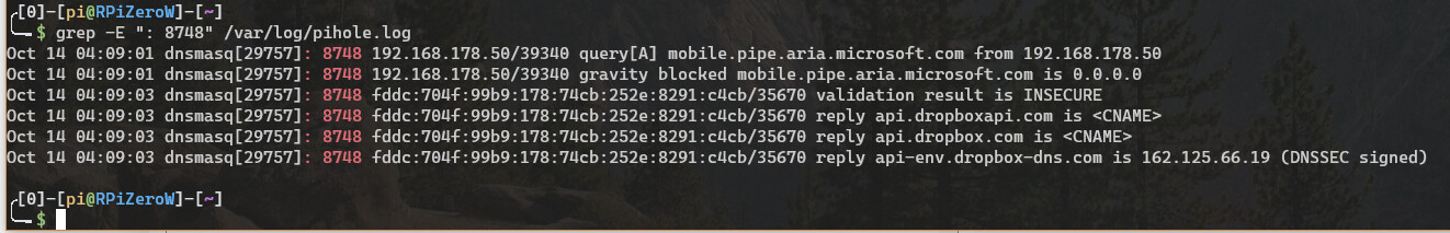

$ grep "fddc:704f:99b9:178:74cb:252e:8291:c4cb/35670" /var/log/pihole.log
Oct 14 04:08:53 dnsmasq[29757]: 8722 fddc:704f:99b9:178:74cb:252e:8291:c4cb/35670 query[A] api.dropboxapi.com from fddc:704f:99b9:178:74cb:252e:8291:c4cb
Oct 14 04:08:53 dnsmasq[29757]: 8722 fddc:704f:99b9:178:74cb:252e:8291:c4cb/35670 cached api.dropboxapi.com is <CNAME>
Oct 14 04:08:53 dnsmasq[29757]: 8722 fddc:704f:99b9:178:74cb:252e:8291:c4cb/35670 cached api.dropbox.com is <CNAME>
Oct 14 04:08:53 dnsmasq[29757]: 8722 fddc:704f:99b9:178:74cb:252e:8291:c4cb/35670 forwarded api.dropboxapi.com to 2606:4700:4700::1111
Oct 14 04:09:03 dnsmasq[29757]: 8722 fddc:704f:99b9:178:74cb:252e:8291:c4cb/35670 forwarded api.dropboxapi.com to 1.1.1.1
Oct 14 04:09:03 dnsmasq[29757]: 8722 fddc:704f:99b9:178:74cb:252e:8291:c4cb/35670 forwarded api.dropboxapi.com to 2606:4700:4700::1111
Oct 14 04:09:03 dnsmasq[29757]: 8748 fddc:704f:99b9:178:74cb:252e:8291:c4cb/35670 validation result is INSECURE
Oct 14 04:09:03 dnsmasq[29757]: 8748 fddc:704f:99b9:178:74cb:252e:8291:c4cb/35670 reply api.dropboxapi.com is <CNAME>
Oct 14 04:09:03 dnsmasq[29757]: 8748 fddc:704f:99b9:178:74cb:252e:8291:c4cb/35670 reply api.dropbox.com is <CNAME>
Oct 14 04:09:03 dnsmasq[29757]: 8748 fddc:704f:99b9:178:74cb:252e:8291:c4cb/35670 reply api-env.dropbox-dns.com is 162.125.66.19 (DNSSEC signed)
^^^ What does the extra (DNSSEC signed) on the reply line mean here, considering the validation result is INSECURE?
Something else I noticed now as well, which I guess is tangentially related to this issue:
Queries that are already forwarded or Retried get the CNAME reply type and response time of the initial cache lookup but aren't updated after that. The two AAAA queries were immediately forwarded, the second one being marked as duplicate and not further tracked. The A queries, however, were preceded by a cache lookup before being forwarded. The duplicate one was left with the initial CNAME reply type and the delay of the cache lookup. Retried queries behave the same way.
$ grep "fddc:704f:99b9:178:cc89:6582:c2d3:3b2b/36756\|fddc:704f:99b9:178:cc89:6582:c2d3:3b2b/39968\|fddc:704f:99b9:178:cc89:6582:c2d3:3b2b/44444\|fddc:704f:99b9:178:cc89:6582:c2d3:3b2b/39228" /var/log/pihole.log
Oct 14 17:54:23 dnsmasq[29757]: 25613 fddc:704f:99b9:178:cc89:6582:c2d3:3b2b/36756 query[AAAA] android.clients.google.com from fddc:704f:99b9:178:cc89:6582:c2d3:3b2b
Oct 14 17:54:23 dnsmasq[29757]: 25613 fddc:704f:99b9:178:cc89:6582:c2d3:3b2b/36756 forwarded android.clients.google.com to 1.1.1.1
Oct 14 17:54:23 dnsmasq[29757]: 25615 fddc:704f:99b9:178:cc89:6582:c2d3:3b2b/39968 query[AAAA] android.clients.google.com from fddc:704f:99b9:178:cc89:6582:c2d3:3b2b
Oct 14 17:54:23 dnsmasq[29757]: 25613 fddc:704f:99b9:178:cc89:6582:c2d3:3b2b/36756 validation result is INSECURE
Oct 14 17:54:23 dnsmasq[29757]: 25613 fddc:704f:99b9:178:cc89:6582:c2d3:3b2b/36756 reply android.clients.google.com is <CNAME>
Oct 14 17:54:23 dnsmasq[29757]: 25613 fddc:704f:99b9:178:cc89:6582:c2d3:3b2b/36756 reply android.l.google.com is NODATA-IPv6
Oct 14 17:54:23 dnsmasq[29757]: 25615 fddc:704f:99b9:178:cc89:6582:c2d3:3b2b/39968 reply query is duplicate
Oct 14 17:54:23 dnsmasq[29757]: 25616 fddc:704f:99b9:178:cc89:6582:c2d3:3b2b/44444 query[A] android.clients.google.com from fddc:704f:99b9:178:cc89:6582:c2d3:3b2b
Oct 14 17:54:23 dnsmasq[29757]: 25616 fddc:704f:99b9:178:cc89:6582:c2d3:3b2b/44444 cached android.clients.google.com is <CNAME>
Oct 14 17:54:23 dnsmasq[29757]: 25616 fddc:704f:99b9:178:cc89:6582:c2d3:3b2b/44444 forwarded android.clients.google.com to 1.1.1.1
Oct 14 17:54:23 dnsmasq[29757]: 25617 fddc:704f:99b9:178:cc89:6582:c2d3:3b2b/39228 query[A] android.clients.google.com from fddc:704f:99b9:178:cc89:6582:c2d3:3b2b
Oct 14 17:54:23 dnsmasq[29757]: 25617 fddc:704f:99b9:178:cc89:6582:c2d3:3b2b/39228 cached android.clients.google.com is <CNAME>
Oct 14 17:54:23 dnsmasq[29757]: 25616 fddc:704f:99b9:178:cc89:6582:c2d3:3b2b/44444 validation result is INSECURE
Oct 14 17:54:23 dnsmasq[29757]: 25616 fddc:704f:99b9:178:cc89:6582:c2d3:3b2b/44444 reply android.clients.google.com is <CNAME>
Oct 14 17:54:23 dnsmasq[29757]: 25616 fddc:704f:99b9:178:cc89:6582:c2d3:3b2b/44444 reply android.l.google.com is 172.217.23.110
Oct 14 17:54:23 dnsmasq[29757]: 25616 fddc:704f:99b9:178:cc89:6582:c2d3:3b2b/44444 reply android.l.google.com is 142.250.184.206
Oct 14 17:54:23 dnsmasq[29757]: 25616 fddc:704f:99b9:178:cc89:6582:c2d3:3b2b/44444 reply android.l.google.com is 216.58.212.142
Oct 14 17:54:23 dnsmasq[29757]: 25616 fddc:704f:99b9:178:cc89:6582:c2d3:3b2b/44444 reply android.l.google.com is 142.250.185.78
Oct 14 17:54:23 dnsmasq[29757]: 25616 fddc:704f:99b9:178:cc89:6582:c2d3:3b2b/44444 reply android.l.google.com is 142.250.185.110
Oct 14 17:54:23 dnsmasq[29757]: 25616 fddc:704f:99b9:178:cc89:6582:c2d3:3b2b/44444 reply android.l.google.com is 142.250.186.110
Oct 14 17:54:23 dnsmasq[29757]: 25616 fddc:704f:99b9:178:cc89:6582:c2d3:3b2b/44444 reply android.l.google.com is 142.250.186.78
Oct 14 17:54:23 dnsmasq[29757]: 25616 fddc:704f:99b9:178:cc89:6582:c2d3:3b2b/44444 reply android.l.google.com is 142.250.74.206
Oct 14 17:54:23 dnsmasq[29757]: 25616 fddc:704f:99b9:178:cc89:6582:c2d3:3b2b/44444 reply android.l.google.com is 142.250.181.238
Oct 14 17:54:23 dnsmasq[29757]: 25616 fddc:704f:99b9:178:cc89:6582:c2d3:3b2b/44444 reply android.l.google.com is 142.250.185.174
Oct 14 17:54:23 dnsmasq[29757]: 25616 fddc:704f:99b9:178:cc89:6582:c2d3:3b2b/44444 reply android.l.google.com is 142.250.185.142
Oct 14 17:54:23 dnsmasq[29757]: 25616 fddc:704f:99b9:178:cc89:6582:c2d3:3b2b/44444 reply android.l.google.com is 216.58.212.174
Oct 14 17:54:23 dnsmasq[29757]: 25616 fddc:704f:99b9:178:cc89:6582:c2d3:3b2b/44444 reply android.l.google.com is 172.217.16.142
Oct 14 17:54:23 dnsmasq[29757]: 25616 fddc:704f:99b9:178:cc89:6582:c2d3:3b2b/44444 reply android.l.google.com is 142.250.186.46
Oct 14 17:54:23 dnsmasq[29757]: 25616 fddc:704f:99b9:178:cc89:6582:c2d3:3b2b/44444 reply android.l.google.com is 142.250.185.238
Oct 14 17:54:23 dnsmasq[29757]: 25616 fddc:704f:99b9:178:cc89:6582:c2d3:3b2b/44444 reply android.l.google.com is 142.250.185.206
Oct 14 17:54:23 dnsmasq[29757]: 25617 fddc:704f:99b9:178:cc89:6582:c2d3:3b2b/39228 reply query is duplicate

This applies for the second one, too (forwarded query with ID 8722 vs. reply with ID 8748).
This is difficult to say without seeing the corresponding DNSEC queries. With the bit of information we have here, hypothesis: api-env.dropbox-dns.com is part of the CNAME and correctly signed. However, if at least one element of the CNAME is not signed the entire query should not be considered SECURE and, hence, gets marked as INSECURE.
Why they have their DNS only partially signed is something I cannot answer.
dnsmasq silently drops retries from clients. We just mark them such and loose track of them the same way because they will never actually receive a reply. The situation can be improved by always saying N/A for the reply of these domains here.
edit My hypothesis about the dropbox domain above was correct, see here:
  • dropbox.com is NOT signed (-> INSECURE)
  • dropboxapi.com is NOT signed (-> INSECURE)
  • dropbox-dns.com is signed (-> SECURE)
The overall query is INSECURE as not all elements could be validated:

Oct 14 07:03:41 dnsmasq[29757]: 11882 fddc:704f:99b9:178:a8:d461:21cd:4bb9/64522 validation aws.duplex.snapchat.com is BOGUS
Oct 14 07:03:41 dnsmasq[29757]: 11882 fddc:704f:99b9:178:a8:d461:21cd:4bb9/64522 reply error is SERVFAIL
The two cases of "I don't know what's wrong" (also "no reply received"):
grep for IDs 11885-11890
$ grep -E ": (1188[5-9]|11890)" /var/log/pihole.log
Oct 14 07:03:41 dnsmasq[29757]: 11886 fddc:704f:99b9:178:a8:d461:21cd:4bb9/54316 query[AAAA] aws.api.snapchat.com from fddc:704f:99b9:178:a8:d461:21cd:4bb9
Oct 14 07:03:41 dnsmasq[29757]: 11886 fddc:704f:99b9:178:a8:d461:21cd:4bb9/54316 forwarded aws.api.snapchat.com to 1.1.1.1
Oct 14 07:03:41 dnsmasq[29757]: 11887 fddc:704f:99b9:178:a8:d461:21cd:4bb9/63569 query[A] us-east1-aws.api.snapchat.com from fddc:704f:99b9:178:a8:d461:21cd:4bb9
Oct 14 07:03:41 dnsmasq[29757]: 11887 fddc:704f:99b9:178:a8:d461:21cd:4bb9/63569 cached us-east1-aws.api.snapchat.com is <CNAME>
Oct 14 07:03:41 dnsmasq[29757]: 11887 fddc:704f:99b9:178:a8:d461:21cd:4bb9/63569 forwarded us-east1-aws.api.snapchat.com to 1.1.1.1
Oct 14 07:03:41 dnsmasq[29757]: 11888 fddc:704f:99b9:178:a8:d461:21cd:4bb9/56745 query[AAAA] us-east1-aws.api.snapchat.com from fddc:704f:99b9:178:a8:d461:21cd:4bb9
Oct 14 07:03:41 dnsmasq[29757]: 11888 fddc:704f:99b9:178:a8:d461:21cd:4bb9/56745 forwarded us-east1-aws.api.snapchat.com to 1.1.1.1
Oct 14 07:03:41 dnsmasq[29757]: 11889 fddc:704f:99b9:178:a8:d461:21cd:4bb9/50558 query[A] gcp.api.snapchat.com from fddc:704f:99b9:178:a8:d461:21cd:4bb9
Oct 14 07:03:41 dnsmasq[29757]: 11889 fddc:704f:99b9:178:a8:d461:21cd:4bb9/50558 cached gcp.api.snapchat.com is <CNAME>
Oct 14 07:03:41 dnsmasq[29757]: 11889 fddc:704f:99b9:178:a8:d461:21cd:4bb9/50558 cached gcp.api.sc-gw.com is 35.190.43.134
Oct 14 07:03:41 dnsmasq[29757]: 11890 fddc:704f:99b9:178:a8:d461:21cd:4bb9/63236 query[AAAA] gcp.api.snapchat.com from fddc:704f:99b9:178:a8:d461:21cd:4bb9
Oct 14 07:03:41 dnsmasq[29757]: 11890 fddc:704f:99b9:178:a8:d461:21cd:4bb9/63236 cached gcp.api.snapchat.com is <CNAME>
Oct 14 07:03:41 dnsmasq[29757]: 11890 fddc:704f:99b9:178:a8:d461:21cd:4bb9/63236 cached gcp.api.sc-gw.com is NODATA-IPv6
Oct 14 07:03:41 dnsmasq[29757]: 11886 fddc:704f:99b9:178:a8:d461:21cd:4bb9/54316 forwarded aws.api.snapchat.com to 2606:4700:4700::1111
Oct 14 07:03:41 dnsmasq[29757]: 11887 fddc:704f:99b9:178:a8:d461:21cd:4bb9/63569 validation result is INSECURE
Oct 14 07:03:41 dnsmasq[29757]: 11887 fddc:704f:99b9:178:a8:d461:21cd:4bb9/63569 reply us-east1-aws.api.snapchat.com is <CNAME>
Oct 14 07:03:41 dnsmasq[29757]: 11887 fddc:704f:99b9:178:a8:d461:21cd:4bb9/63569 reply us-east1-aws.api.sc-gw.com is 100.26.12.76
Oct 14 07:03:41 dnsmasq[29757]: 11890 fddc:704f:99b9:178:a8:d461:21cd:4bb9/54316 validation aws.api.snapchat.com is BOGUS
Oct 14 07:03:41 dnsmasq[29757]: 11890 fddc:704f:99b9:178:a8:d461:21cd:4bb9/54316 reply error is SERVFAIL
Oct 14 07:03:49 dnsmasq[29757]: 11888 fddc:704f:99b9:178:a8:d461:21cd:4bb9/56745 forwarded us-east1-aws.api.snapchat.com to 1.1.1.1
Oct 14 07:03:49 dnsmasq[29757]: 11888 fddc:704f:99b9:178:a8:d461:21cd:4bb9/56745 forwarded us-east1-aws.api.snapchat.com to 2606:4700:4700::1111
grep for ID 8722
$ grep -E ": 8722" /var/log/pihole.log
No, it isn't. Because we might be doing additional DNSSEC-related queries when we have to walk the DNS path from the root servers down to the actual domain. They are independent and, hence, get their own IDs. They are likely the next IDs after this one. This is expected and correct.
What does not look okay is that an ID seems to be re-used here. Two times the same ID for different queries is fishy but seen in your screenshot. Could you send me the entirety of the log file via PM (or here if you don't mind) starting from the first line in your screenshot to the last line so I can examine what might be broken here?
Maybe something is broken, see above.
Is this expected? That you do not receive a reply from upstream? I haven't seen any no reply case in the logs I still have on my own Pi-hole.
I don't think they are related (-> ID issue).

 19898 Oct 14 04:09:01 dnsmasq[29757]: 8748 192.168.178.50/39340 query[A] mobile.pipe.aria.microsoft.com from 192.168.178.50
 19899 Oct 14 04:09:01 dnsmasq[29757]: 8748 192.168.178.50/39340 gravity blocked mobile.pipe.aria.microsoft.com is 0.0.0.0
 19900 Oct 14 04:09:03 dnsmasq[29757]: 8722 fddc:704f:99b9:178:74cb:252e:8291:c4cb/35670 forwarded api.dropboxapi.com to 1.1.1.1
 19901 Oct 14 04:09:03 dnsmasq[29757]: 8722 fddc:704f:99b9:178:74cb:252e:8291:c4cb/35670 forwarded api.dropboxapi.com to 2606:4700:4700::1111
 19902 Oct 14 04:09:03 dnsmasq[29757]: 8748 fddc:704f:99b9:178:74cb:252e:8291:c4cb/35670 validation result is INSECURE
 19903 Oct 14 04:09:03 dnsmasq[29757]: 8748 fddc:704f:99b9:178:74cb:252e:8291:c4cb/35670 reply api.dropboxapi.com is <CNAME>
 19904 Oct 14 04:09:03 dnsmasq[29757]: 8748 fddc:704f:99b9:178:74cb:252e:8291:c4cb/35670 reply api.dropbox.com is <CNAME>
 19905 Oct 14 04:09:03 dnsmasq[29757]: 8748 fddc:704f:99b9:178:74cb:252e:8291:c4cb/35670 reply api-env.dropbox-dns.com is 162.125.66.19 (DNSSEC signed)
 31049 Oct 14 07:03:41 dnsmasq[29757]: 11877 fddc:704f:99b9:178:a8:d461:21cd:4bb9/64649 query[A] aws.duplex.snapchat.com from fddc:704f:99b9:178:a8:d461:21cd:4bb9
 31050 Oct 14 07:03:41 dnsmasq[29757]: 11877 fddc:704f:99b9:178:a8:d461:21cd:4bb9/64649 cached aws.duplex.snapchat.com is <CNAME>

Sample output for my first log that I linked above
Problematic Client: fddc:704f:99b9:178:a8:d461:21cd:4bb9/64649
Relevant ID: 11877
Relevant ID: 11882
Oct 14 07:03:41 dnsmasq[29757]: 11882 fddc:704f:99b9:178:a8:d461:21cd:4bb9/58989 query[AAAA] us-east4-gcp.api.snapchat.com from fddc:704f:99b9:178:a8:d461:21cd:4bb9
Oct 14 07:03:41 dnsmasq[29757]: 11882 fddc:704f:99b9:178:a8:d461:21cd:4bb9/58989 cached us-east4-gcp.api.snapchat.com is <CNAME>
Oct 14 07:03:41 dnsmasq[29757]: 11882 fddc:704f:99b9:178:a8:d461:21cd:4bb9/58989 cached us-east4-gcp.api.sc-gw.com is NODATA-IPv6
