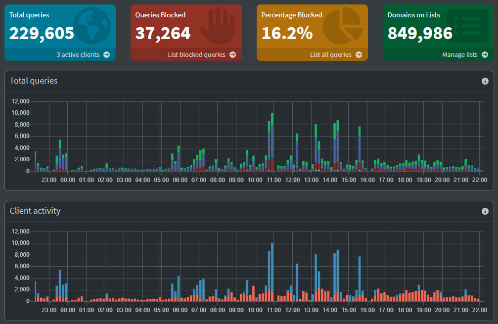

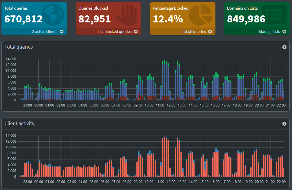

I have two pihole servers at work, and for some reason I get this on the primary server
and this on the secondary server
There should not be any gaps in requests. Our business is a 24/7 business, so there will be requests over a 24-hour period.

I don't see any gaps in your graphs?
All time slots do show client activity on at least one of your Pi-holes.
If there really were time slots without any client activity, then that could indicate that your Pi-holes are being by-passed.

The reason I say gaps is because I'd expect a continuous flow of requests, and no dips.
You can see that the second pihole spikes kind off (but not quite) correspond to the first pihole's dips.
and this is a combined image
So even if all client devices switched to the second DNS (DC02) periodically, I'd expect the second graph to fill the gaps but this is not the case if you look at the combined graph.
Yes the requests are still made, but why so little when compared to other times, like every 80 minutes or so, it's regular.
