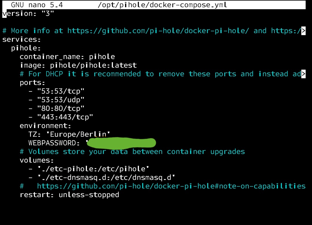

Please share your docker-compose or docker run script.
and
docker run --dns 8.8.8.8 --dns 127.0.0.1 pihole/pihole:latest
After second command there are two docker running.
Then start fixing your installation by removing both Pi-hole containers.
Right now, each of your start-up methods is incomplete.
You should consolidate your variables and decide on a single method to start your Pi-hole container, either via docker-compose or via docker run.
Also, you have not applied the FTLCONF_LOCAL_IPV4 environment variable to your container, as confirmed by both your screenshot as well as the debug log.
