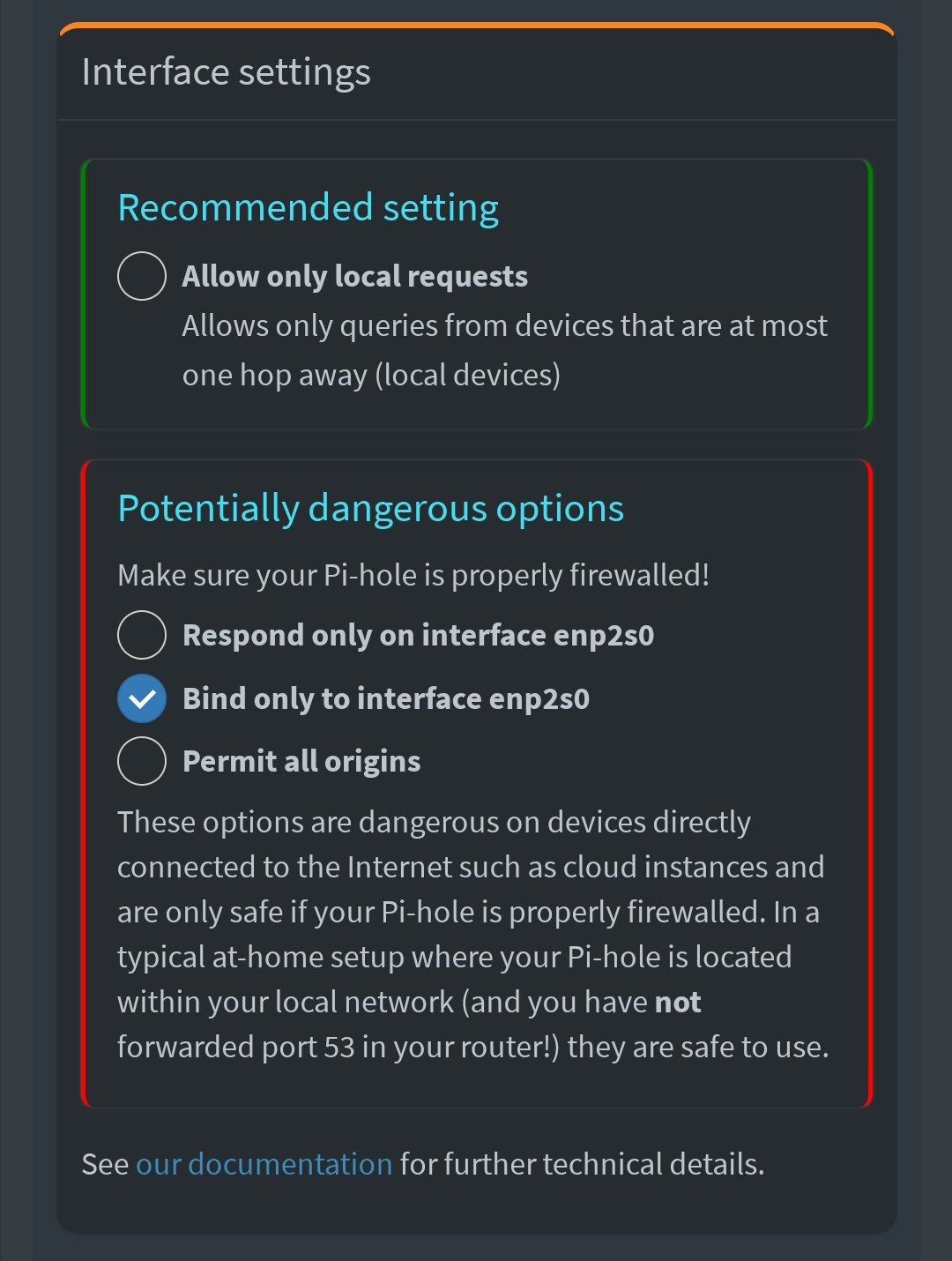

Try this setting on the dashboard in the DNS tab (it should show eth0 for you):
Sorry,
But it is already configured that way now. And is ignored.
