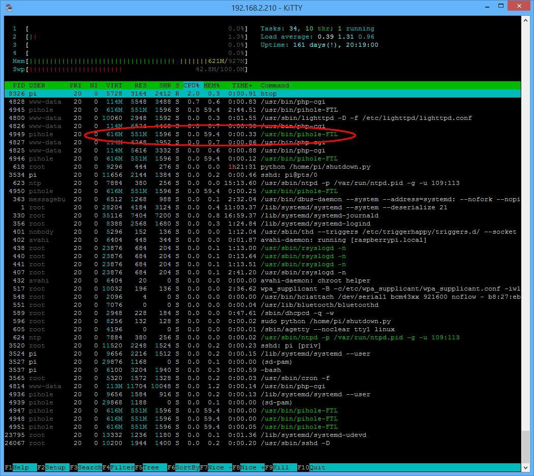

Today I have updated my PiHole from 4.11 to 4.22 (latest version). No problems with updating.
Because I knew the memory problem because I have done a lot of experiments with another PiHole (see below), I have taken print screens before and after update for showing the diffrence.

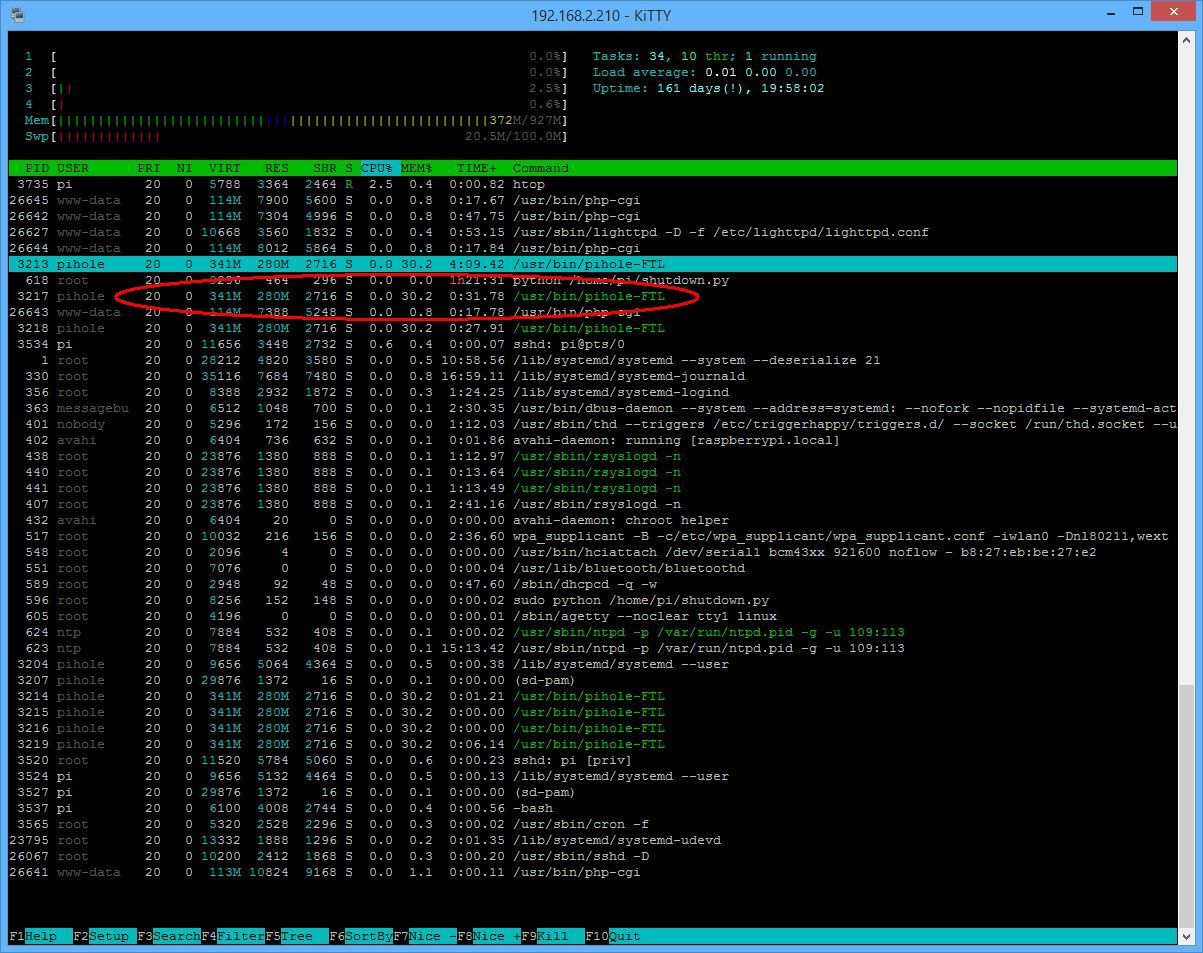

The FTL proces uses 341 MB in version 4.11, now it’s 616 MB. Nearley 2 times more. Nothing is changed in configuration just before and after the update. This PiHole is running on a RaspberryPi3 with Raspbian Stretch Lite and all updates. The Pi is operational without further problems.

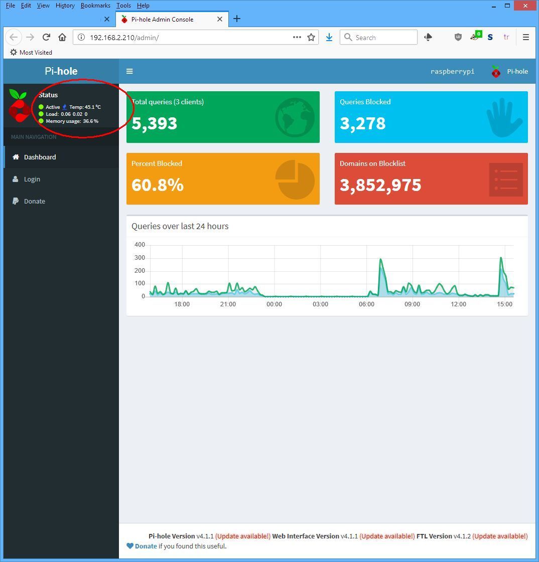

Screen pictures before updating:

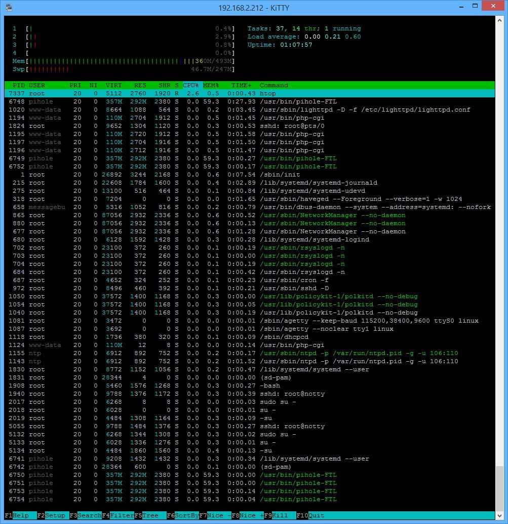

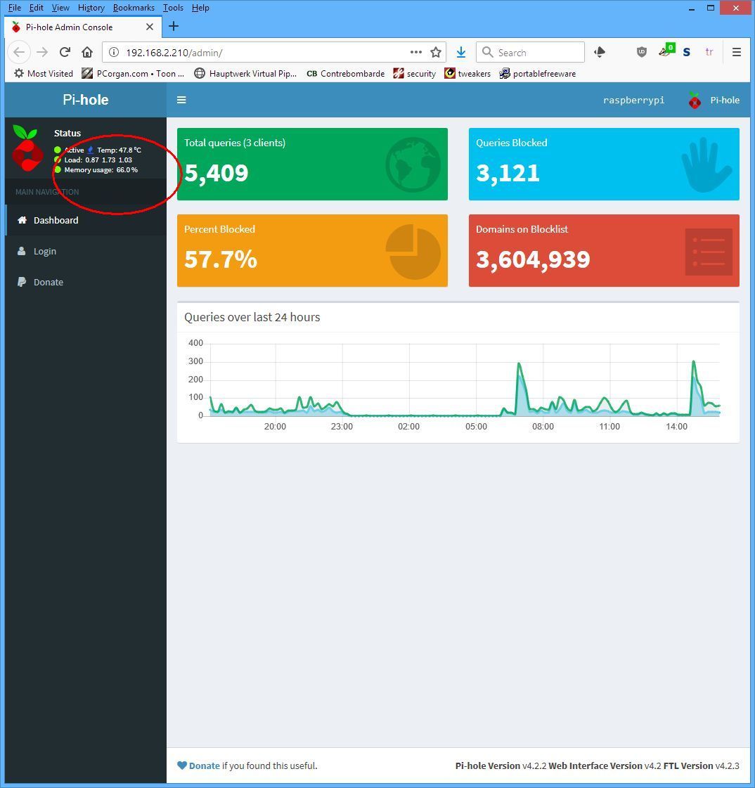

The pictures after updating:
My family has a PiOne, running PiHole 4.11 on a actual Armbian (Stretch lite).
At my home I also have a PiOne for experiments. I take the image of the PiOne of my family and restore it on my own PiOne. The only difference is that I have to disable DHCP on my PiOne afterwards. After updating my PiOne to v4.22, the same memory issue. Before update FTL uses 371 MB. Because the PiOne has 500 MB RAM on board, I have to reduce the blocklist from 3.6 Million to 2 M. to get it running. Now FTL uses 357 MB (total memory usage, displayed in admin webpage = 79.6%, was in V4.11 75,7% ). Because it’s not in use, no network traffic uses this PiHole (no queries only them from PiOne himselve).
I don’t have IPv6.
More that a year ago I have choosen for blockingmode = IP, because in that case each domain is stored in memory only once to reduce memory usage. Is this changed in V4.22, so stored 2 times? Why, because only blocked domains are enough; blocking mode can applied realtime from the config file. Or is it a bug that in case of RESOLVE_IPV6 .AND. BLOCKINGMODE=IP still stores IPv4 and Ipv6 addresses in memory for each domain?
Otherwise: what is going wrong with FTL and their memory usage in V4.22?

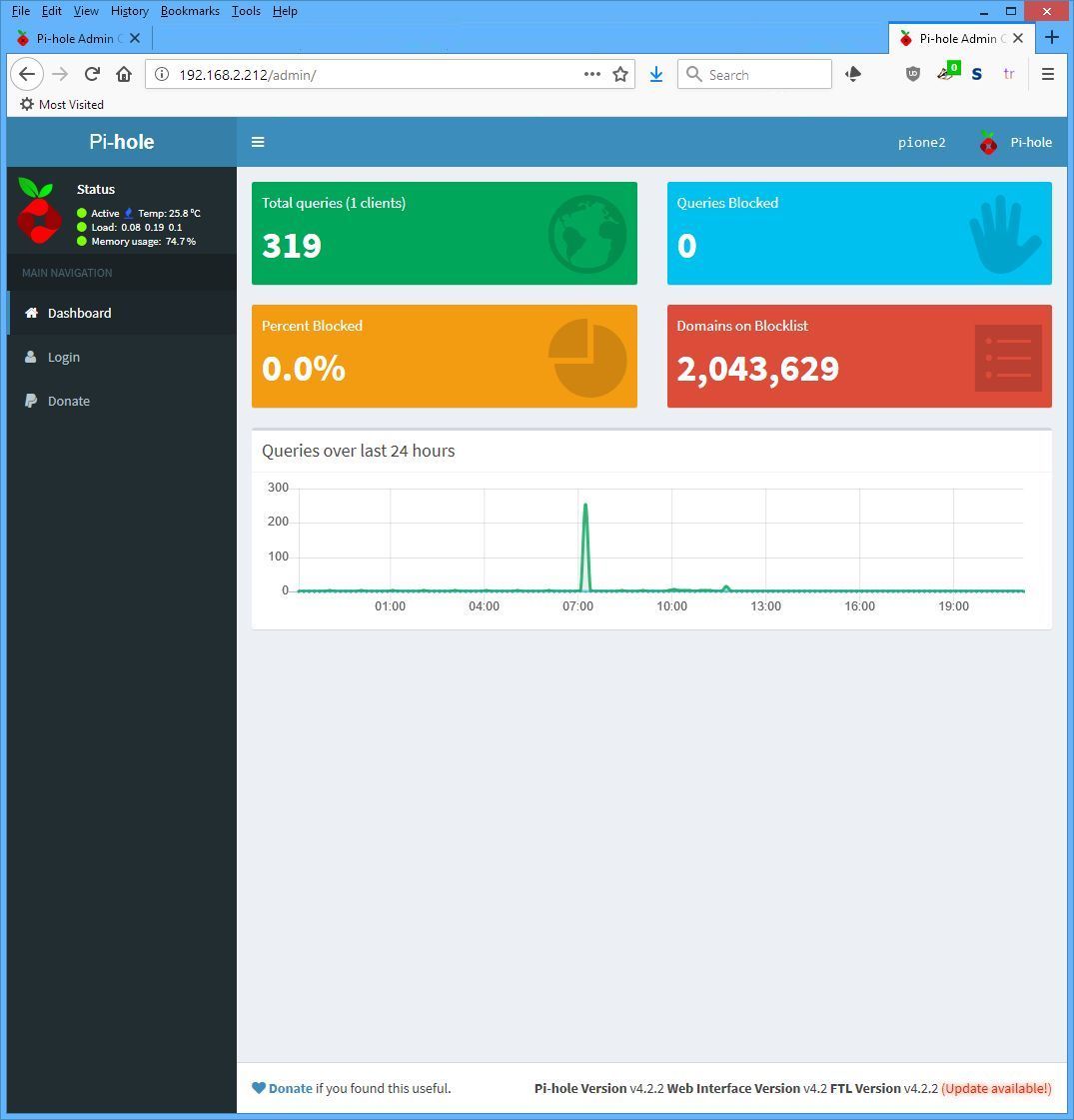

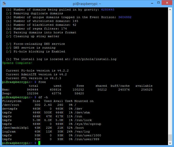

Used memory: 63.80 MB 680k domians in list
Install update 4.2.3 for FTL and see if it is fixed now.

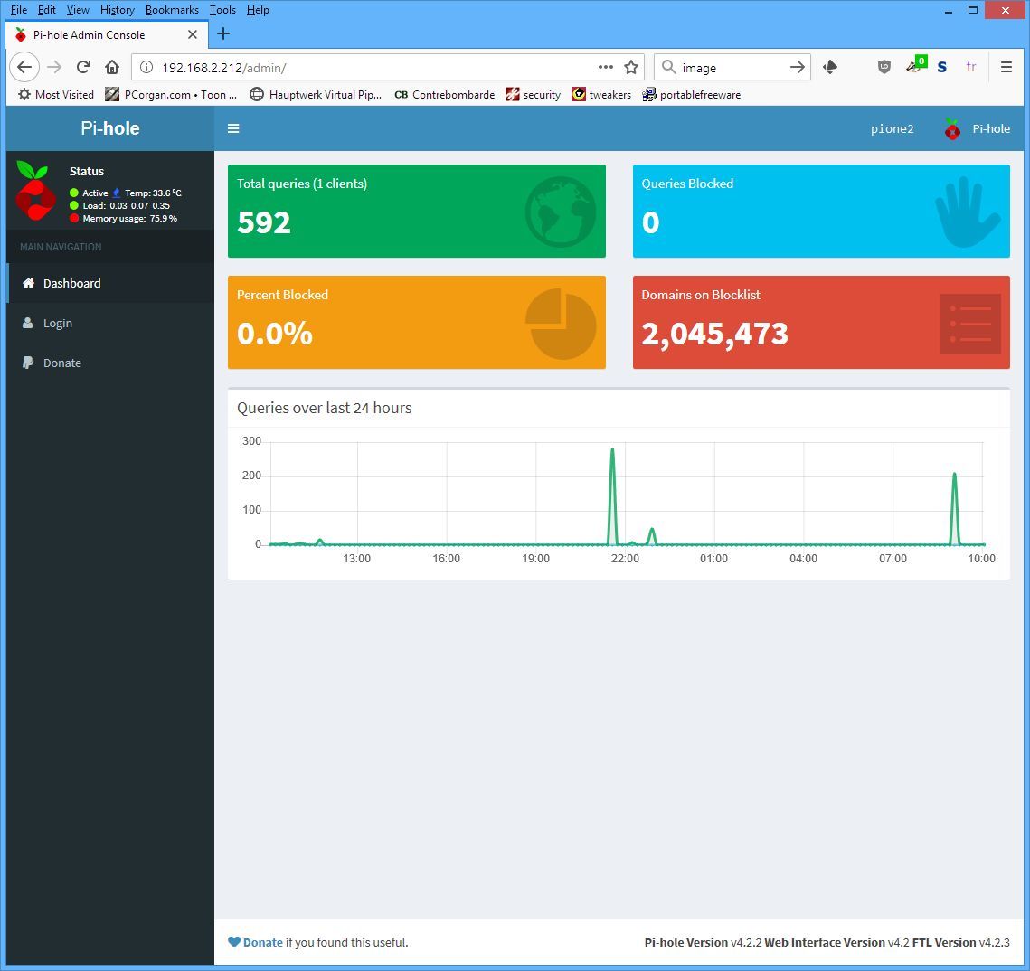

In the test above I already have installed FTL 4.23 on my PI3 during the update from 4.11. I thought that 4.22 was the actual version but in the meantime it's 4.23. I have changed the topic title.
As mentioned above I also have a PiOne for tests and experiments. That one has FTL 4.22. So I have made some print screens, do the update and take new print screens.
There is no difference in memory usage (a little higher because about 1800 domains more on block list).
So FTL 423 is no solution.

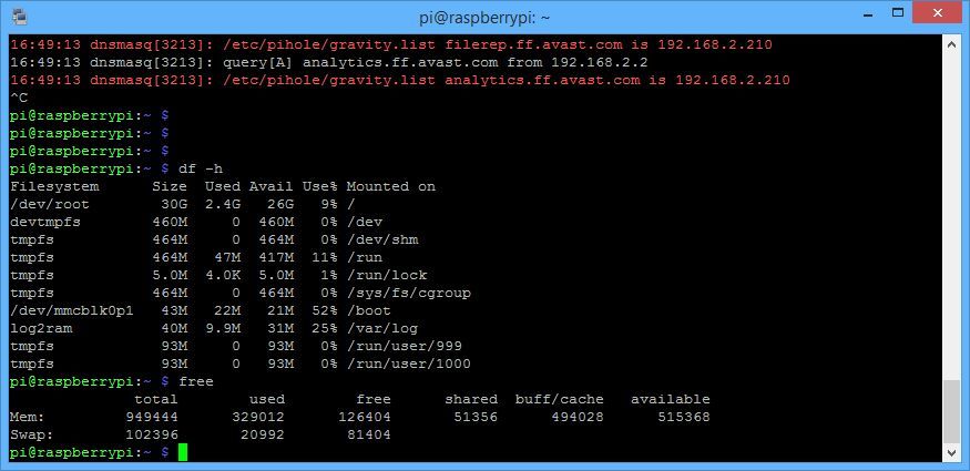

Before updating:
After the update

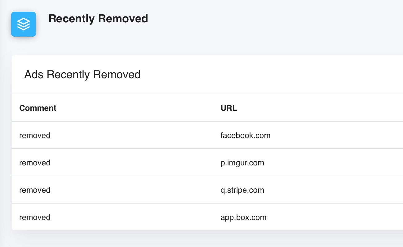

went / moved to https://blocklist.site/app
But the lists appear to be as dodgy as before. Two screen shots of domains added to their lists in error, and then removed. This has been a recurring problem with that group of lists.
