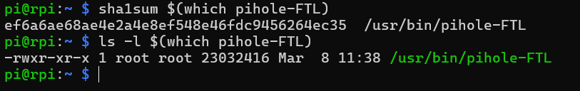

Could you run this locally, to see what the output is?
sha1sum $(which pihole-FTL)
ls -l $(which pihole-FTL)
Thanks once again for looking into this. Below is the output for both the commands:
pi@rpi:~ $ sha1sum $(which pihole-FTL)
ef6a6ae68ae4e2a4e8ef548e46fdc9456264ec35  /usr/bin/pihole-FTL
pi@rpi:~ $ ls -l $(which pihole-FTL)
-rwxr-xr-x 1 root root 23032416 Mar  8 11:38 /usr/bin/pihole-FTL
Checksum is indeed different from the one on the server. My only guess is that the installer is not fetching/installing from the server during update.

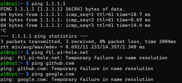

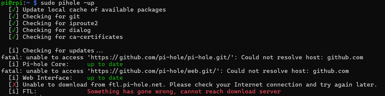

BUT..... there is a bigger problem that I'm facing now. Today the update failed completely as pihole failed to connect to the pihole server.
On digging a bit deeper I found out that my rpi has stopped resolving DNS completely inside the local raspbian instance.
All devices on my network are able to resolve the DNS properly through pihole and the same can be seen on the pihole admin dashboard.
I haven't touched my rpi at all except updating the pihole daily. I'm not sure if this is even related to pihole installation or not. Do I need to freshly install raspbian/pihole? Forgive me but my linux/shell knowledge is quite limited.
Great news! Because of the above issue I googled, and someone somewhere mentioned to just save and update DNS settings on the router. When I did so, it actually resolved the DNS issue on the rpi. Frankly, I'm not sure if that is a raspbian bug or something.

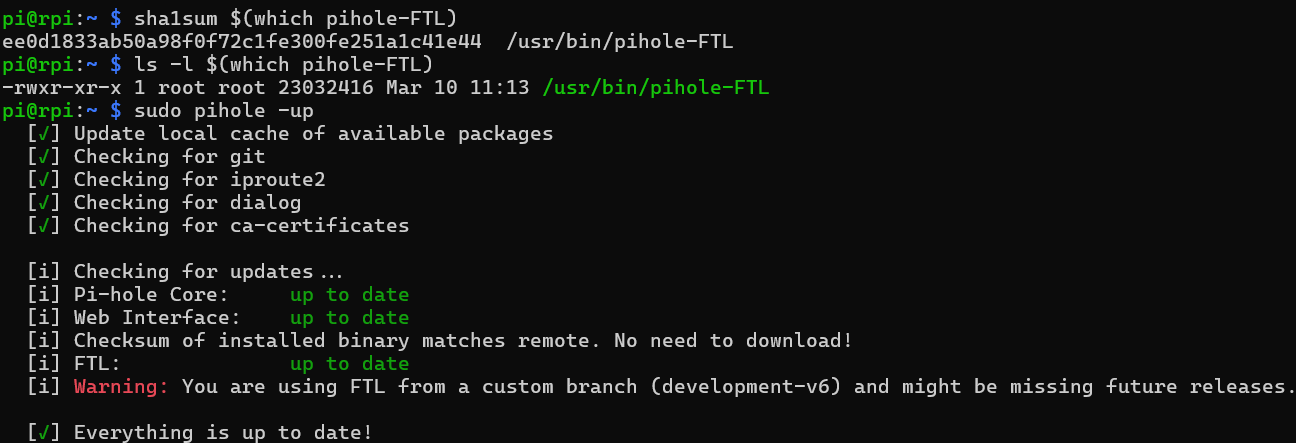

The important thing is that, it resolved the checksum issue and now it finally matches with the server. Quite some learning and revelations for me in this whole saga.
Thanks everyone for looking into this issue!
Thanks for coming back to us and glad it is resolved! So far, I'm not quite sure what the issue was looking at the code, I could imagine that failing to download the checksum may have caused this. I propose the following change that will - at the very least - be clear about that the checksum failed to download:
