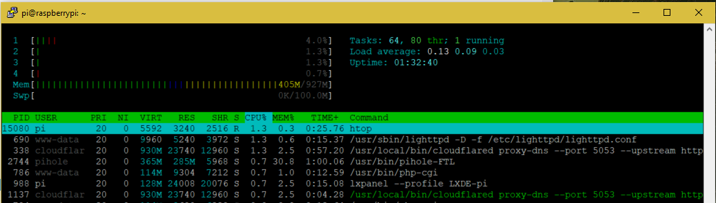

htop
I've not looked at it before. How much memory should be free?
As long as you have free memory, you aren't having a problem. You have about half your memory available, so I don't think memory is the problem here.
