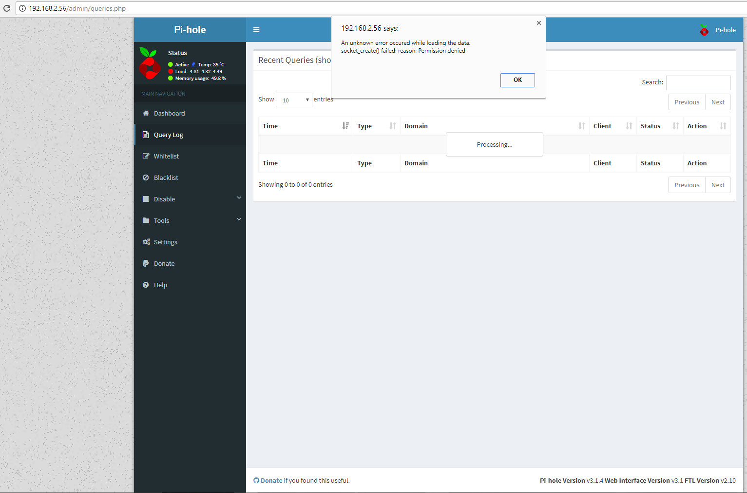

socket_create(): failed: reason: (Permission Denied)

It seems that the issue is that PHP is unable to create the socket to communicate with FTL. I'm not sure why that is happening, but it is most likely related to it being run in a container. You may have more luck running the Docker container: https://hub.docker.com/r/diginc/pi-hole/
